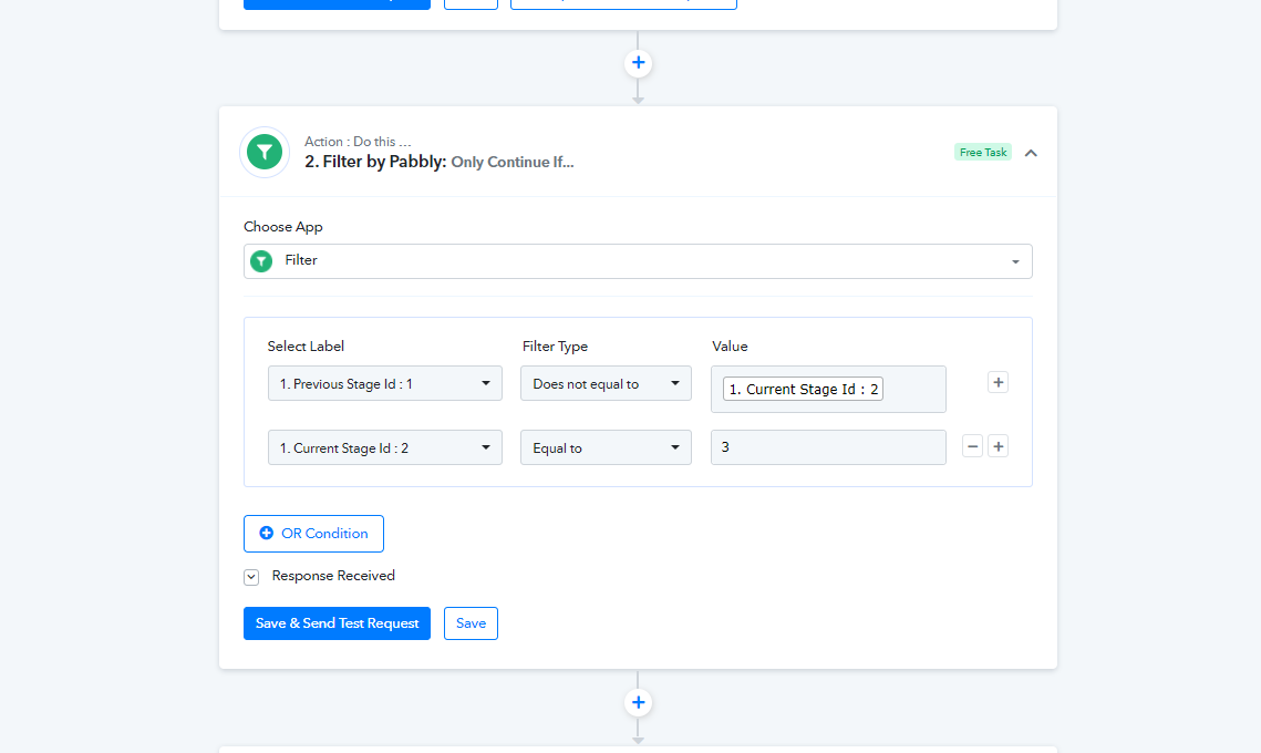

Good evening. I'm currently using an integration between Pipedrive and Chat API (automatically sending a Whatsapp message after a specific trigger on Pipedrive i.e. Create New Deal). My goal is to send a specific message once I move a deal to a specific stage on my Pipeline. However, the closest trigger I can find to that is the "Update Deal" trigger. The problem is that such trigger will send a message everytime I update a deal, not only when I move that deal to my specific stage on the pipeline. Is there a way to further narrow down that trigger? What I'm looking for here is a trigger such as "Move a deal to stage 3 in your pipeline".

Hey @Basico Bem Feito
We looked over your concern and the workflow. So we have added a filter module on the basis of stage id. such that when the filter gets the stage id of 3 it will run and also when the previous stage id is not equal to 2,1.
Please try again with the changes and let us know how it works.

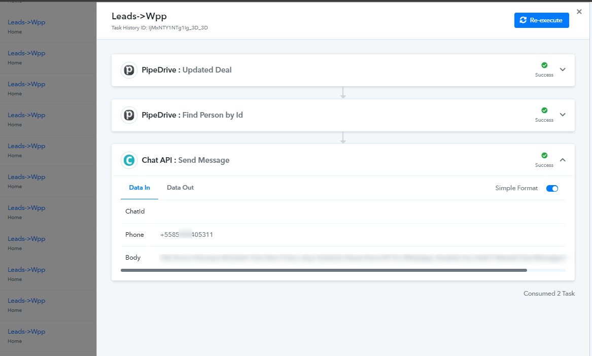

Basico Bem Feito — Reply ·
This is a great ideia! The logic works perfect, I've done a few tests. However, instead of sending 1 message I've seen it sending 5, 6 or even 10 repeated messages at once. Do you think this might be an isse with Chat API itself? Also, I've had to do a few tests to find out which Pipeline stage ID was linked to each stage (it wasn't a logical order of 1 -> 2 -> 3... ), but that's not much of a problem. The only remaining issue is with the multiple messages being sent.
I'm not sure I understand. Did I accidentally set the API to send multiple messages? Right now it is sending a total of 6 repeated messages every time I update a deal to my specific stage. I've tested this for freshly created leads and old ones. Is there a way to check what's wrong?

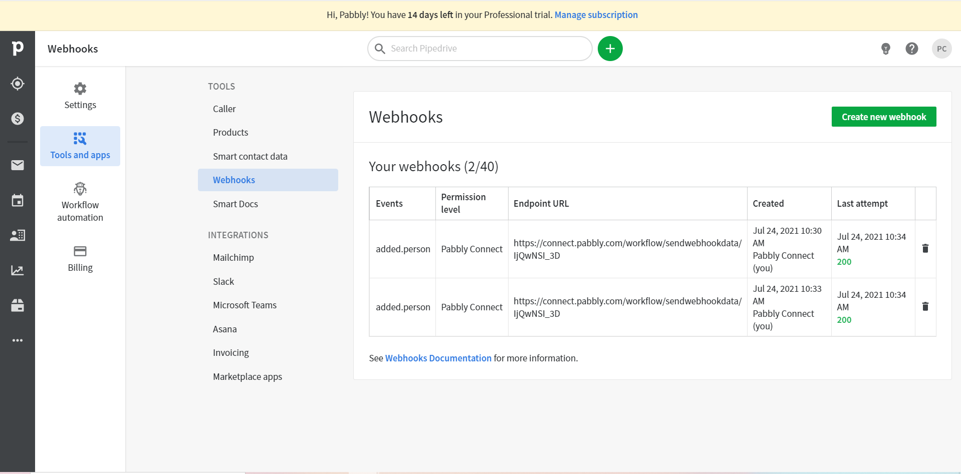

We looked over your concern and it looks like there is 6 webhook that have been set after too many Re-Capturing the webhook in your Pipedrive account.
So please remove the unwanted webhook from your Pipedrive account.
Wonderful! It appears I tested multiple webhooks and didn't actually delete them. I've now deleted them all and have sent one again. It's working fine!
