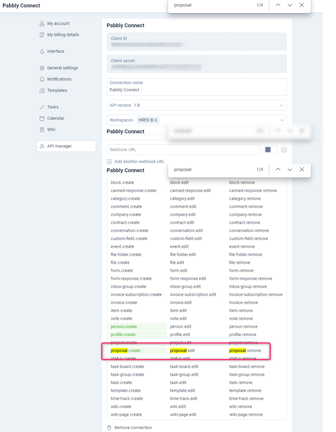

Is anyone else having problems with Plutio triggers? I keep getting Waiting for Webhook Response... while building out the workflow but nothing happens. I signed a proposal and completed a form to trigger the notification but nothing happens.

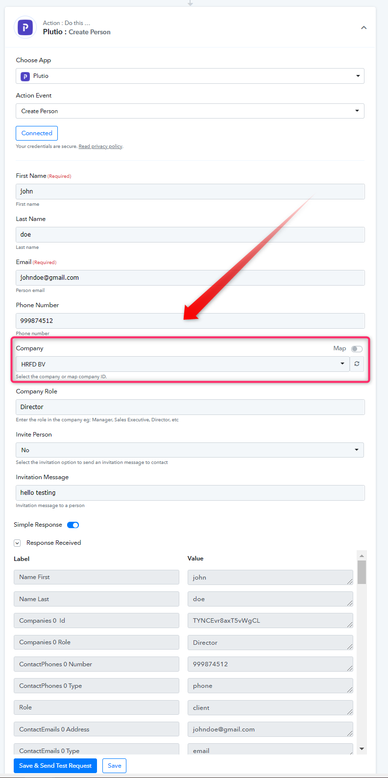

Also, can Plutio be a better integration? We are missing a lot of features, update a proposal, create a proposal etc. Create a customer with a company doesn't work it give an error.

While capturing the webhook you have to make sure that on the Plutio's App manager have you marked the required connection on the application side or if it is available or not.
As we can see Plutio doesn't provide a connection to signing the proposal.
Moreover, we certainly do have a "Create a Proposal" Action Event, and also if you have any specific integration request you can request the integration here - https://pabbly.hellonext.co/.

I dont use that specific part of Plutio but probably the "Proposal edit" webhook will have a part what will give the status if it's signed or not.

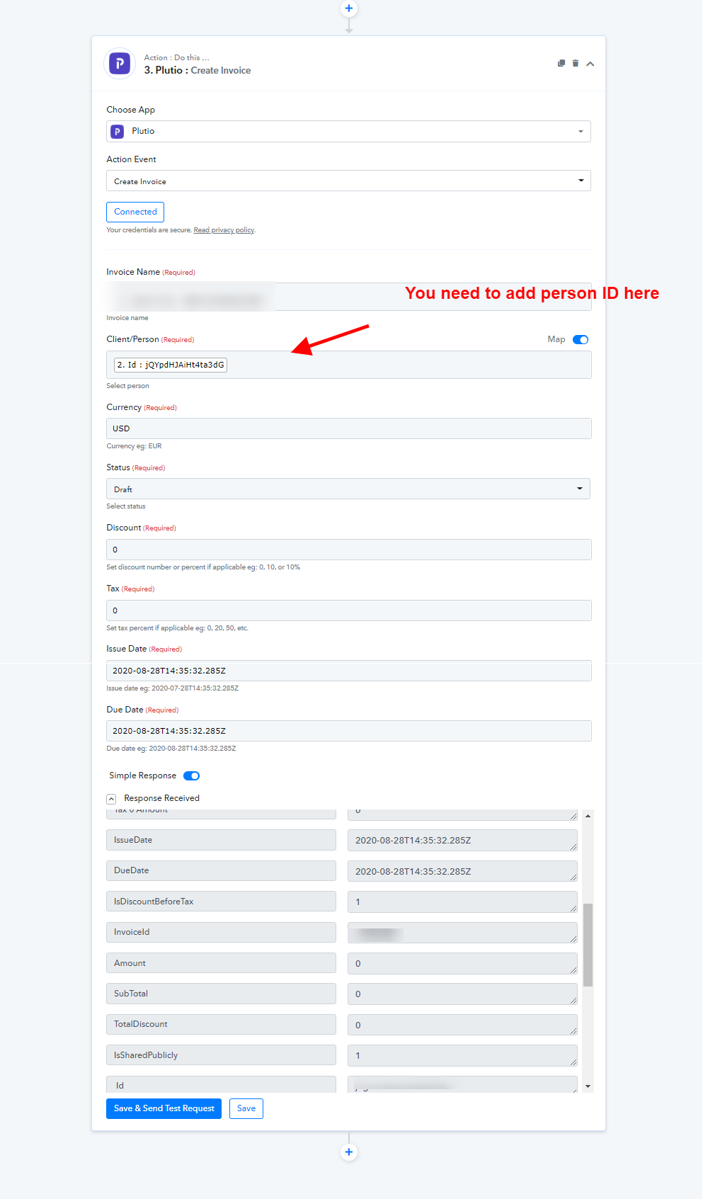

Also generating an invoice is not working with pabbly and plutio. This would be great if it could be fixed.
You need to add person ID as shown below -
We have updated your workflow and it's working fine. Please check at your end.
