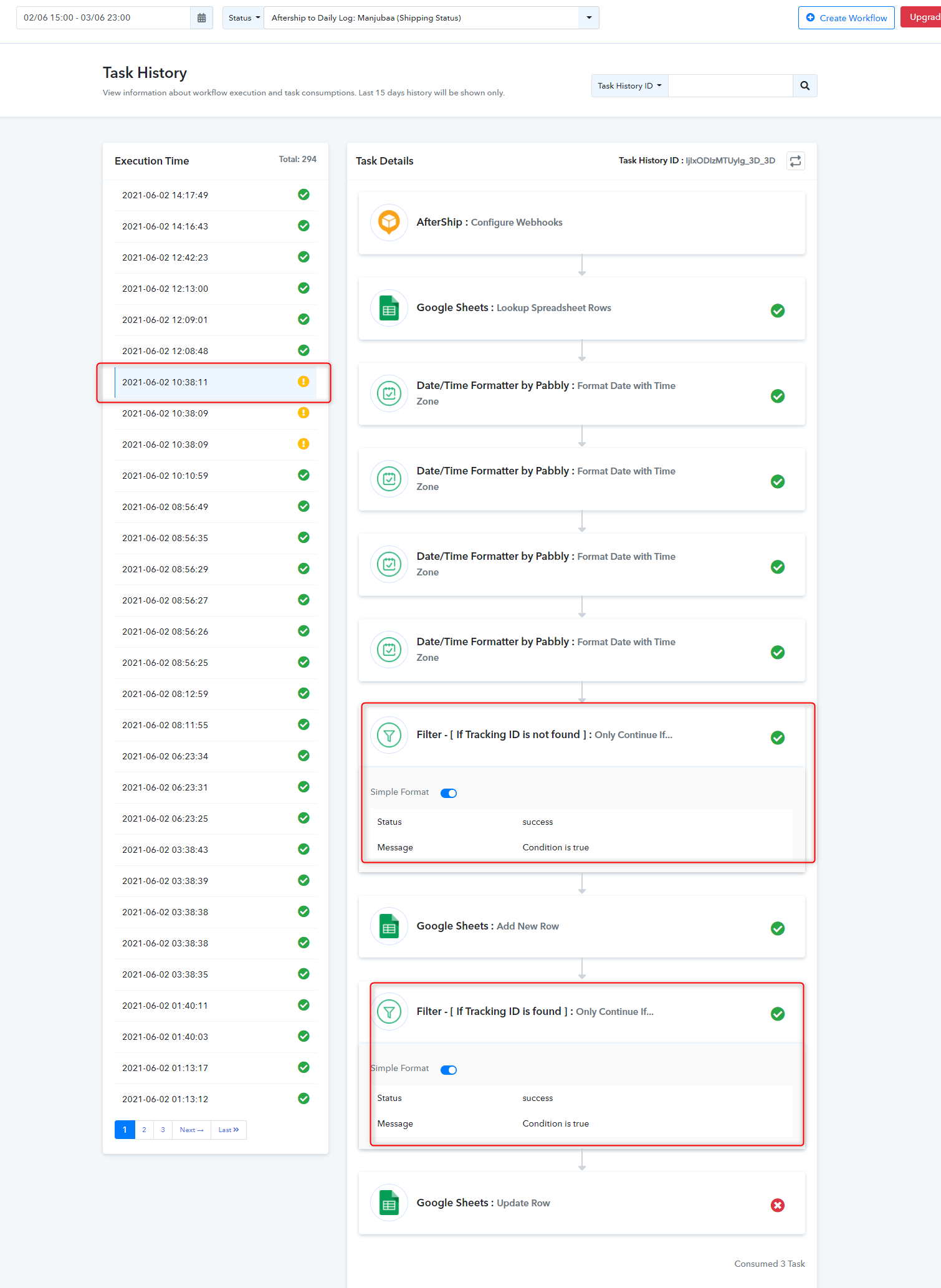

We checked your workflow and your history logs. And found that the condition which you have mentioned in the Router step is wrong.
Maybe that's why it is skipping or duplicating the entries in your Google Sheets. As a solution pick the appropriate condition in the steps.

Hey @GauravBR
Here both the conditions are different, that's why it seems like I am duplicating respond. It should either complete first step or second - which seems to be working fine if you check Google Sheet Add New Row Action and Update Row action in your screenshot.

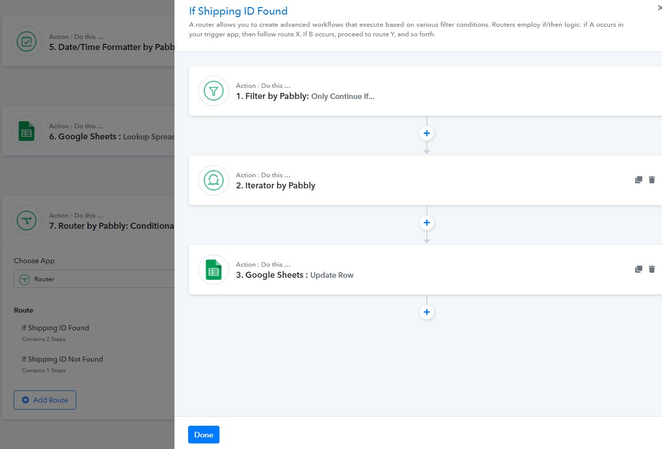

We have checked your given history logs in your workflow and found the mistake in the position of the iterator step in the workflow because of that the "Index value" in the Google Sheets "Update Row" is getting distorted. Due to the position of the iterator, the router was also getting missed.
So as a solution we have placed the iterator inside the router before the "Update Row" Action event. I hope this might help you.
Please try the workflow at your end and let us know if the problem persists.[/JUSTIFY]

I have to use iterator prior to check condition as condition is to find relevant data first.
Here's my flow id: Ijc2ODcwIg_3D_3D
What I am doing as, When a response comes in for shipping status - I use simple response and use four data/time formatter to modify date for Shipping Generated Date, Origin Received Date, Expected Delivery Date and Last Updated Time. and then search Google sheet for tracking ID.
1. If Found - It will update Status / Last Update Date & Expected Delivery Date
2. If Not Found - It will add a new raw with all the details.
This way, I update and add shipping status. I am not sure which iterator you suggested me to move into Router. Can you please guide me in detail about how to achieve?

And the condition which you are using in the Router module is the response coming from the Google Sheets Lookup endpoint, which is prior to the Router and seems fine.
