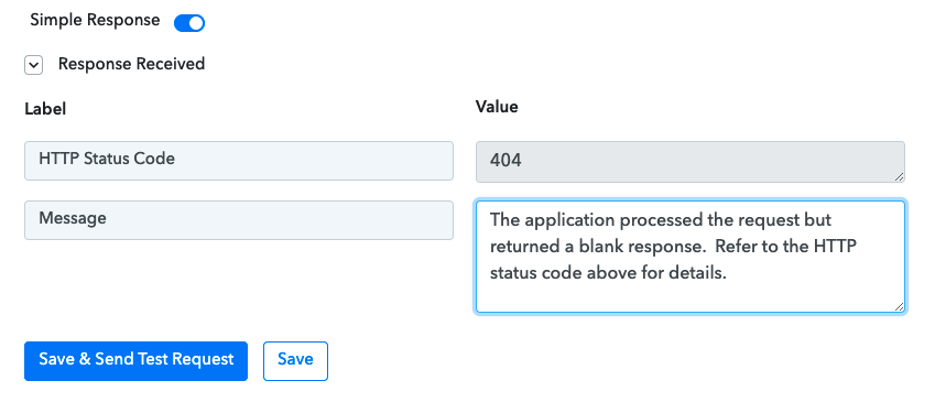

I have a workflow where I am using prefinary integration. One to update a user and another to trigger a reward. Both are not working since yesterday.
Update user code is returning 404 error. Note that it worked well during the last week. Tested for other functions as well like Trigger Reward but it did not succeed.

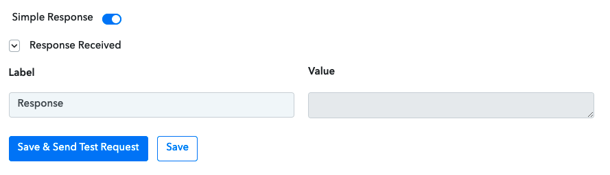

Trigger Reward Task is returning Blank
It should ideally return success or failure.

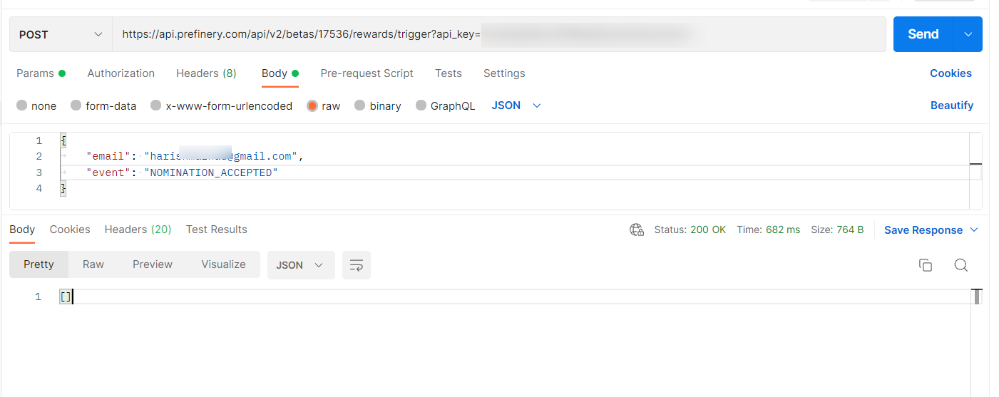

Hey @hmba2
We have checked the same at our end in the PostMan application and it seems like the issue is from their API.
So, kindly contact their support team for the same issue.

Hey @hmba2 !
That's correct, as you can see in the above image when checking on the Postman site, we got the response as blank.
This means the response is coming blank from the application's end itself i.e from Prefinary's end.
So, kindly contact their support team for the same issue, and let us know what they let you know on this.

Hi @hmba2 !
As mentioned in Prefinery's API documentation for the Rewards#trigger endpoint, the response will be an array of triggered rewards. Specifically, "This API endpoint allows you to let us know that a person has completed an action. If having performed that action causes any rewards to be earned by any users, then those rewards will be created and the list will be returned here."
In this case, you have a correctly formed API request (which is why no error is returned); however, there are no rewards to be earned for the email address and event combination that you are sending. Therefore, an empty array is returned with a HTTP 200 (success).
I see that you have written into our support, so I will continue the conversation over there in order to discuss how our rewards system works and address any concerns about why no rewards are triggered for your scenario.
