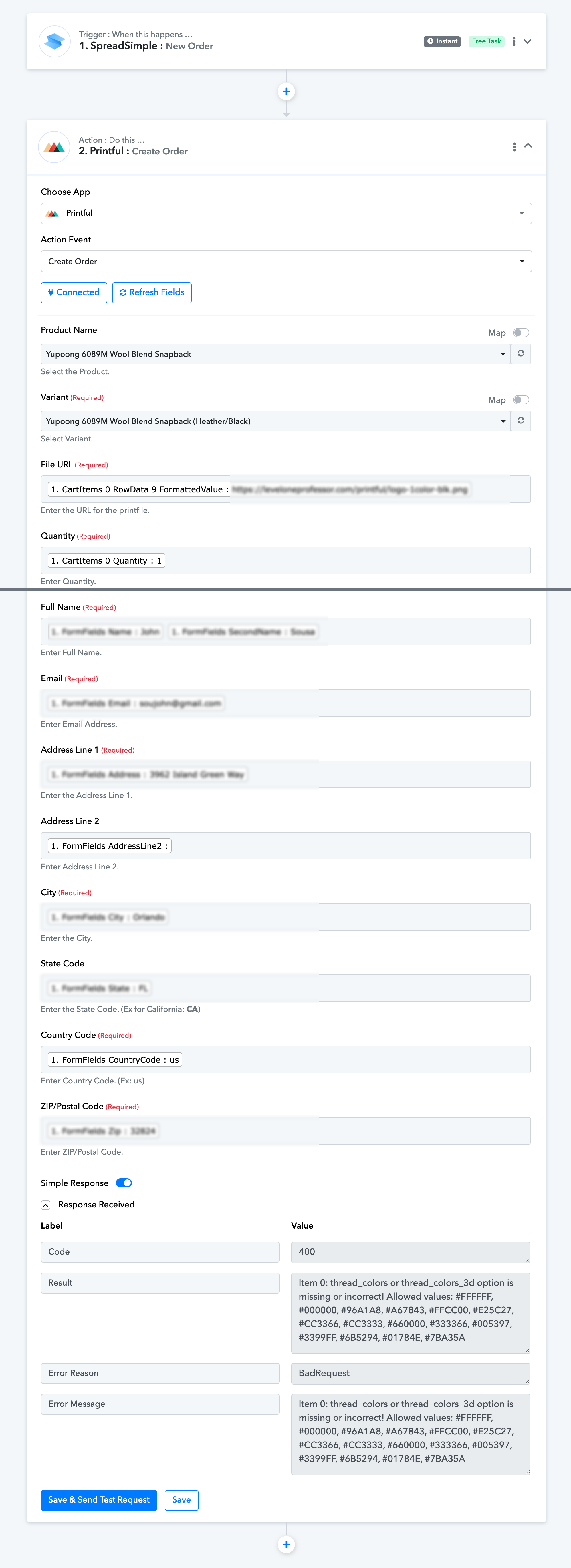

I have created a workflow that will take an order from SpreadSimple and create an order in Printful. I managed to create all the contact form details and products details that are required in the Printful integration. However, after sending a test request I receive a 400 error that says:
Item 0: thread_colors or thread_colors_3d option is missing or incorrect! Allowed values: #FFFFFF, #000000, #96A1A8, #A67843, #FFCC00, #E25C27, #CC3366, #CC3333, #660000, #333366, #005397, #3399FF, #6B5294, #01784E, #7BA35A
I don't say a field in the Printful section that allows me to enter a value for thread colors. What can I do to enter the missing information and create the order?
Thank you
John S.

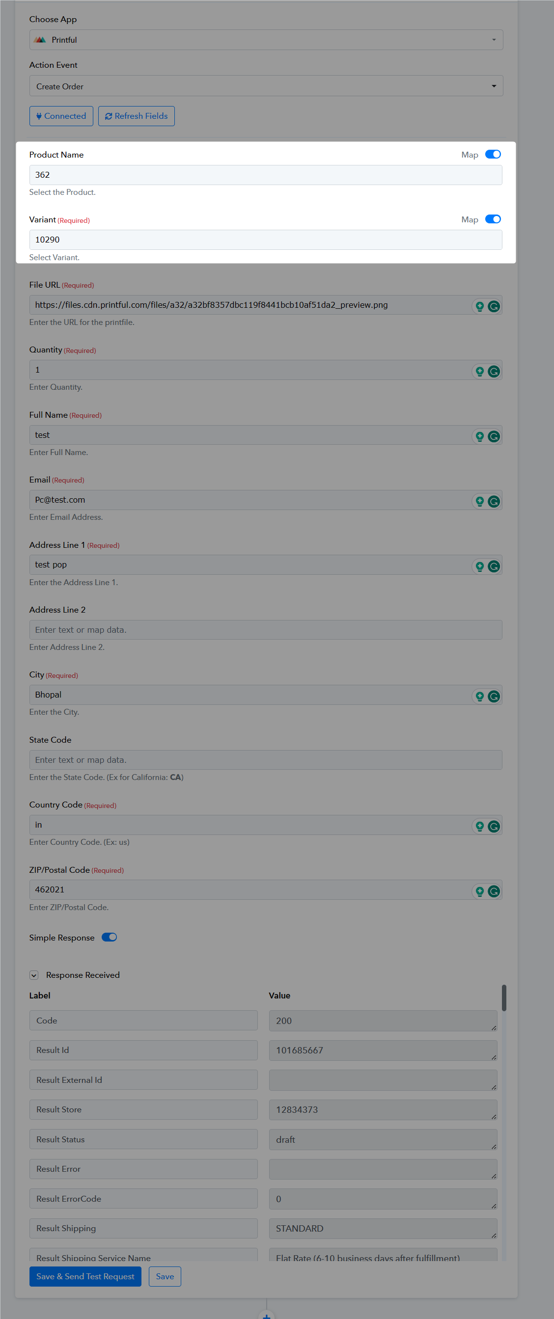

Hey @soujohn
In the Printful: Create Order action step, you should input the Products' ID and Variant's ID in their designated fields rather than using their names.
E.g. -

Thank you very much for the response. I was not able to fix the issue that I'm having, but I do think I've found the answer I needed. Two things:
First
  • You were absolutely correct. In order to correctly submit an order to Printful I needed to enter the product ID number and the variant ID number for that product instead of the product and variant name. By putting those values in my spreadsheet I was able to map it to the required fields.
  • This now allows me to successfully submit an order to Printful with all the required information they need for a DTG(Direct to Garment) print job
Second
  • Even after using the product and variant ID number in the Printful: Create order step action I still do not have a field to enter the thread_colors. This is the error that I was receiving in the original post
  • It turns out that submitting an order for an embroidery job is not available via the current Printful API
At least now I know that I can connect SpreadSimple with Printful, but I can only use the connection for DTG prints. Thanks again.
