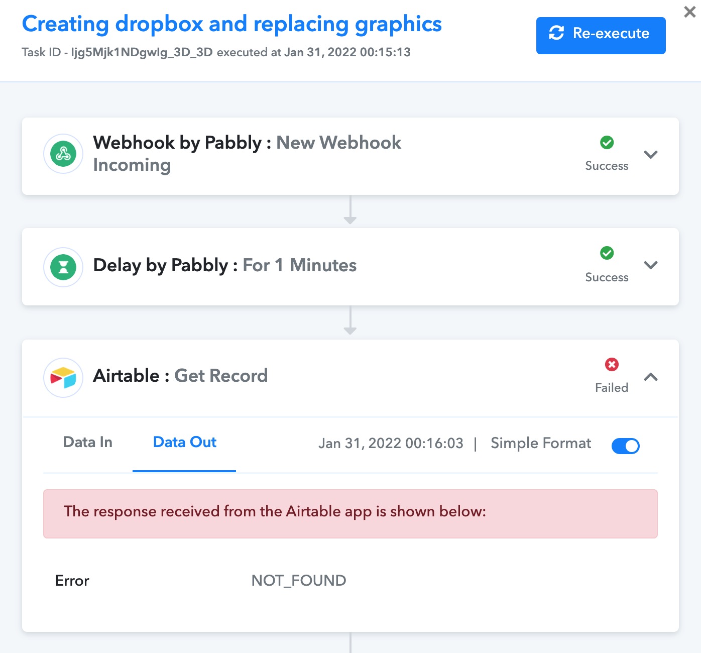

I have some trouble getting record from airtable, although my webhook trigger work perfectly.
What can be the problem?

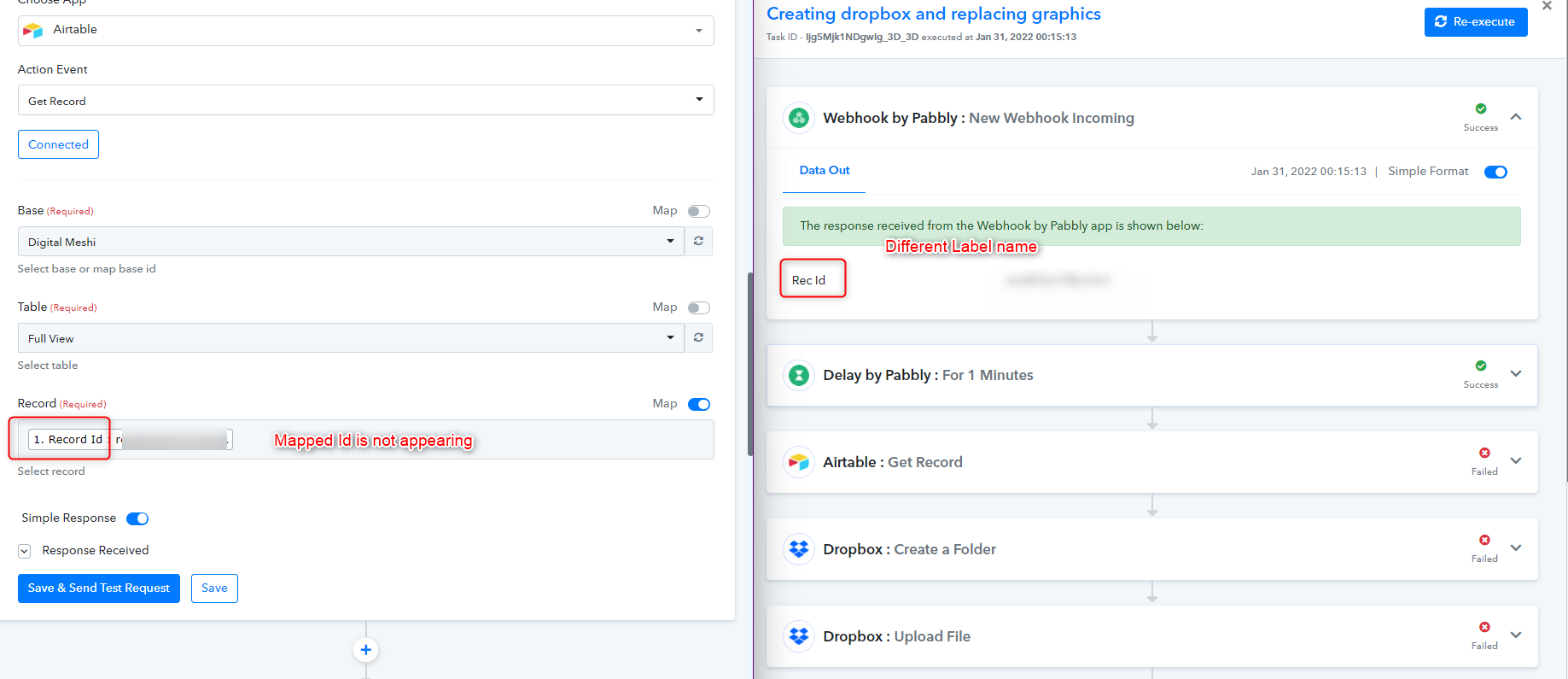

Hey @edwardzev
We looked into your workflow and it looks like you have made some changes in your triggering API and because of that, you might not be getting the mapped label that you have used to retrieve records from Airtable.
So, kindly re-capture the webhook response and mapped it again.
