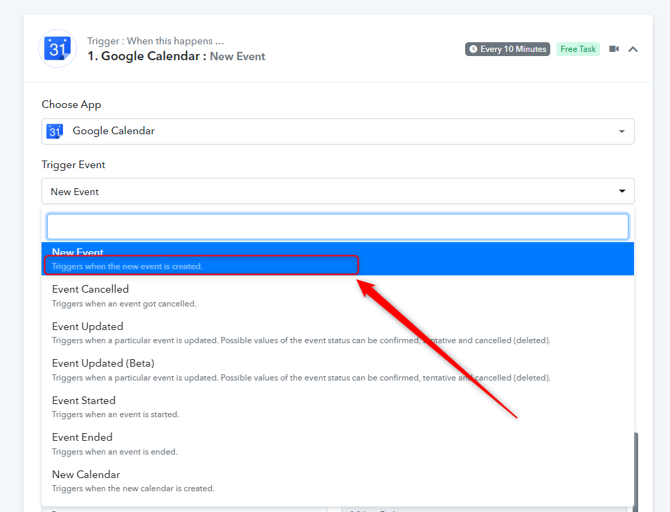

Ok so I cloned a workflow, deleted original, and then made the new one live. I am using the calendar called R1.
I put an appt in for later tomorrow and it worked fine.
When I go to the workflow history - I do not see future appointments (for Monday or any of next week's appointments) in here even though they are in the Google calendar for next week.
Since this is a newly created workflow - will it not trigger on events that were in Google calendar before the workflow was created? And only trigger on newly created events? I just need to know as it seems like it only works on newly created events.
No, the previously added calendar event will not trigger the workflow. After the workflow is set up then the newly created event will be followed the workflow accordingly.
