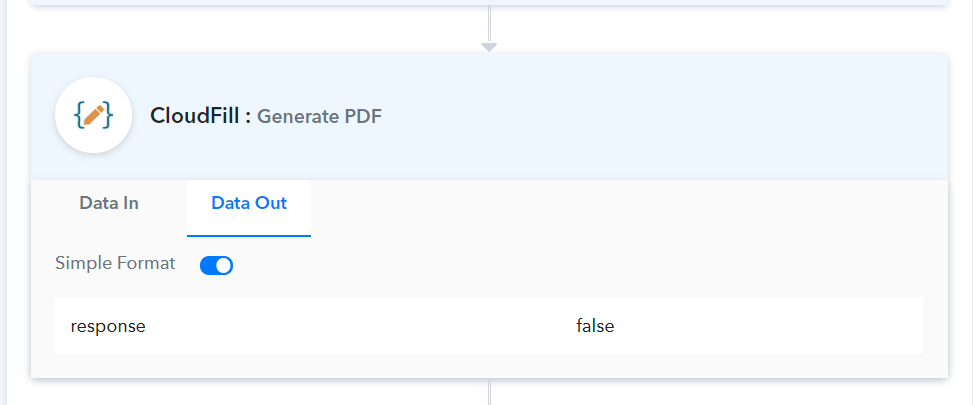

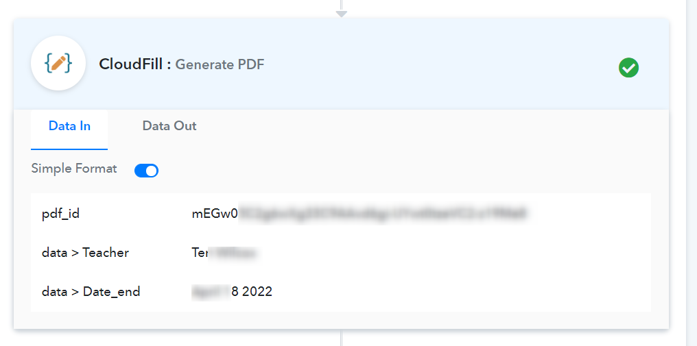

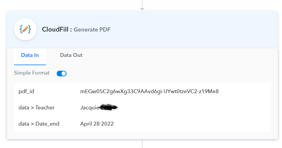

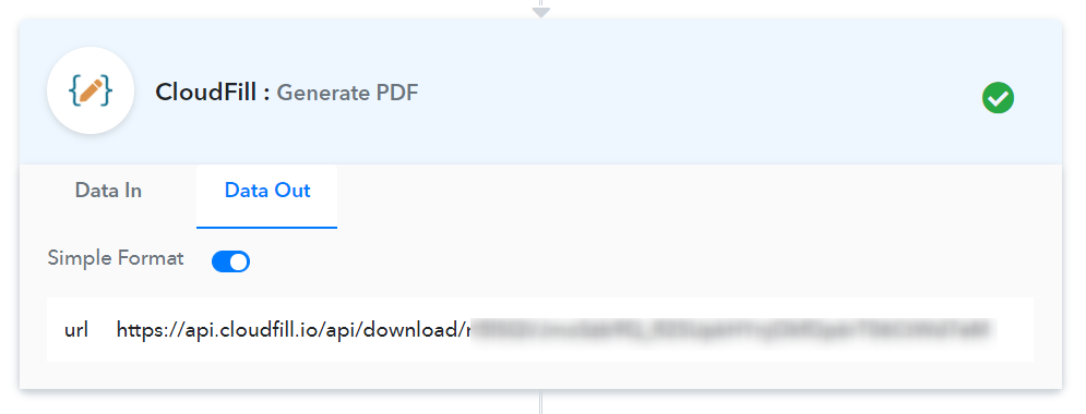

I am having repeated problems with my Cloudfill automation in Pabbly. It appears that the data from Pabbly is being received by Cloudfill, but Cloudfill is not returning the PDF location/id. When I replay the workflow step by step it seems to work OK so I'm wondering if its a time-out issue ? This is an ongoing problem and repeats in a number of workflows. Anyone have any suggestions?

I have added a text filter between the Cloudfill and SMTP step so an email only gets sent if there is a correct PDF link generated from the Cloudfill step. This is only a temporary fix. As I previously mentioned, if I recapture the webhook and then re-execute the tasks step by step, the workflow works.

So for my reference, was this a bug in Pabbly or in my workflow? The reaon I ask is that I could get it to execute correctly when done manually
Hey @Admiraltk
There was a slight issue with the Cloudfill account connection which we resolve by reauthorizing it.
Hopefully, you will not face any such error again.
