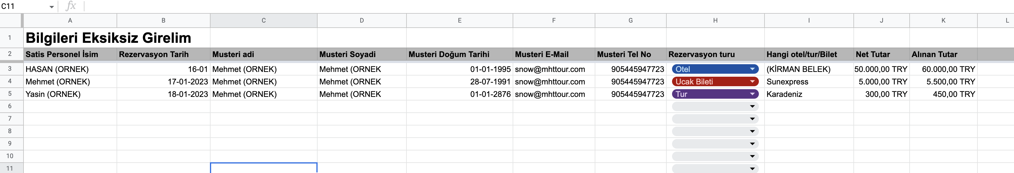

hello i have issues with transferiny my data from google sheets to pabbly connect, the connections is made but the rows and the columns comes not correct in pabbly connect, cane somebody help me
thıs ıs the google sheets

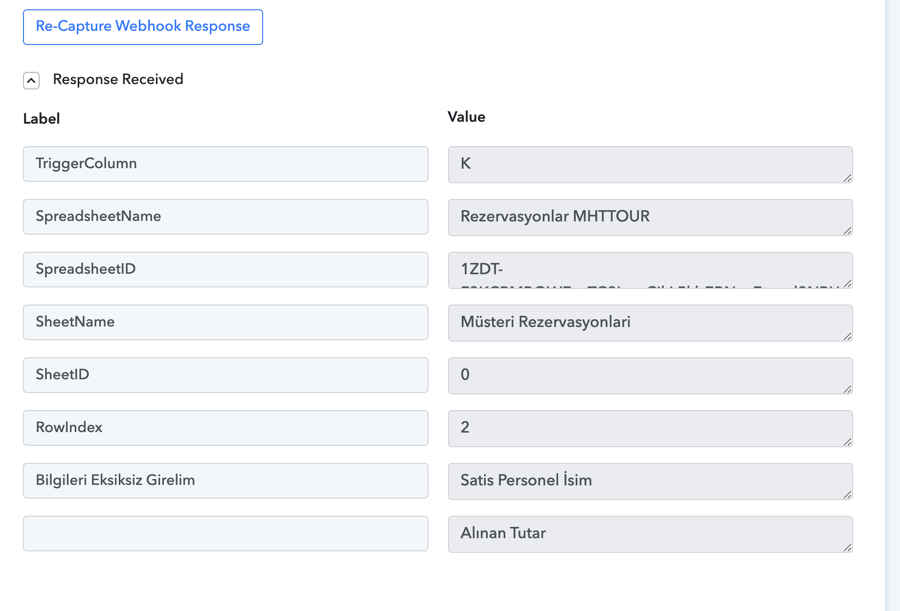

and this is how it comes in pabbly connecy:

You need to delete Row 1. The Headers should be in the first row.
