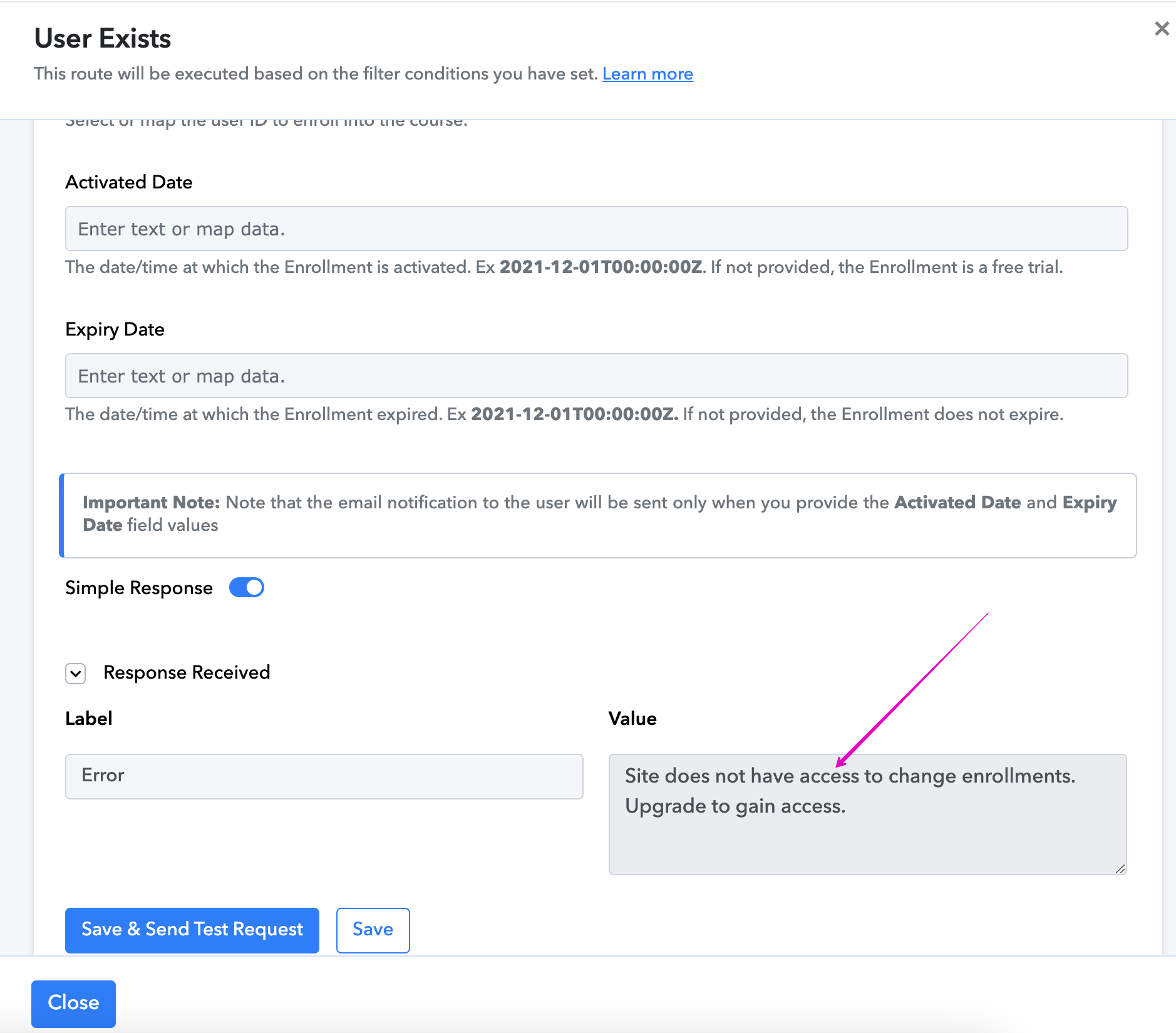

I recently purchased a paid subscription (Basic plan) on Thinkific and have set up the Pabbly connection with Thinkific. I am able to do the following:
1. Create a new user in Thinkific when Shopify purchase is made. - SUCCESS
2. Checking an existing user in Thinkific - SUCCESS
3. Enrolling a user for a published course - FAILED
When I try to set up the Router condition for enrolling a user, I run into the following error: " Site does not have access to change enrollments. Upgrade to gain access. "
I checked with Thinkific Support and they mentioned that they don't have any approved integrations with Pabbly Connect and that this error is not coming from them.
Can I please get an assistance how to set this up?

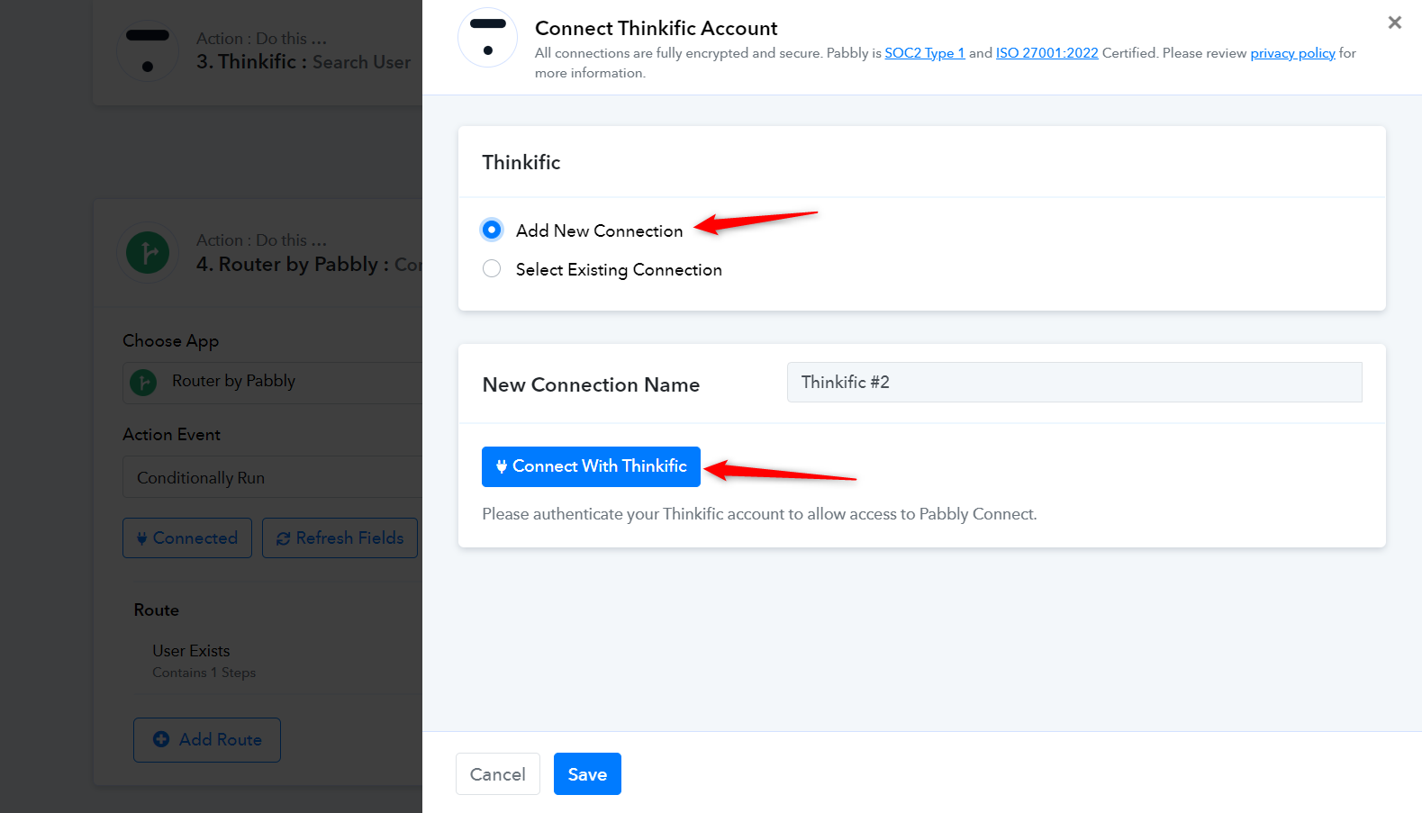

Please log in to your Pabbly Connect and Thinkific accounts in an Incognito Tab, then establish a new connection with your Thinkific account to see if that resolves the issue for you.
I followed your step but the issue is not resolved!!

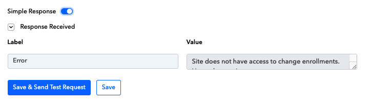

Hello @ArshilAhmad - I'm running into the same issue with error:
"Site does not have access to change enrollments. Upgrade to gain access."
I know that we can do these integrations with zapier's connection to thinkific.
I tried making a new connection as suggested to get the latest integration, but am still getting the error.
My flow was:
1. Receive user info via pabbly webook
2. Look up user by email address to get user ID
3. Enroll user (using course lookup - which works, and the user ID found via the lookup in the previous step)
Screenshot shown below:
My flow was:

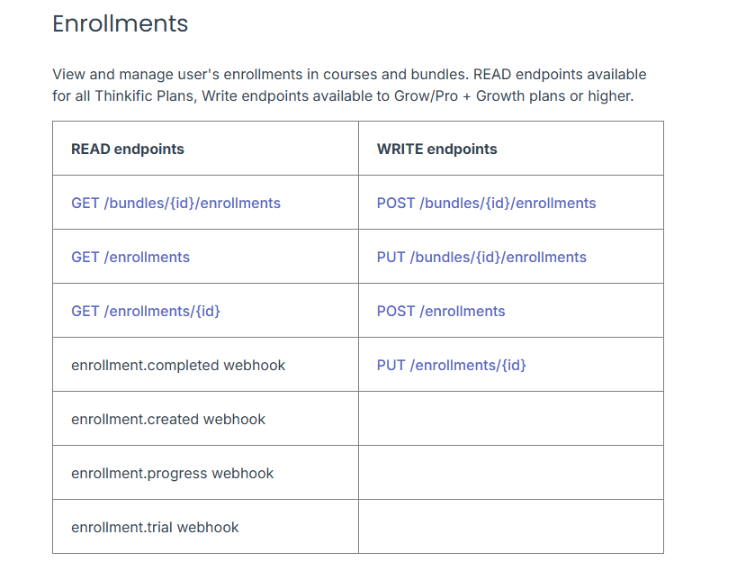

Hey @Evolve Artist,
This issue is due to a Thinkific plan limitation. The enrollment (write) API is accessible only on Thinkific Pro or higher plans. Since you are on a legacy/lower plan, the API does not allow changing enrollments, which is why the error is returned.
This restriction is from Thinkific’s end, not Pabbly’s. To use this API via Pabbly Connect, you will need to upgrade to a Pro or higher Thinkific plan.
