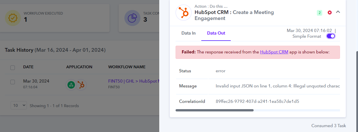

I originally had everything working except for the user assignment, but now, no matter what I do, I get this error, even after removing almost every field except those required:
"Invalid input JSON on line 1, column 4: Illegal unquoted character ((CTRL-CHAR, code 9)): has to be escaped using backslash to be included in string value"

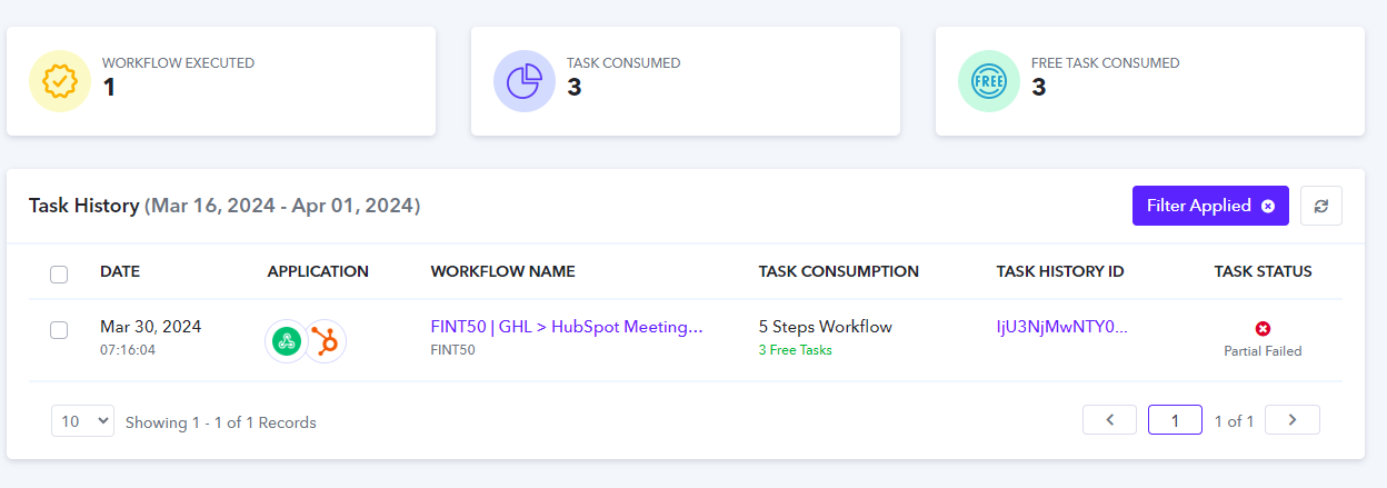

Thanks @ArshilAhmad for the input. It still isn't working as it is now throwing the same error when I am checking it via the Workflow history as shown below:
[TABLE]

[TD]Invalid input JSON on line 1, column 4: Illegal unquoted character ((CTRL-CHAR, code 9)): has to be escaped using backslash to be included in string value[/TD]

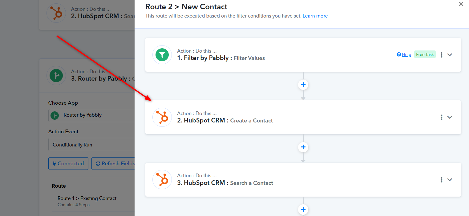

Hey @virtualinfosys

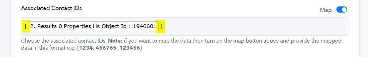

We can inspect from your task history and the mapped values in the 'Create Meeting Engagement' that due to the missing Contact ID, the action step is unable to create the meeting in HubSpot.
Immediately after creating the contact in the 'Create Contact Router,' the search contact step is unable to find the contact.
Therefore, please map the Contact Id from the 'Create Contact' action step either by reconfiguring it or by passing a new contact to obtain the Contact ID from that action step.

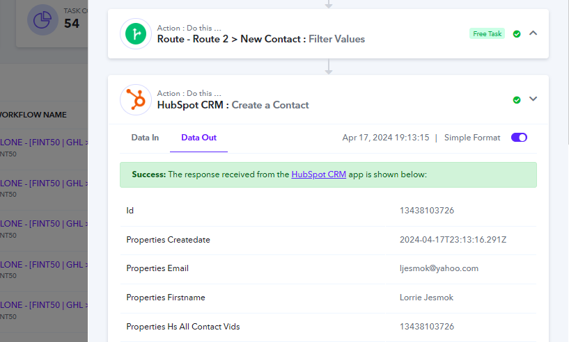

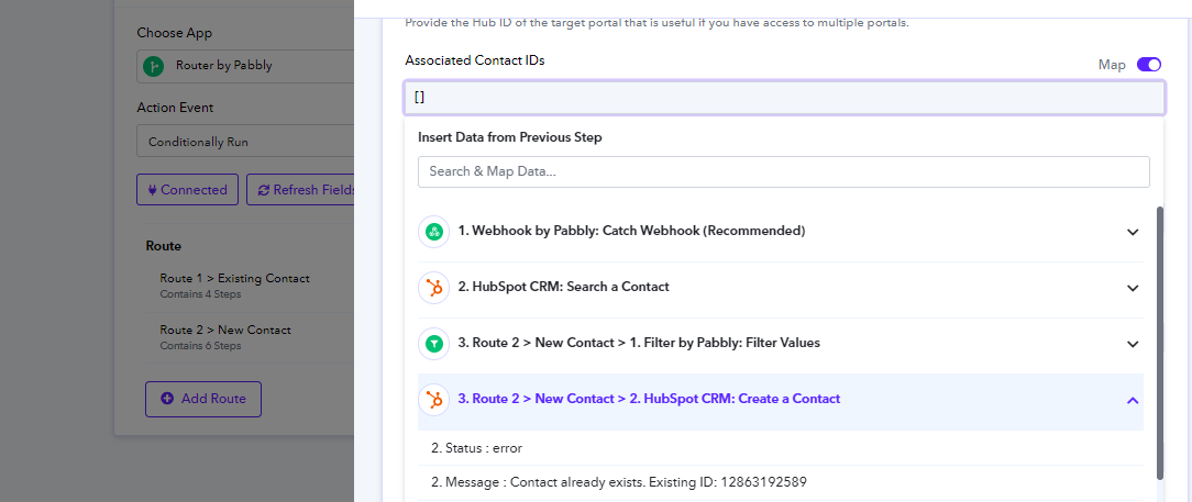

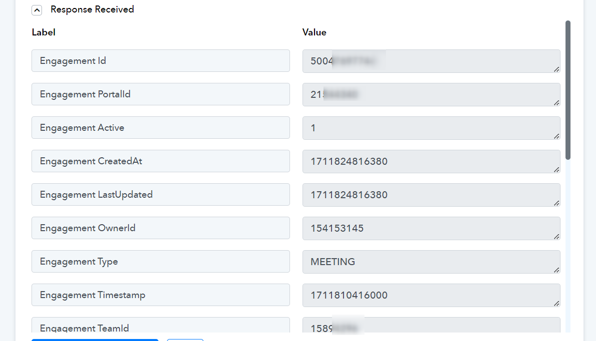

OK, The problem of meeting not created is only New Contact Route 2. I tried mapping Contact ID from "Create Contact Step" but it is now allowing here is the screenshot:
It shows status as error but in the actual run it does return the contact ID as shown here:
How can I map that ID in the create meeting Engagement step?
I have added the Delay action step in between the create and search contact action steps. So it will get the Contact ID from the Search action step accordingly.
Please give it a try now.

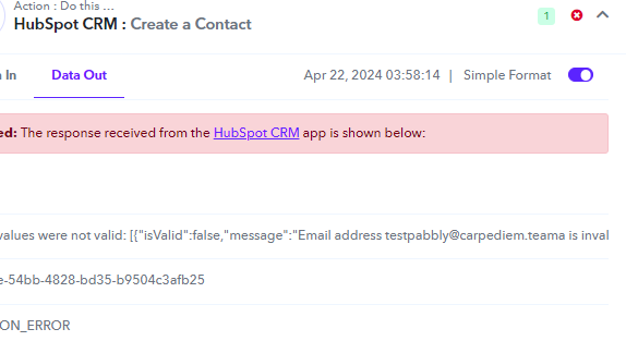

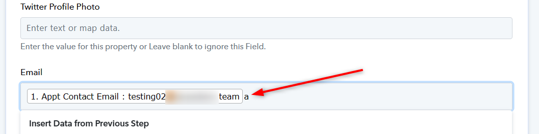

I have tested and is is suspiciously adding "a" with every email address user inputs which is causing the step of "Create a contact to fail"
Here are the screenshots:
I have removed the extra 'a' from your email address field which was filled, I hope the workflow should work.
Please give it a try and let us know.

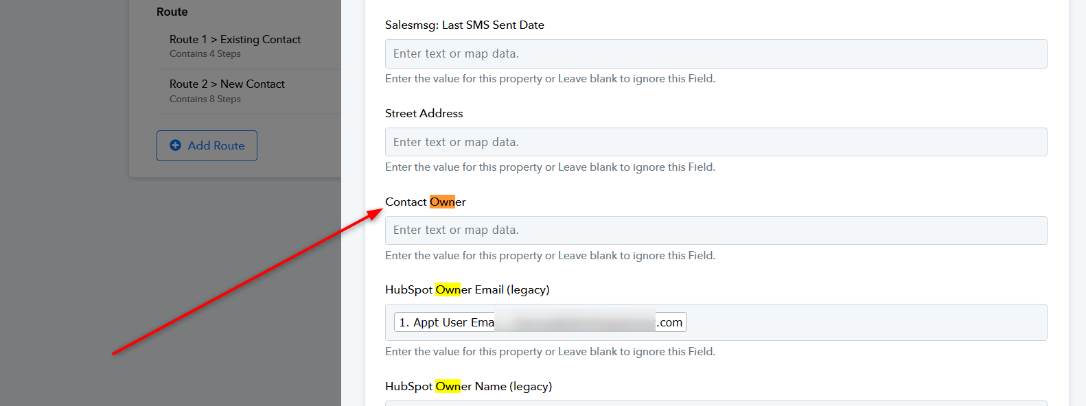

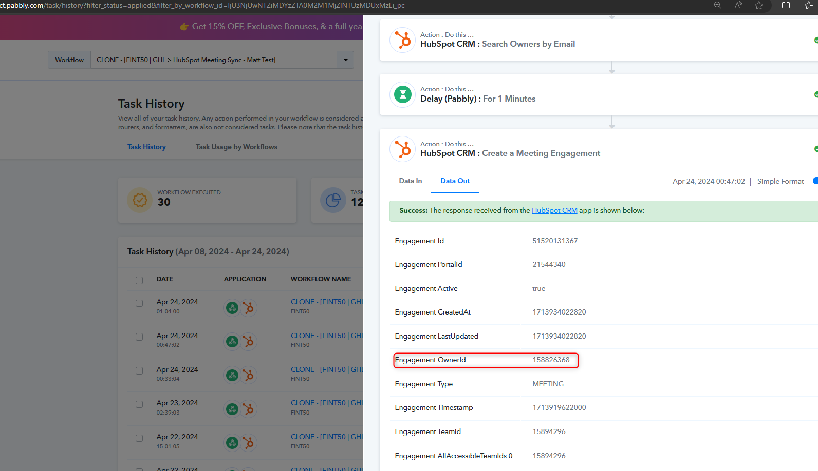

Thank You, Now the meeting and contact are creating as desired, the only issue remain is the contact owner not being assigned in HubSpot. I tried adding 1 Minute wait before Create a Meeting action but it didn't work? Should I be doing it in the contact creation step for "New Contact Route"
As I can see from your latest task history logs the owner is getting assigned to the meeting accordingly.
virtualinfosys — Reply ·
Yes it is, but I am asking about the owner being assigned to Contact in addition to the engagement.
Enter the owner ID for the Contact Owner field, which you can obtain using the Get all Owners and Search Owners by Email actions. While creating the Contact.
