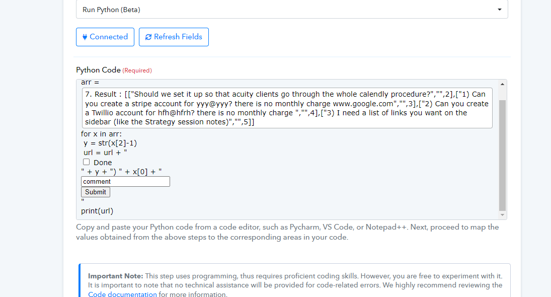

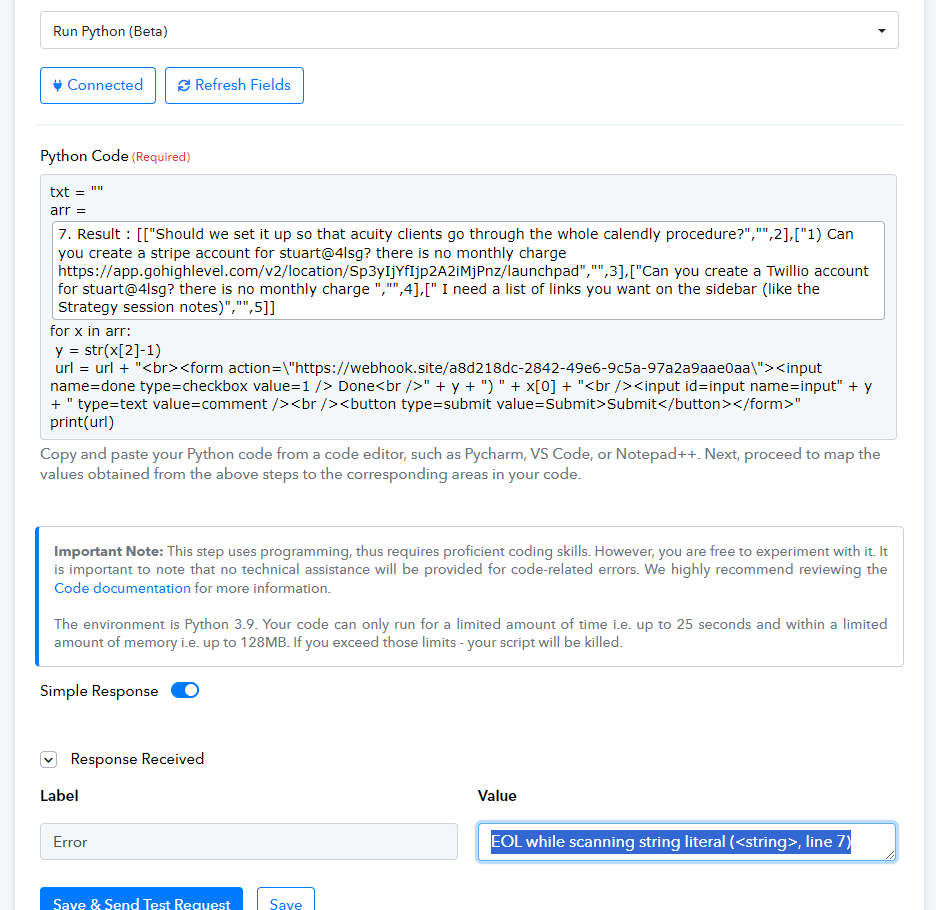

I am trying to create a dynamic webpage based on the results of a google sheets
basically it goes through the array (list) and creates a string of HTML from it.
it works fine in IDLE but in Pabbly it gives me this error: EOL while scanning string literal (, line 7)
Any ideas?

url = ""
arr = [["Should we set it up so that acuity clients go through the whole calendly procedure?","",2],["1) Can you create a stripe account for yyy@yyy? there is no monthly charge www.google.com","",3],["2) Can you create a Twillio account for hfh@hfrh? there is no monthly charge ","",4],["3) I need a list of links you want on the sidebar (like the Strategy session notes)","",5]]
for x in arr:
y = str(x[2])
url = url + "
" + x[0] + "
Submit"
print(url)
I tried running this code in an online compiler and got this error.
https://drive.google.com/file/d/1IGn7sxBiEb8ZmEVKzYnT8Vuzo6FtSLPL/view?usp=sharing

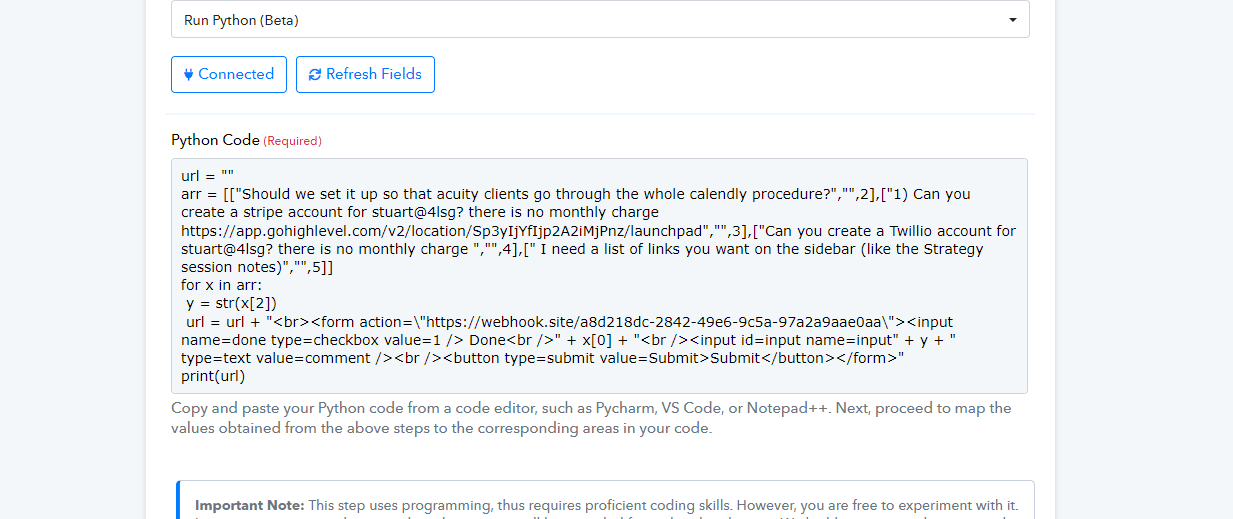

here is a video showing it working, and producing functional HTML code
