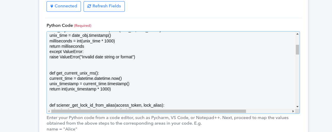

I can do the test. I don't mind at all but again my concern is why the source code looks unindent. I always paste indented source code and the pabbly makes my code unindent. If I need to make changes directly in the Pabbly code editor/textarea, the source code looks like a mess.
It is not like with the above code. It also happens with the small code. Check the below code. Python prefers formatted code. Am I doing any mistake? Do I need to use any other editor than Pycharm, or Visual Studio?

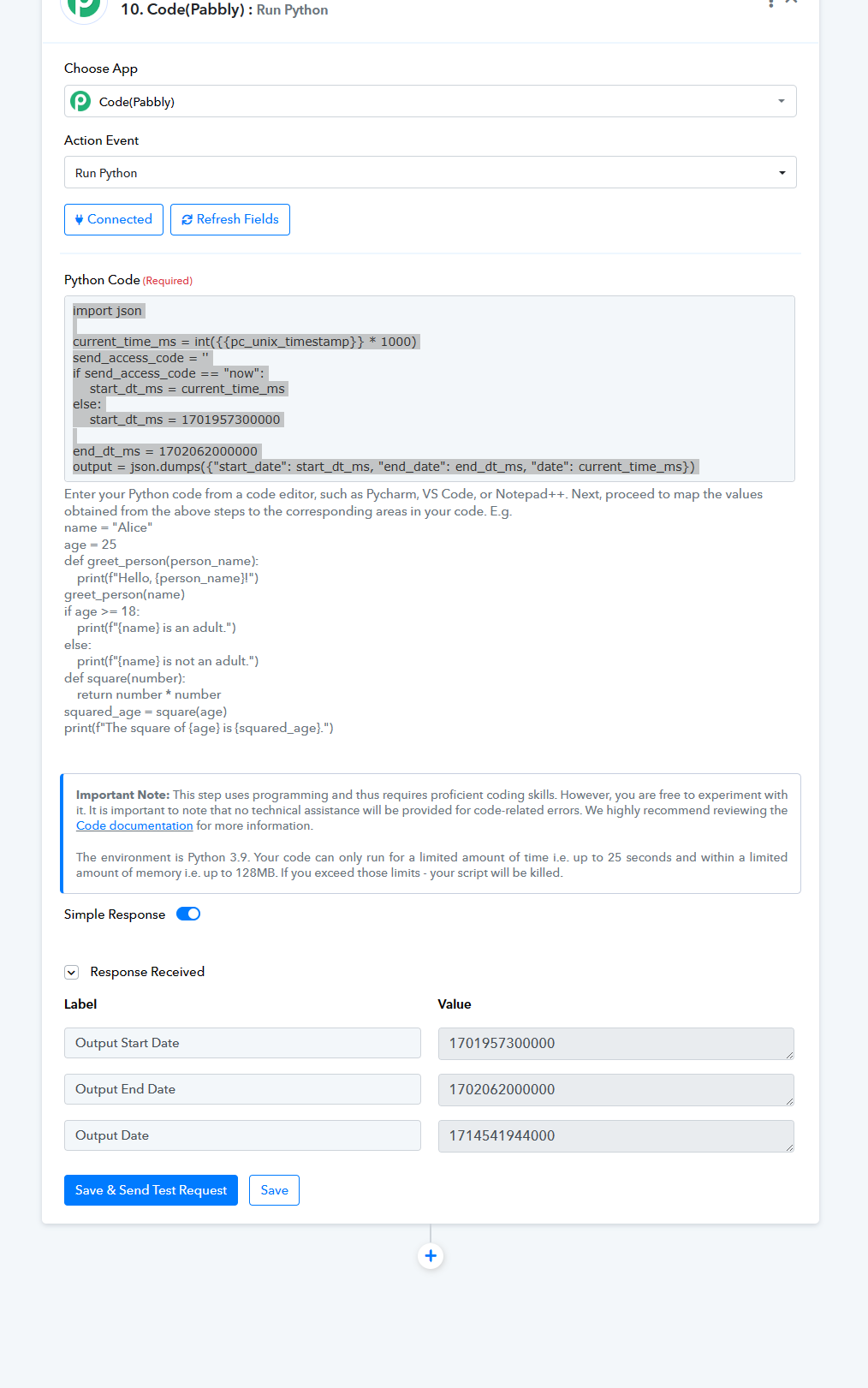

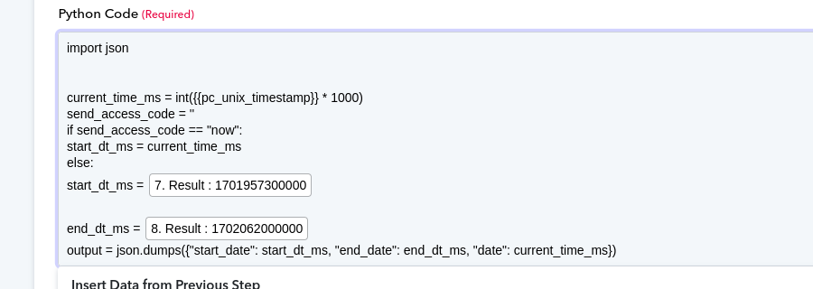

Ignore above code. I have very very small python code now. As per your recommendation, I split my python into chunks of small codes. The below given code is copied from the python text editor. I also attached screenshot of the same source code. The below code is working pretty well so we do't need need to run in the other online python editor. I still don't have answer why the Pabbly python text editor breaks source code indentation. Do you have any solution on it? I will close this ticket immediately once you provide me the solution.
import jsoncurrent_time_ms = int({{pc_unix_timestamp}} * 1000)
send_access_code = ''
if send_access_code == "now":
start_dt_ms = current_time_ms
else:
start_dt_ms = 7. Result : 1701957300000end_dt_ms = 8. Result : 1702062000000
output = json.dumps({"start_date": start_dt_ms, "end_date": end_dt_ms, "date": current_time_ms})

We have made some changes in the code and it is working fine now.
Thanks. I would like to know what changes you made so in the future it would be useful for me.
I've corrected the indentation in the code snippet to ensure that it follows Python's syntax rules correctly. Here are the changes I made and why:
- Added proper indentation: In Python, indentation is used to define code blocks within conditional statements and loops. I added indentation (four spaces) to the lines of code inside the if and else blocks to indicate that they are part of these conditional blocks.
- Updated the if-else structure: The original code had an issue where the if block didn't have a proper indentation, leading to the "expected an indented block" error. I adjusted the indentation so that the if and else blocks are properly defined.
Thanks. Have you checked my below-attached video? In the attached video, you can see my code is indented and properly formatted as per Python code style. I copy-paste the same code and paste in the Pabbly Editor. Do I need to indent again in the Pabbly code editor every time?
If so, why do you recommend Pycharm or Visual Studio? It seems to be a bug in your Python code editor.
