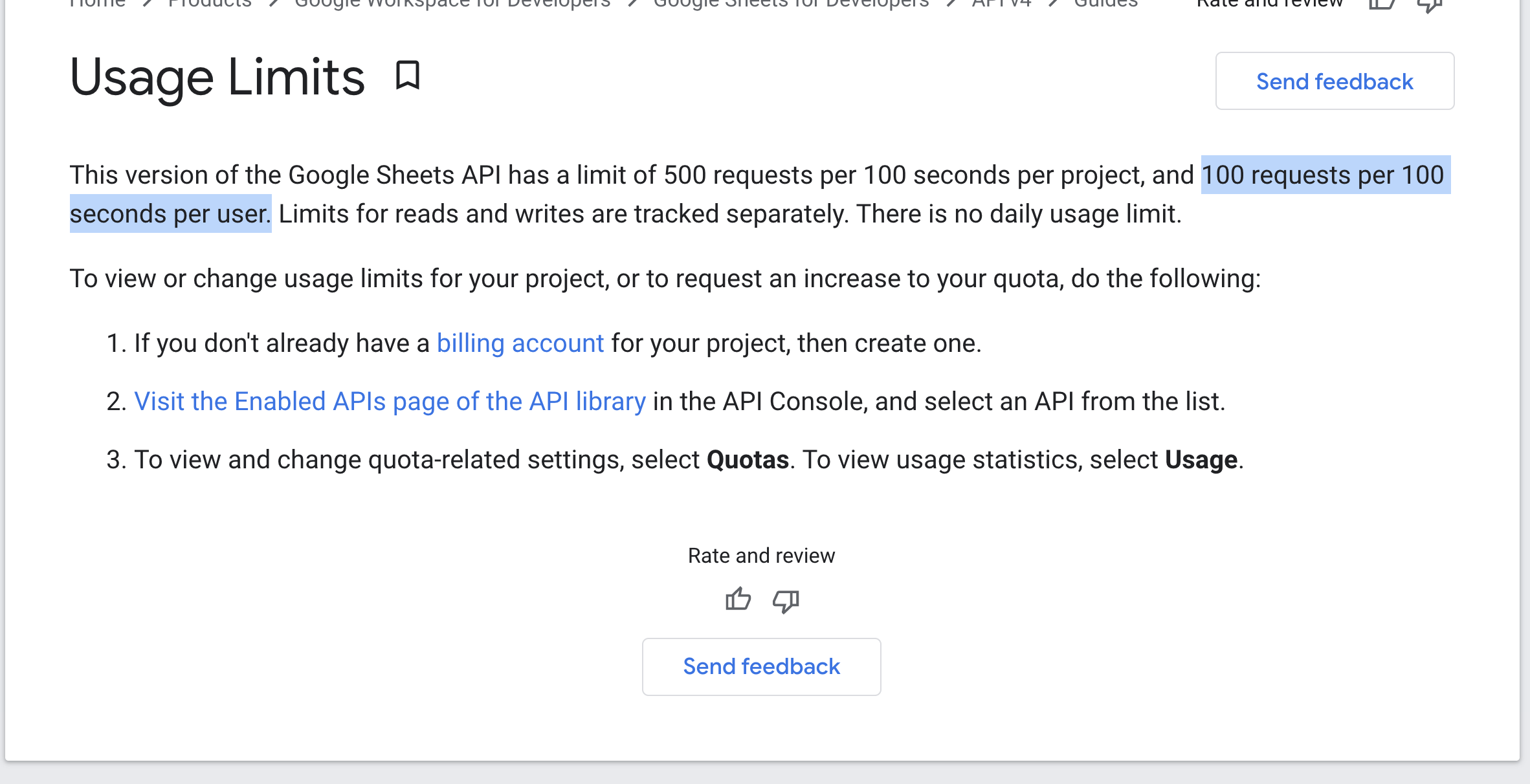

Google Sheets API has usage limits on per user basis. In the error shown, your rate limit for adding rows of data to Google Sheets has been exceeded.
You can check the limits here.
You can only add upto 100 rows of data every 100 seconds. Prior which your operation will fail.

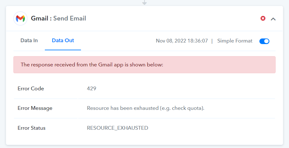

Hi team, can you help me understand the current limits of sending gmail? This is the error I get:
I am not sure I reached 100 requests in 100 seconds...

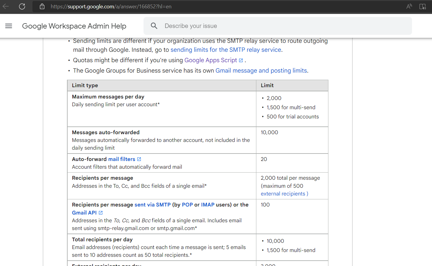

The limit of sending emails from Gmail is defined; if you exceed the limit, the Gmail API doesn't allow you to send the emails.
Though you can check the Gmail documentation, for the quota on how many you can send emails in a day.
https://support.google.com/a/answer/166852?hl=en
https://support.google.com/mail/answer/22839?hl=en#zippy=%2Cyou-have-reached-a-limit-for-sending-mail

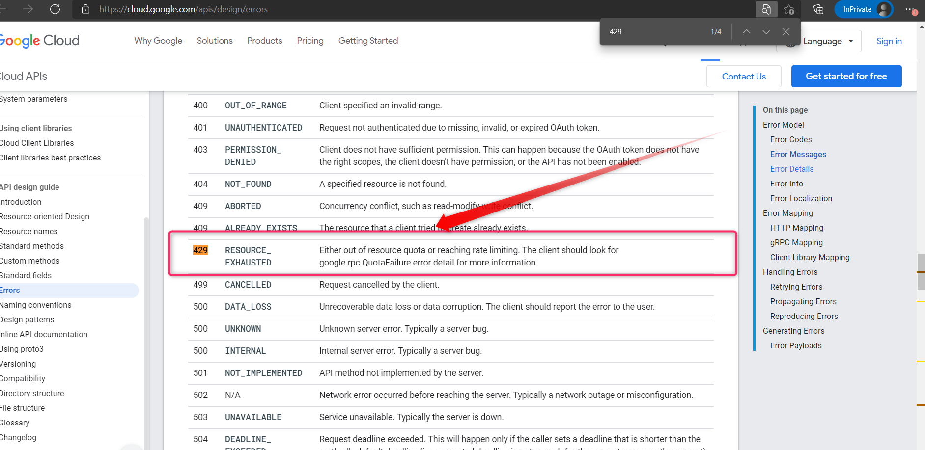

As we can see from your shown error, you have exhausted your rate limit to pass the request to write data per minute by "Google Sheets".
Google API documentation for the error which you have got.

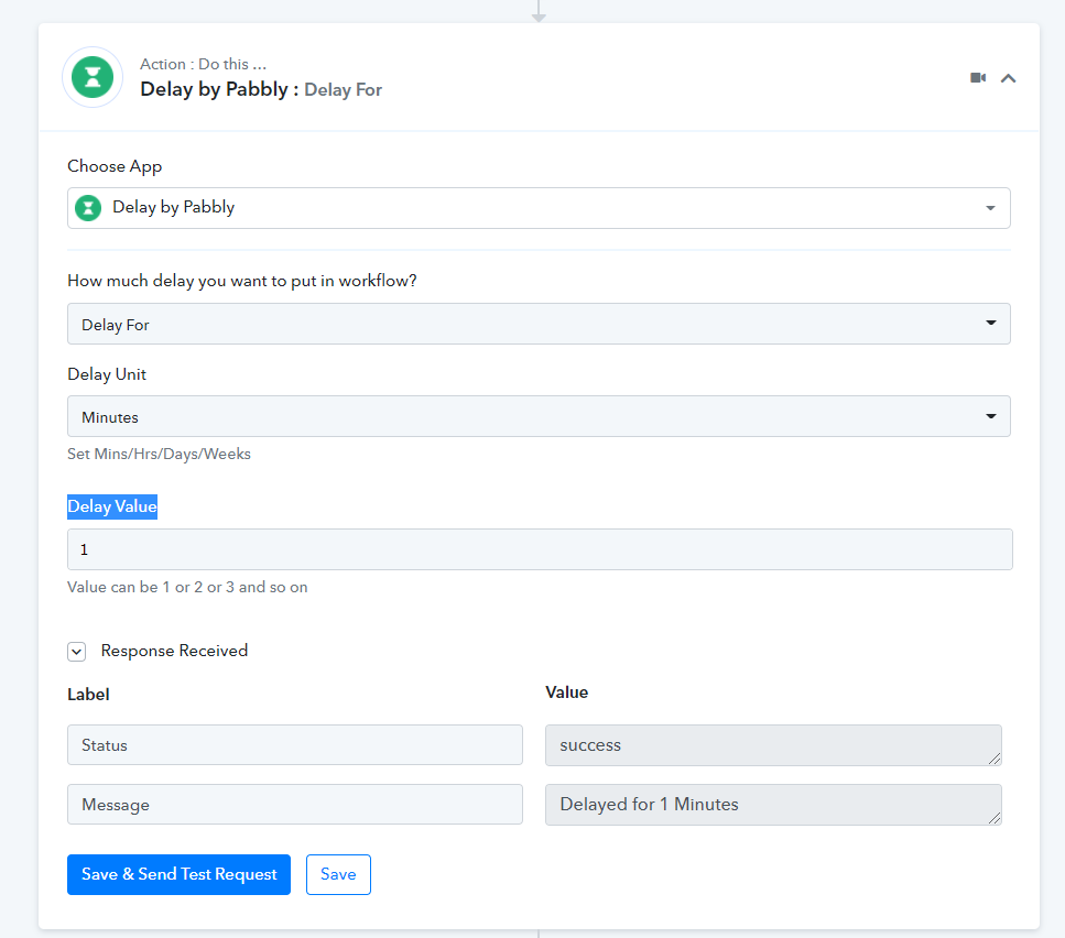

Moreover, you are also running the tasks in bulk and because of that, the error has occurred by the Google API. So, we should suggest to us a delay action step delay the task to run after 1 min after every update of value, in that way you wouldn't be exhausting your rate limit.
