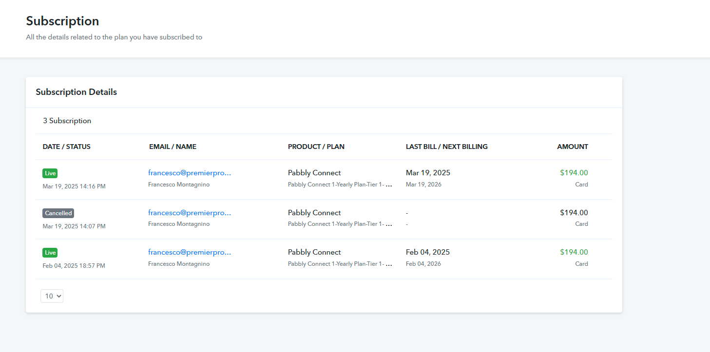

FrancescoPremier — Reply ·
these are the only subscriptions I see, where can i find what plan were on?
Hello @FrancescoPremier,
We are asking about the Wati Plan you are using not pabbly's plan. Please let us know the WATI Plan you're using.

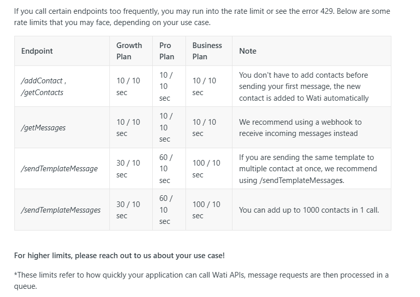

Thank you for reaching out.
Upon reviewing your plan, we noticed that the Pro plan has a limit of 60 requests per 10 seconds for sending template messages. The rate limit errors you encountered on March 21st were due to over 100 requests being sent within just two seconds, exceeding the allowed limit.
You can try executing the requests again, and they should work fine now. However, to avoid this issue in the future, please ensure that no more than 60 requests are made within a 10-second window.
If you require a higher request limit to accommodate your message flow, we recommend upgrading to a plan that better suits your needs. Let us know if you need any further assistance.
https://docs.wati.io/reference/errors
