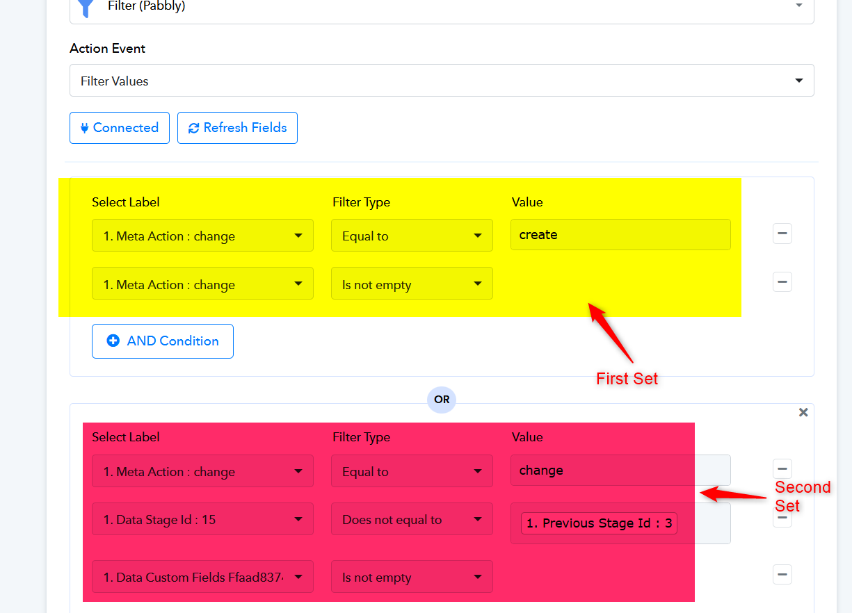

We have a workflow that syncs data between 2 CRM's under certain conditions, for example, a deal changes stage or a deal changes status. We do this by firing a webhook to Pabbly and having a filter that checks to see if "Stage ID does not equal the Previous Stage ID" OR "Deal Status doesn't equal Previous Deal Status", update the record. Here's the dilemma.
When the deal changes stages, "Previous Deal Status" variable is not sent in the webhook, or when Deal Status is changed, a "Previous Stage ID" is not sent. This causes a warning that says:
Warning:
Error in filter mapping detected. Possible causes include deletion of the mapped data step or changes in the response for the mapped key. You can remap the select label field to correct the filter condition or ignore to keep the existing filter condition.
We've tried mapping the data using a webhook that contains each type of response, and mapping the filtering conditions accordingly, but because of this warning, we're unable to save the workflow.
What can we do to work around this?
Hi @wonders83,
You won’t be able to set up a Filter step for this. Instead, you will need to add a Router to your workflow and create a separate route for each OR condition. This way, each OR condition will be handled in its own route.
You can then change the response in your trigger step, and even if the mapping disappears in one route, you will still be able to save the filter condition in another route without any issues.
P.S. You won’t be able to replace the Filter step with a Router directly, as the Router needs to be the last step of the workflow. So, you will need to add it at the end of the workflow, then create one route with the first set of filter conditions. After that, add Steps 3 to 7 of your workflow to this route (you will need to redo the mapping in these steps). Remove Steps 3 to 7 that are outside the Router.
Once the first route is set up, you can simply copy it, then configure the second set of OR filter conditions in route 2. You can repeat this process for additional conditions as needed.
