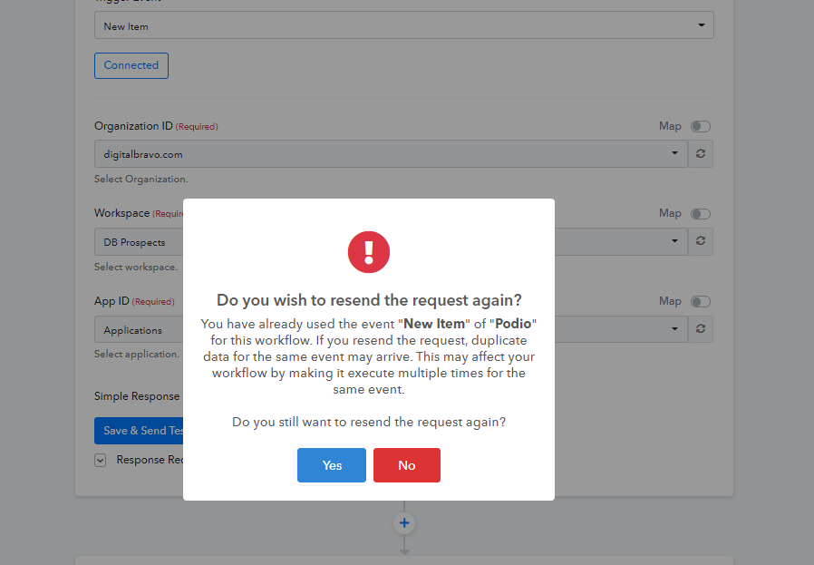

I am a Zapier user (for 2 years) wanting to transition to Pabbly.
After learning from a tutorial video I learned that I need two steps in a workflow to extract a new item from a Podio App. (not sure why it isn't all in one step like Zapier, but it is what it is)
My issue is that I did it as the video instructed, but replaced the google sheet step to smtp.
It works, but I get 3 (three) duplicate emails. I'm eating up my free task just trying to troubleshoot this.

Hey @TangoBravo
It appears that you might have pressed the "Save & Send Test Required" button more than 2 times and because of that your Podio application is sending the webhook response to your workflow multiple time.
So, as a solution, we would recommend you check your Podio account once for multiple same webhook URLs and delete similar URLs for it.

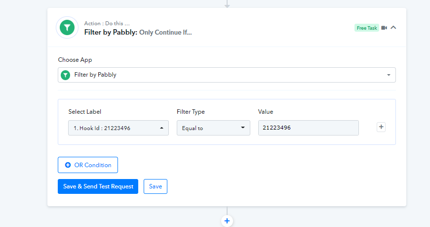

Or you can use the filter action step after the trigger event, which will only process the webhook for a specific webhook ID.

Not sure how to check my Podio for multiple webhook urls to delete but I'll check it out. Else I'll just delete the workflow and start from scratch. (the filter didn't filter). Zapier doesn't have filters (that I know of) so no idea.

Hey @TangoBravo
You can also clone the workflow and configure the trigger event only once then turn off the previously used workflow. In that way, your additionally created webhooks wouldn't send the webhook response multiple times.
