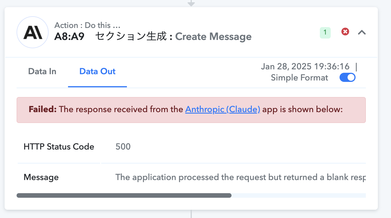

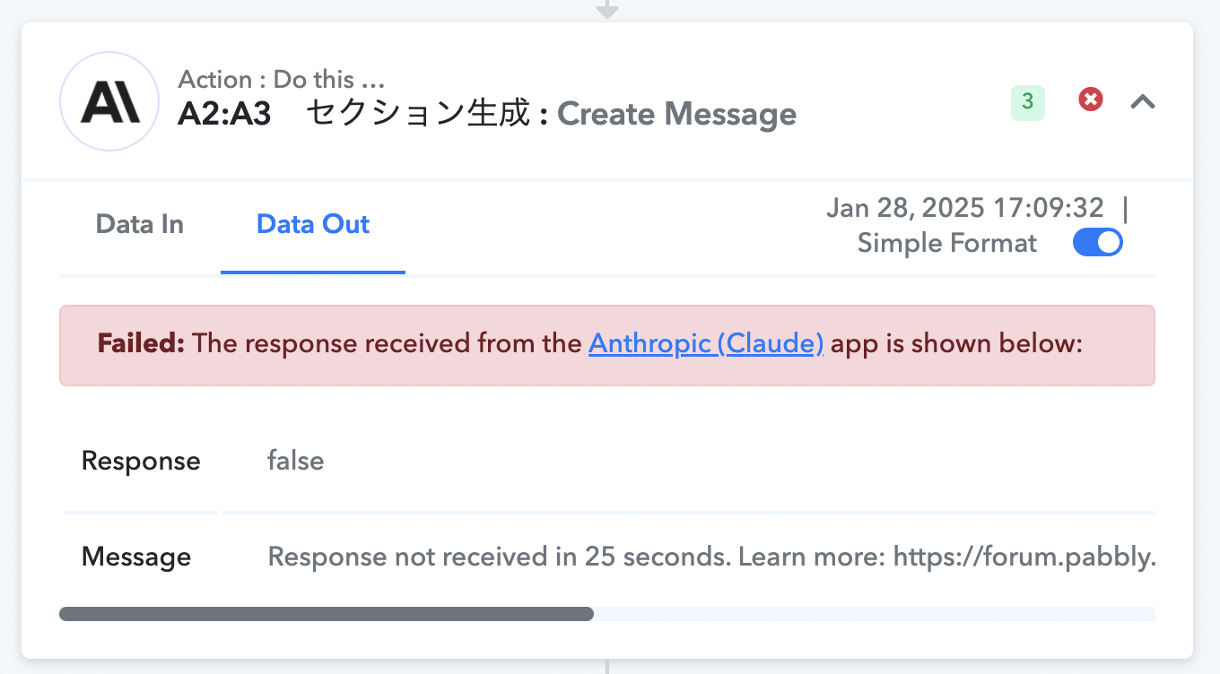

  1. Problems Encountered:
  • Frequent 25-second timeouts
  • HTTP 500 errors (blank responses)
  • Workflow execution stops due to these errors

Regarding the 25-second issue, unfortunately, we cannot resolve that on our end. Pabbly Connect waits for the API to respond within 25 seconds, but if a response isn't received in that time, you will encounter this error.
The 500 error code indicates there’s an issue on the application’s end. In such cases, you would need to contact the Claude team directly to address the problem.
