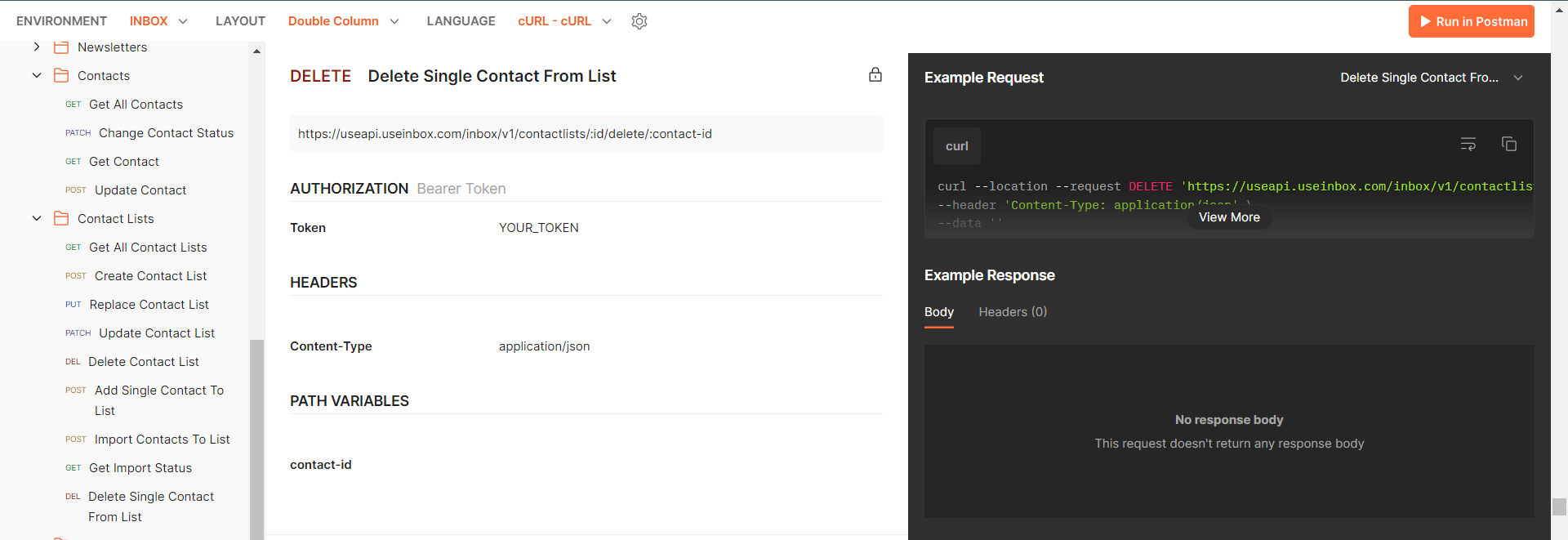

Could you please confirm if you want the "Delete Single Contact from List" action event? Once confirmed, I will forward this request to the tech team, and they will create an endpoint for you.
https://reference.useinbox.com/#1bd126ea-6f14-e67f-43a6-dec7bab16ff8

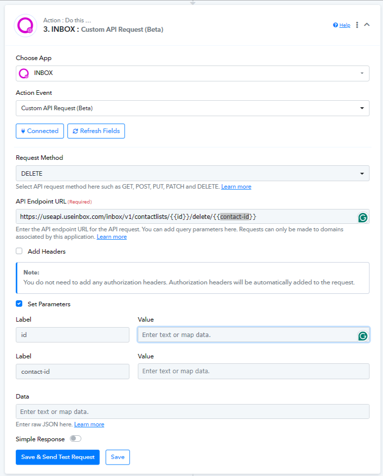

We have checked your concern with our team. You can use the custom API request for the INBOX application and use the delete endpoint URL.
We have set this up in your account; you just need to enter the contact list ID and the contact ID in order to delete the contact from the list. Please try this on your end and let us know if you face any issues.

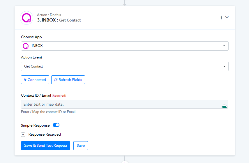

You can find the contact ID by adding one more step in the INBOX application: the "Get Contact" step. Simply map the email of the contact to this step to get the details of that contact. Then, map the contact ID to the subsequent action step to delete the contact.
