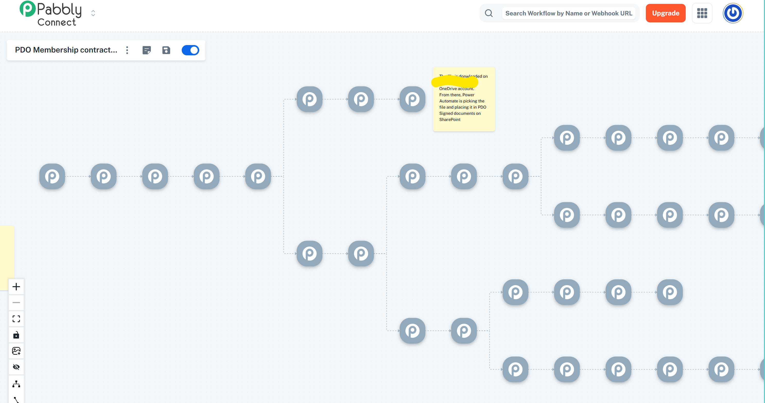

I am working on a workflow using the new layout, great feature to visualize the different routes !
However, although I have several times renamed the steps, they keep on being reset with default app names, which makes it very difficult to build the workflows.
In the execution history, same problem, the steps name were replaced by default app names, and it makes it cumbersome to understand which step failed.

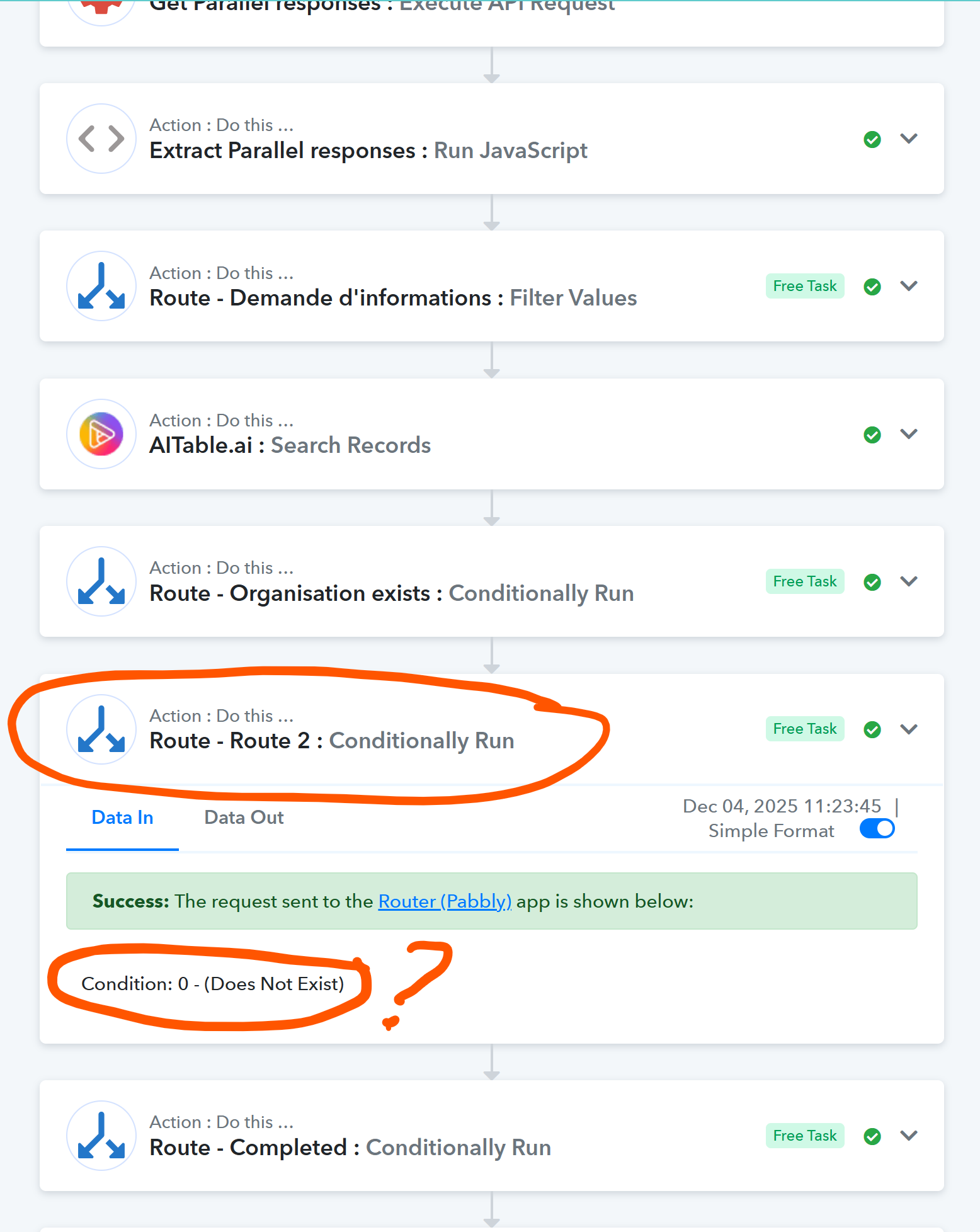

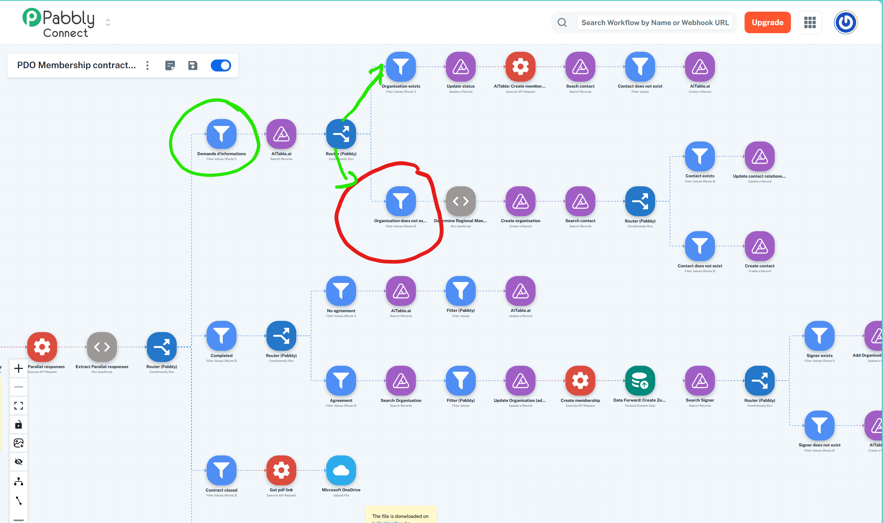

I have a recent example, and it seems the problem is broader than just only the name.
In my workflow (IjU3NjYwNTZhMDYzMjA0MzI1MjZkNTUzMjUxMzci_pc), I have successive routers and filters.
After the first route, named "Demande d'informations", I have another router and 2 routes:
1. "Organisation exists"
2. "Organisation does not exist"
In workflow history, the 2nd route does not have the appropriate name, it still shows "Route 2", and also, the filter inside it does not seem to correspond to what is actually configured.
Consequently, my automation never goes beyond this router / filter ...
