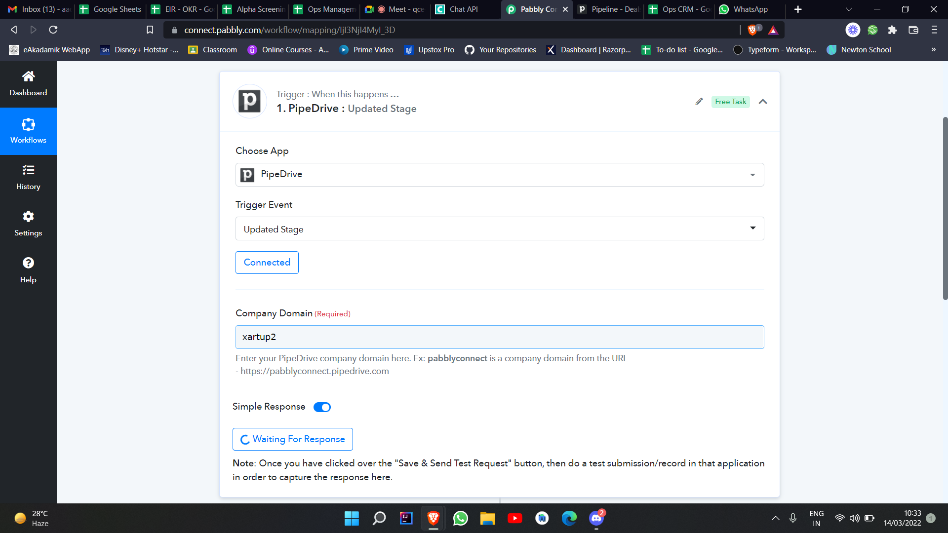

I have been trying to test my workflow by collecting the test response but everytime we are getting this result (attached below), even after trying many ways out to solve this issue.

Hey @Xartup
We are currently looking into the PipeDrive: Updated Stage trigger event since the trigger is not getting any data from the Pipedrive.
Please allow us some time, we will get back to you with an update soon.

Hey @Xartup !
Thanks for waiting.
We checked the concern with the PipeDrive support and it seems that you are updating deals, but the webhook is set for updating stages.
The difference here is that when moving a deal between stages, the update is made on the deal.
Updates in stages are if you change the stage name, or the order of the stage.
If you are making changes in the deal from moving one stage to another stage, then in that case you need to use Update Deal event to make it trigger for you in the workflow-
Hope, this works for you.

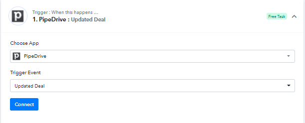

Hey @Subin
We tried the "Updated Deal" thing out but this is the end result which we've received (Screenshot attached below). Please help us out with this.

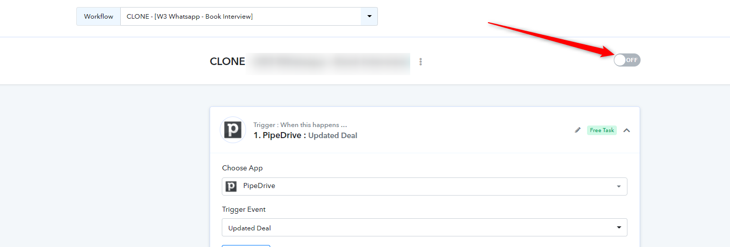

Hey @Xartup
Kindly switch on the workflow and try giving a test submission from your account.
Xartup — Reply ·
Hey @Xartup
The workflow was kept on while testing the integration.
