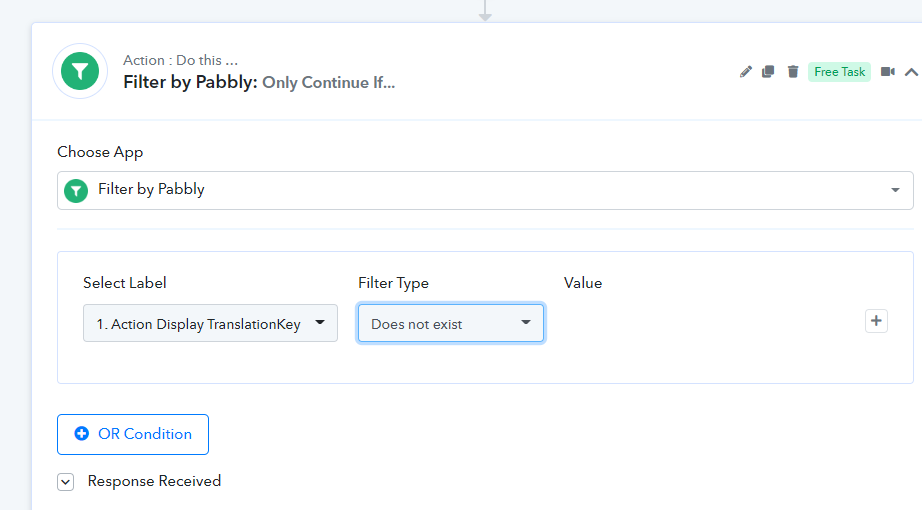

Hey @AgentM
You can use the Filter action step with the "Does not Exist" filter type for your work. I hope this might help you out.

For your usecase you need to use Router instead of filter. Here is video on Routers -
Make sure you always try this with data which exist in gsheet. Only then you will be able to set filter in Router that Row Index key:value does not exist.

@GroeiGarage: Yes, it did work for me. I did a "Google Sheets : Lookup Spreadsheet Rows", then a "Router" where I use the "Filter" to check for "Route 1" is the data is not present and follow with a new row and "Route 2" to update the row.
