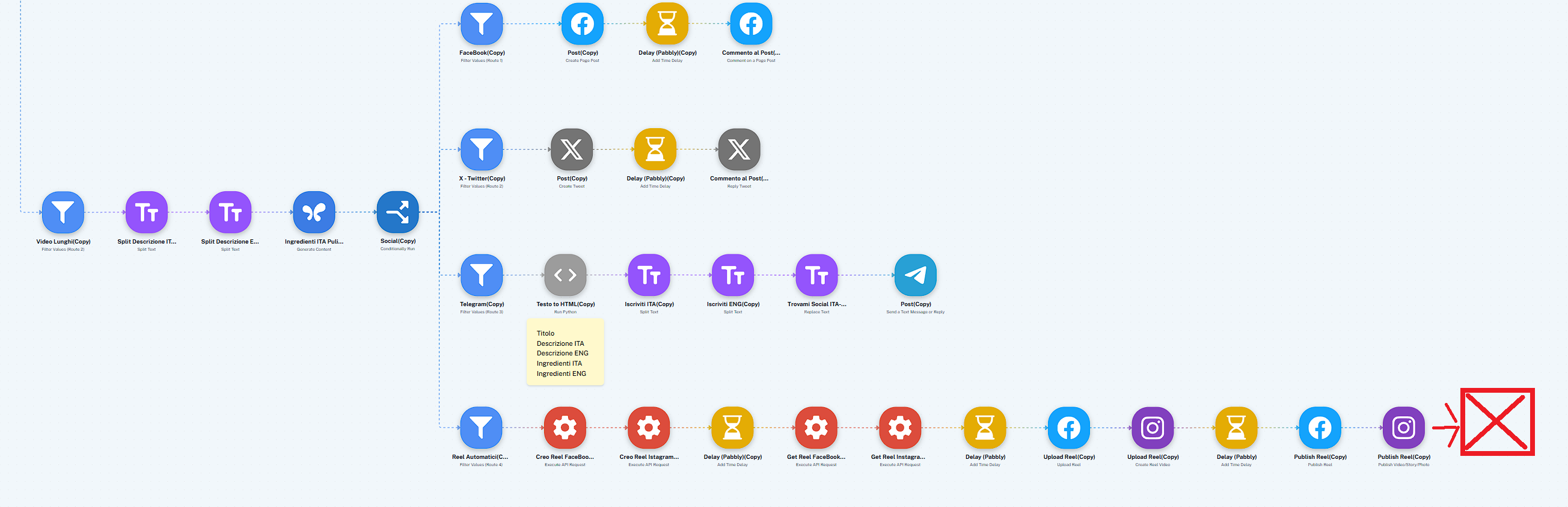

If I make a router with 5 branches, all with an always true condition, will all 5 branches be executed? How It works?

If I want to set a task that runs once all the branches have been executed, where should I put it? As the last task of the last branch?
How do I tell pabbly to run a task only if all branches have been executed without errors?

There isn’t a direct feature for this, but you can achieve it with a workaround.
What you can do:
Instead of keeping all 4 routes separate, try structuring them in a nested way:
  • Create Route 1 → add its steps
  • Then Route 2 → add its steps
  • Then Route 3 and Route 4 similarly
After this, create a Route 5 where you want your final step to run.
In Route 5:
  • Add filters using the AND operator
  • Map conditions from all 4 routes
  • This way, Route 5 will only run when all previous routes meet the conditions
To make sure no step failed:
  • Identify a field from each step that only appears when it runs successfully (like an ID or response field)
  • Add filters to check those fields exist
  • Do this for all important steps across the 4 routes
Important:
  • Use only AND conditions
  • Add checks for all routes
  • You’ll need to test this properly once set up
This is a workaround, but it should help you get close to the behavior you want. Let me know if you want help setting it up.
