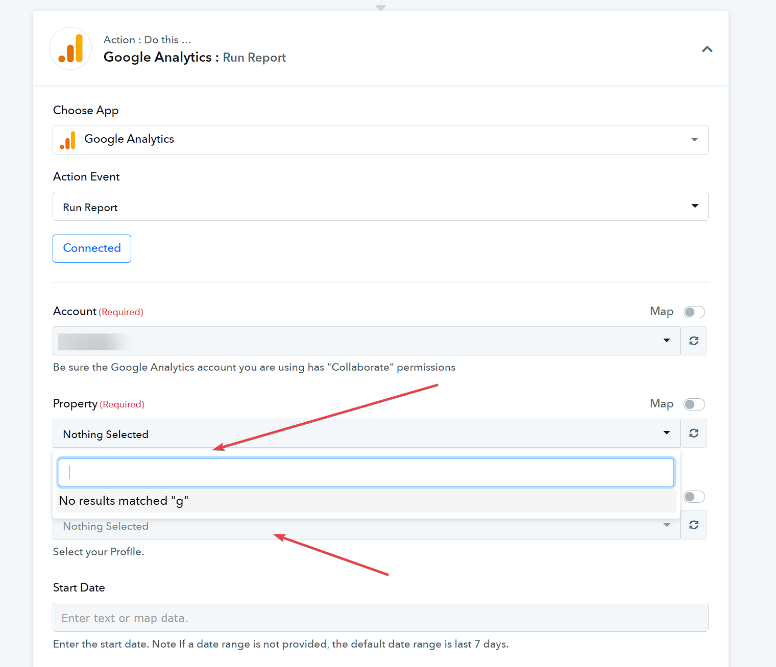

I am trying to automate GA reporting using Schedule as a trigger and GA as an action and then updating it on Google sheet.
I connected the GA account but i am not able to select the property and profile in the dropdown.
Can Anyone help? It is a GA4 account.

Hey @Vikas
We are currently working on it as it will require a new API version compatibility. So kindly allow us some time, we will update you soon.

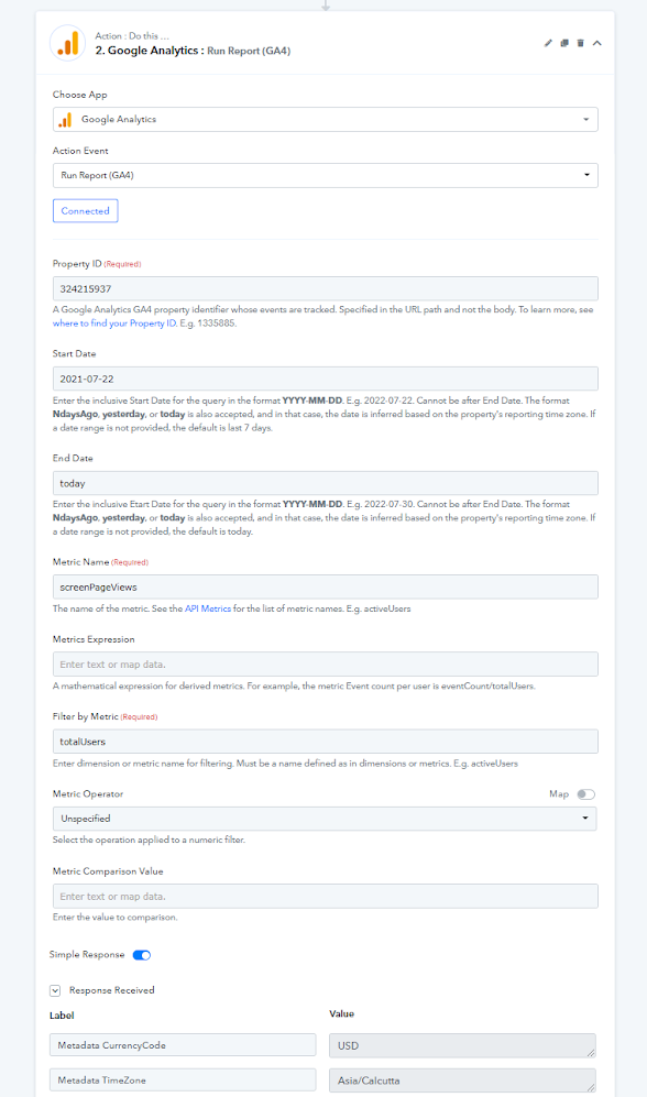

Vikas
Hey @Supreme ,
Thanks for the quick response. I tried the integration however I am not being able to run a report and find the data I am looking for.
Here is my use case -
I am looking to reports in a google sheet. The data I need would be - Daily users, sessions, events, bounce rate, pages visited, conversions etc. I am entering the details but not able to get the data in the test request.
Can you please create a video tutorial or a documentation for the same?
Also, @Fagun Shah Can you help me here?
Thanks,
Vikas.

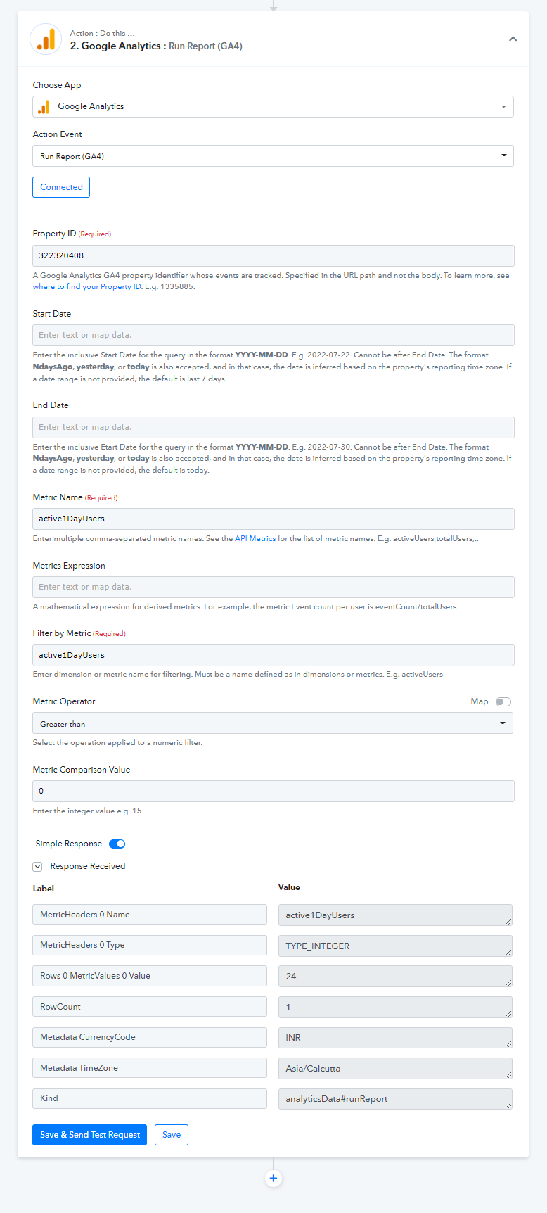

We have checked your account and found the workflow where you've used the Google Analytics: Run Report(GA4) action.
We tried to change metric filter condition and able to run it. Here is the screenshot attached.
You can pass multiple comma-separated metric names in the Metric Name field to be returned in the response.
PabblyMember3
1. You can make use or Date Time formatter: Current Date action to get the current date and map its response in the google sheet.
2. We didn't get any issue with Google Sheet action, Could you please try to load it in an incognito or private window of your browser.
It seems you have any extension enabled in your browser.
Try once, it should work. Also, we have made some update in the Run Report response so, you will get more simplified data in the response.
