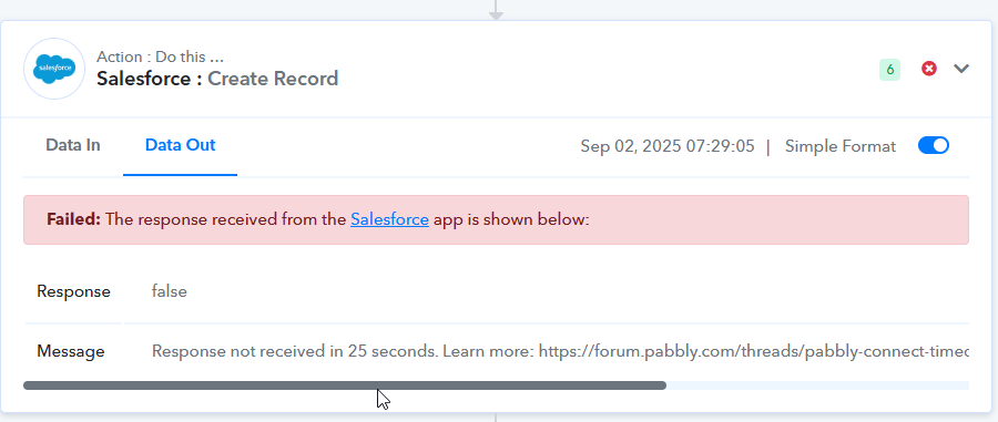

Since yesterday, Pabbly is not correctly parsing the response from Salesforce and this causes the workflow to not move forward.
We already tested the Lead generation via Postman and the response from Salesforce is correct.
Scenario:
We're sending lead via Gravity Forms to Salesforce.
Once the Lead is created, we add a delay and then try to update a field on the Lead.
But since Pabbly is not parsing the response correctly, then no Lead ID is captured and so the update also fails and breaks the workflow.
Task ID: IjU3NjUwNTZiMDYzNDA0MzA1MjZhNTUzNzUxMzE1MTYzNTQzNTBmMzMi_pc
Hello @nsdev,
It seems the record creation request is reaching Salesforce, but the response is not returned within Pabbly’s 25-second capture window. Postman waits up to 30 seconds, which is why it worked fine there. Please try re-executing a task history to see if it works now. If the issue continues, kindly share a screen recording of the test in both Pabbly and Postman. Do note, if Salesforce does not respond within 25 seconds, this needs to be addressed at the API end.
