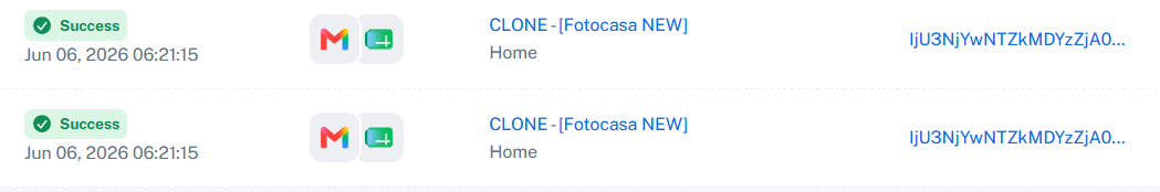

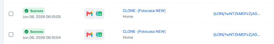

Tamosukas — Reply ·
IjU3NjYwNTZkMDYzZjA0MzE1MjZlNTUzMzUxM2E1MTZhNTQzMjBmMzQi_pc
IjU3NjYwNTZkMDYzZjA0MzE1MjZlNTUzMzUxM2E1MTZhNTQzMjBmMzUi_pc
IjU3NjYwNTZkMDYzZjA0MzE1MjZkNTUzMDUxMzM1MTZhNTQzNzBmMzki_pc
IjU3NjYwNTZkMDYzZjA0MzE1MjZkNTUzMDUxMzM1MTZhNTQzODBmMzAi_pc
IjU3NjYwNTZkMDYzZjA0MzE1MjZkNTUzNDUxMzU1MTZhNTQzNTBmMzki_pc
IjU3NjYwNTZkMDYzZjA0MzE1MjZkNTUzNDUxMzU1MTZhNTQzNTBmMzci_pc
IjU3NjYwNTZkMDYzZjA0MzA1MjY0NTUzNTUxMzQ1MTY1NTQzMjBmMzEi_pc
IjU3NjYwNTZkMDYzZjA0MzA1MjY0NTUzNTUxMzQ1MTY1NTQzMjBmMzIi_pc

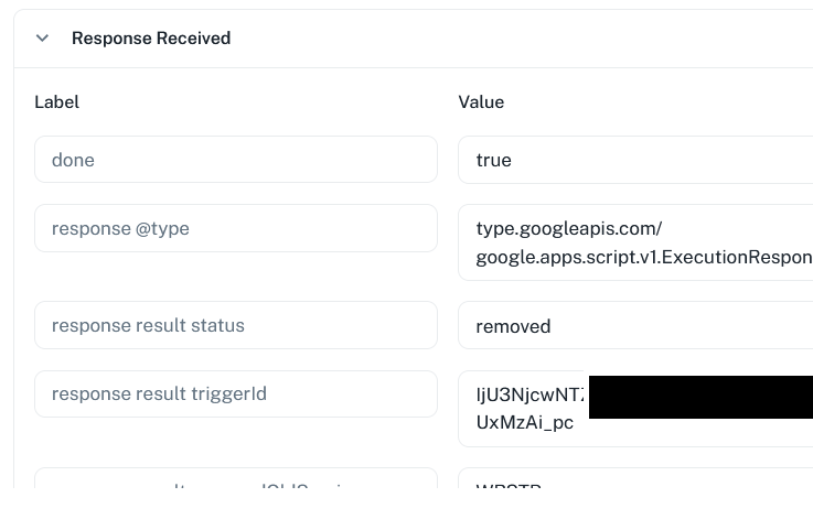

Previously I also had an issue where an old Gmail trigger ID remained registered in your system even after deleting workflows, and your team instructed me to manually remove the trigger.

To help investigate, here are some examples where exactly the same Gmail message triggered the workflow twice:
Message Id: 19e962e4a8f16218
Message Id: 19e9730b67a6334b
Message Id: 19e974d07d04454c
In each case:
  • Gmail Message Id was identical
  • ThreadId was identical
  • InternalDate was identical
  • Gmail Message-ID header was identical
I also added a Google Sheets deduplication check using Gmail Message Id, but duplicate workflow executions still occurred, which suggests that the same Gmail event may be reaching the workflow more than once.
