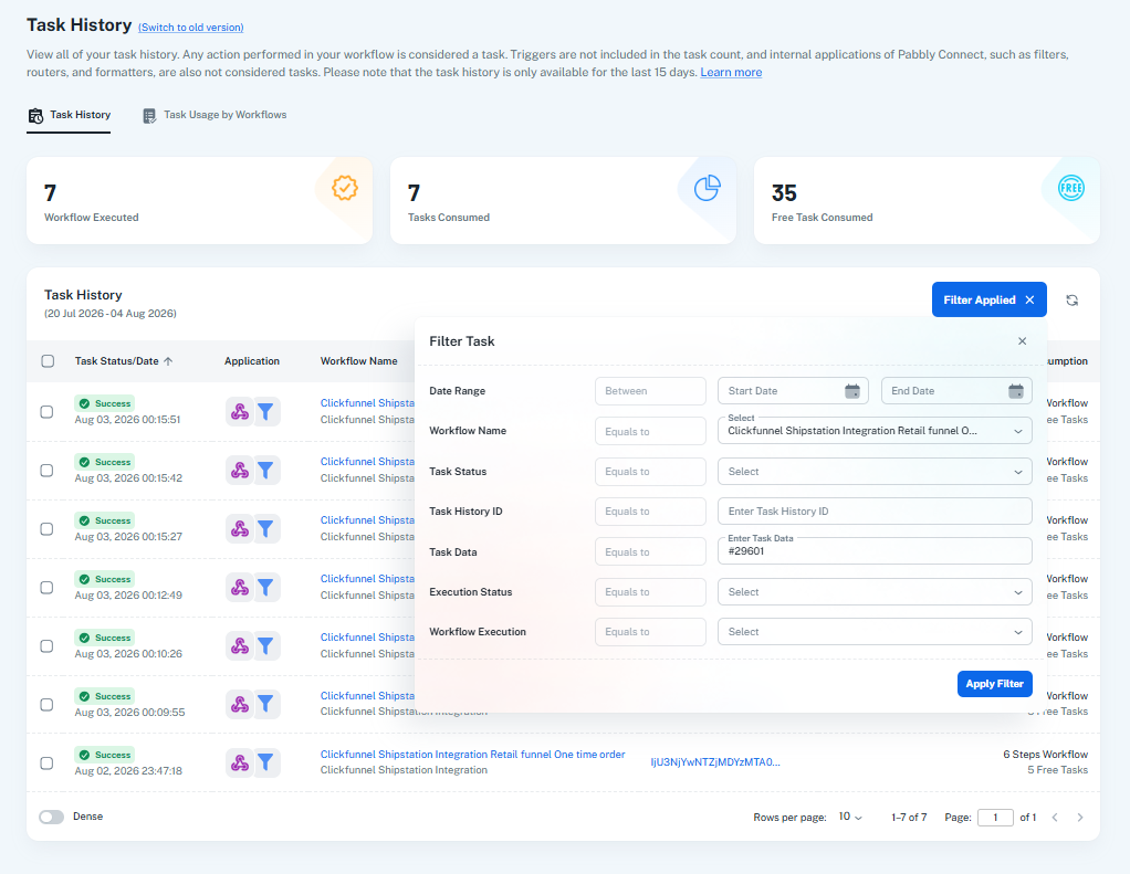

Status: Closed ยท Asked by April Bukofser on ยท 0 views
April Bukofser โ€” Question ยท
Order #29600 and #29601, and #29600 were created many times in ShipStation. want to know the reason for the issue. Please check into to it and let me know ASAP. Automation is - Clickfunnel Shipstation Integration Retail funnel One time order Account email is - [email hidden]
I have added 3 history id. but it was created 7 times.
So it should have more history id's
Pabbly Support โ€” Reply ยท
Hi April,
Thank you for providing the workflow details and Task History IDs. We have thoroughly investigated your workflow and Task History for both orders. Here is what we found:
1. Regarding Order #29601 (7 Executions)
We checked the Task History and confirmed that Pabbly Connect received 7 separate webhook requests from ClickFunnels for order #29601.
  • Each of these 7 task executions received an identical webhook response payload sent directly from ClickFunnels.
  • Because Pabbly Connect triggers automatically whenever it receives data from the source platform, it processed each incoming request as instructed and created the corresponding order in ShipStation.
Since the duplicate entries stem from ClickFunnels sending multiple identical webhook triggers for the same order, we recommend checking your ClickFunnels automation/webhook settings or reaching out to ClickFunnels support to see why duplicate webhook events are being dispatched for single orders.

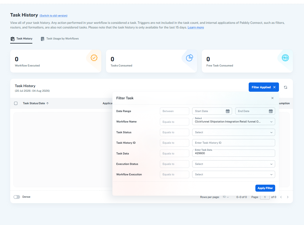

2. Regarding Order #29600
We searched your Task History specifically for order #29600 and found 0 task history entries. ClickFunnels did not send any webhook data to Pabbly Connect for order #29600, which is why no tasks were recorded or processed for it in Pabbly Connect or ShipStation.

April Bukofser โ€” Reply ยท
That's not the automation fires for #29600.
Hello April,
Thank you for the clarification.
Could you please share the workflow URL for the automation that is creating Order #29600? This will help us verify the correct workflow and investigate why the order was created multiple times in ShipStation.
Once we have the workflow URL, we'll look into it and get back to you with our findings.
Thanks and Regards,
Customer Success Associate,
Again this order is sent by clickfunnels. but pabbly has missed it. the same worflow. the details created by Clickfunnels - Delivery of event 1e0c3 to Clickfunnel Shipstation Integration Retail funnel One time order New
Some issue is there for sure at Pabbly end. Please look into it and help me resolve it ASAP
So, 2 orders were missed by Pabbly. Why is this happening? Please resolve it ASAP
Hi April,
Thank you for your patience while our team looked into this.
Our engineering team reviewed the Cloudflare server logs for your integration during the timeframe in question. The logs confirm that all webhooks delivered from ClickFunnels to Pabbly Connect were successfully received and executed with no errors.
Because no incoming webhook payload or request entry for Order #29600 reached our servers, the delivery issue occurred prior to reaching Pabbly's infrastructure. We kindly request that you review your webhook delivery service settings in ClickFunnels or reach out to ClickFunnels support to verify why event 1e0c3737-7a55-4e94-92d0-5267c9ba7cc2 failed to dispatch to the Pabbly webhook URL on their end.
Please let us know if you need any additional logs or details from our side to share with ClickFunnels support!
Hrishabh
๐ŸŒ Pabbly.com
๐Ÿ‘‰ Rate your support
The above screnshot was for order number #29610. which was sent by Clickfunnel. but Pabbly did not have any history for it. #29600 and #29601 were placed 7 times to shipstation. the same issue was with order #29607. CF dispatched. But Pabbly did not have any task history. Hope this make sense
Hello April,
As mentioned earlier, we have checked the Cloudflare server logs from our end and could not find any incoming webhook requests for the events you referred to. Since no webhook requests reached our servers, there is no corresponding task history available in Pabbly Connect.
This indicates that the issue occurred before the webhook reached Pabbly Connect. We kindly request you to check with the ClickFunnels support team and ask them to verify why the webhook events were not dispatched to your Pabbly webhook URL.
If they require any additional information from our end, please let us know, and we'll be happy to assist.
Anushka Sahu
