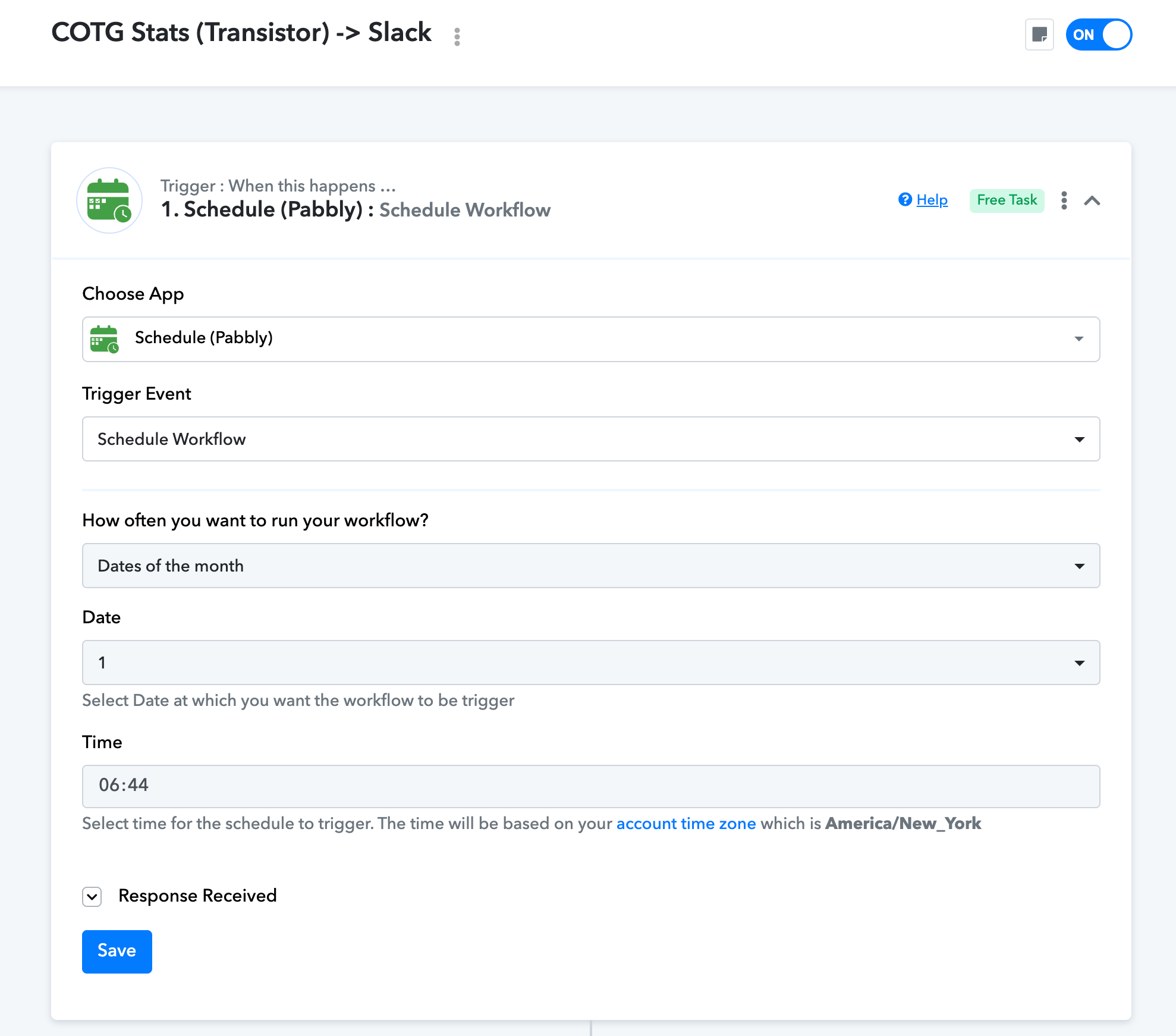

Workflow details:
  • App: Schedule (Pabbly)
  • Trigger: Schedule Workflow
  • Frequency: Dates of the month → Day 1
  • Time: 06:44 (America/New_York)

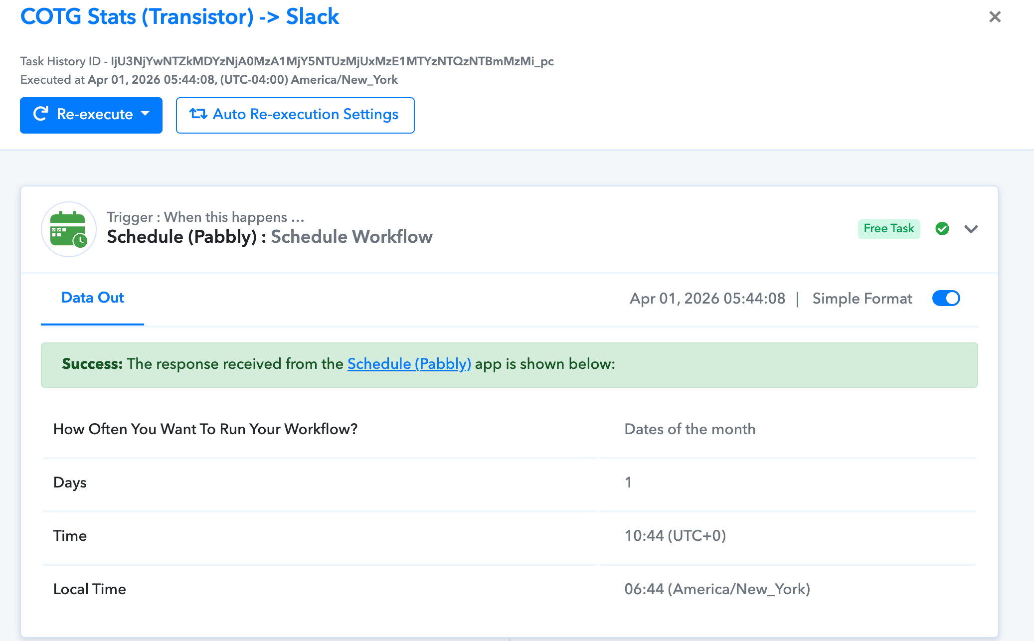

What’s happening:

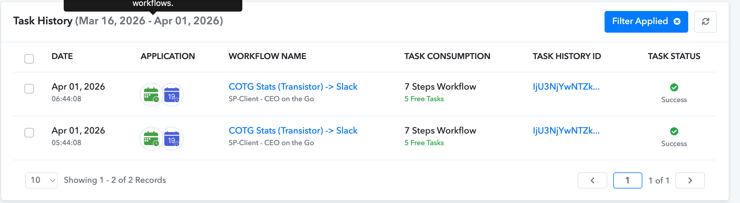

On April 1st, the workflow ran twice:
  • 05:44:08
  • 06:44:08
Both executions were marked as successful and ran the full workflow.
Expected behavior:
The workflow should only trigger once on the 1st of each month at 06:44 local time.
Additional context:
  • The schedule is set to 06:44 AM EST (America/New_York)
  • In the logs, I can see the time listed as 10:44 (UTC+0) / 06:44 (local), which seems correct
  • However, the extra run at 05:44 suggests there may be a duplicate trigger or timezone-related issue

thanks. should have included these screenshots too
Thank you for sharing the screenshots. We will get back to you with an update soon.

The double execution issue you encountered was caused by DST drift in certain regions. Our technical team will be making changes at the backend in the near future to fix this issue.
For now, you should not encounter the double execution issue, but you may need to adjust the time in your scheduler according to the DST shift so that the workflow triggers at your designated time.
