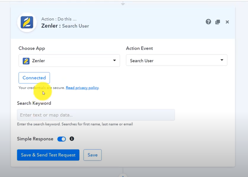

According to Pabbly official support video on YouTube, I've implemented a workflow that assigns a Zenler course to a new or existing student.
The workflow uses a search keyword function to identify if the student is already existing. This seems to be a flawed method since it can return more than one hit.

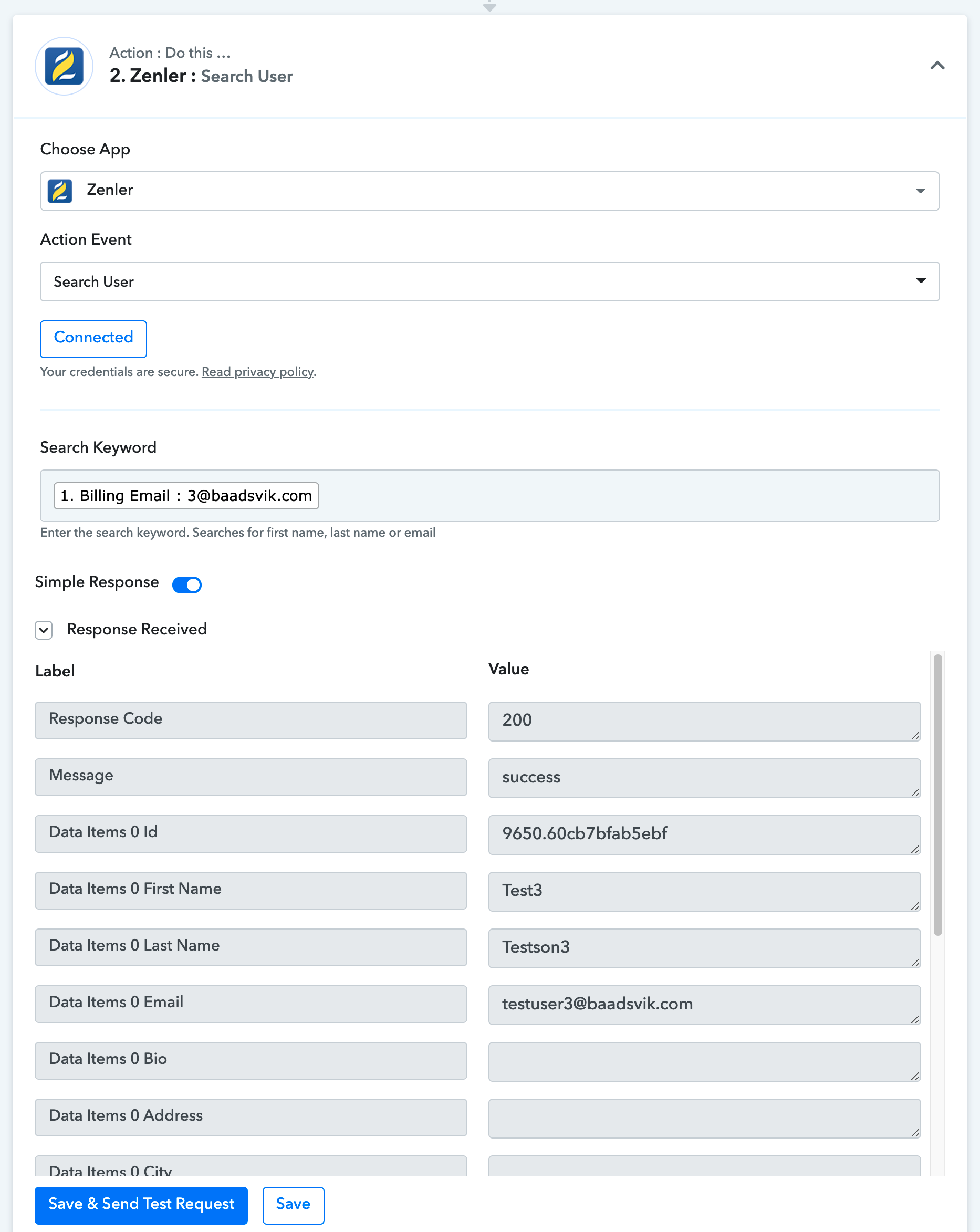

I am using the exact same procedure except I'm using WooCommerce. However, as you can see in the below screenshot, the search is obviously not searching for the exact email address, but rather it seems to return the first user with an email address that contains the search phrase. A search for email: [EMAIL][email hidden][/EMAIL] returns [EMAIL][email hidden][/EMAIL].
It might very well be an issue with the Zenler API as you say, but nevertheless, until this is corrected it renders the method as described in the video useless.
