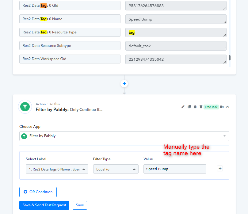

Hey @emeraldlake
How do I get Pabbly to send an email only when the tag is first applied?
To only process the workflow when a particular tag is applied you can use the Filter action step. Please refer to the following screenshot.

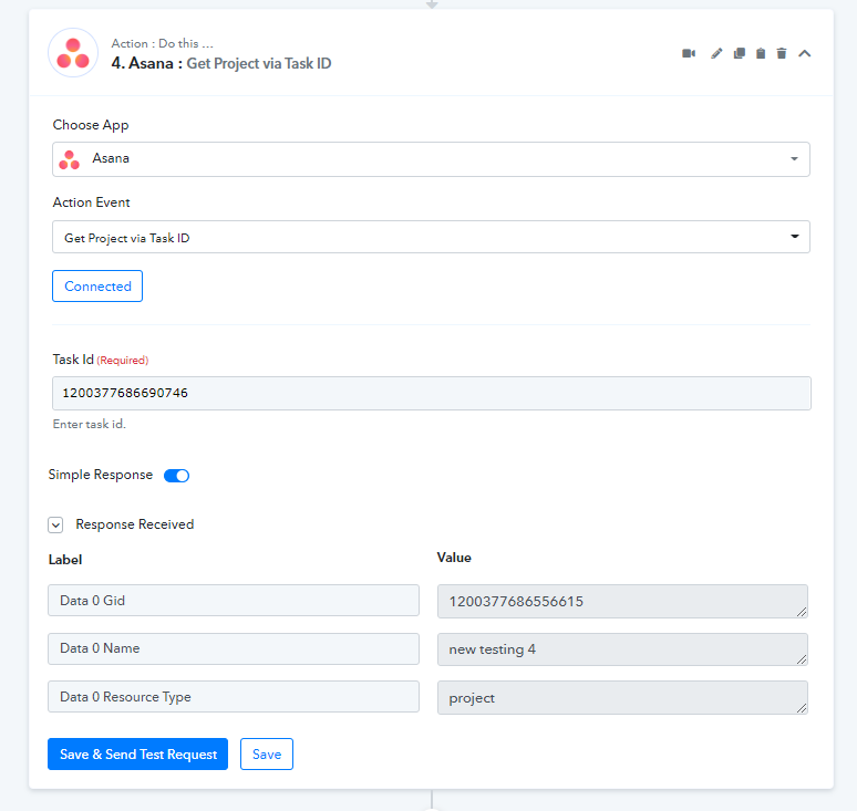

And how do I identify the project the task is part of?
You can use the "Get Project via Task ID" action step to check the project name from the task Id.

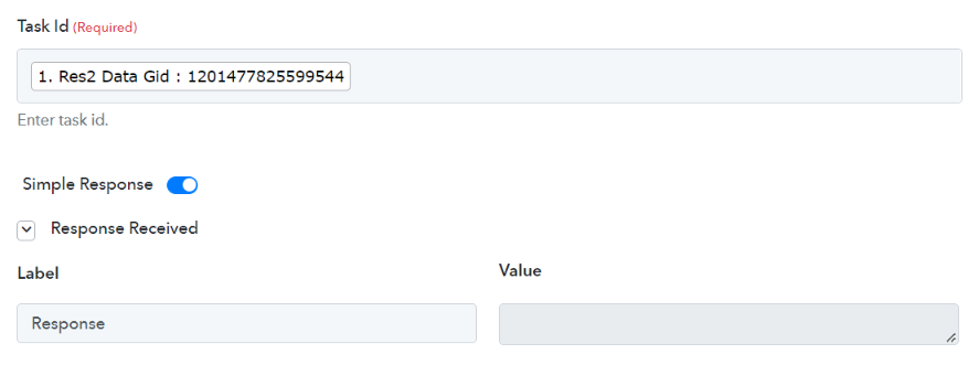

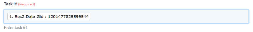

It looks like perhaps you manually typed in the Task ID. Is that correct? I'm not certain how that would work since the task would be different each time this workflow is triggered.
I tried mapping the Task ID, but the response was blank.
Hey @emeraldlake
You have to map the Id from the trigger response, I have manually typed the Id just for an example.
emeraldlake — Reply ·
Okay. That's what I did in the Get Project via Task ID step, but the response when I tested it was blank.

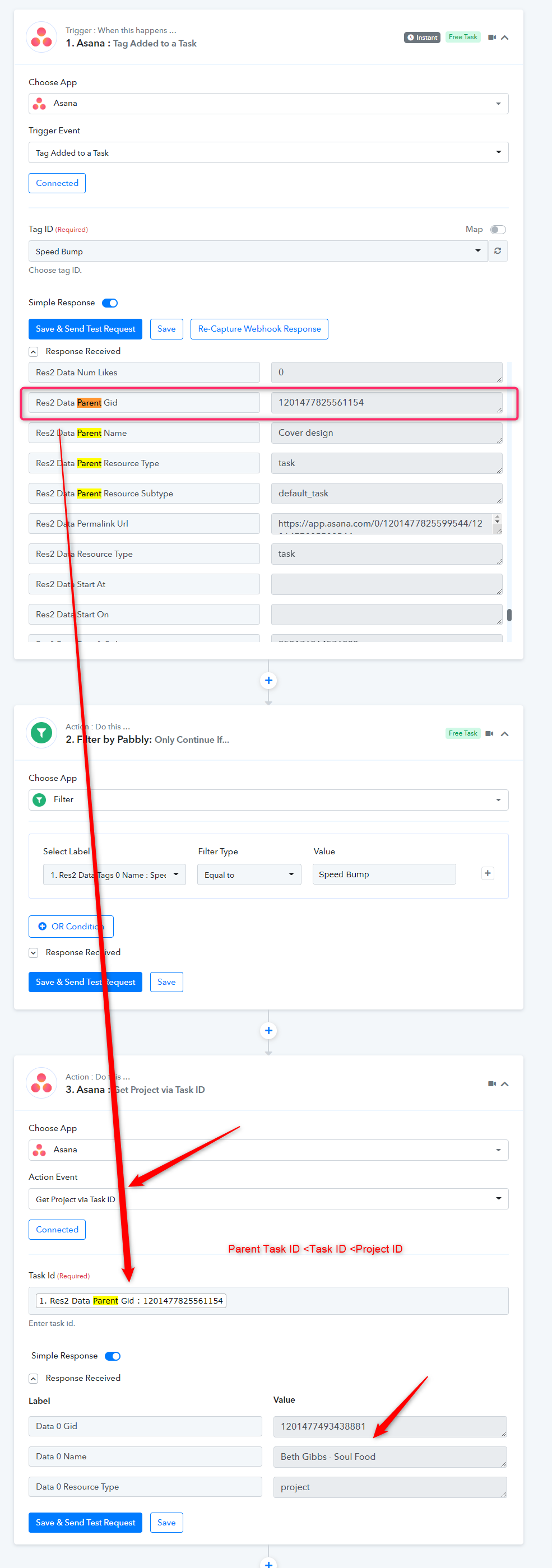

In Asana, there are tasks that have subtasks. Tasks are associated with a specific project, but for whatever reason, subtasks don't inherit the project from the task. So, if the task that's being reported on is a subtask, is there a way to look for the project of the parent task if the current task's project is blank?
Please use the "Get Project via Task ID" action step to check the project name from the task Id.
Sorry, but that's not what I asked... If Task A is a subtask of Task B (the parent task), most likely, the project ID of Task A is blank since subtasks aren't associated with projects by default in Asana.
So, my question was, if the Project ID for Task A is blank, can Pabbly then look for the Project ID of Task B instead?

Hey @emeraldlake
Please refer to the following screenshot once and then try again, as we can resign the "Get Project via Task Id" action step and it will get the corresponding project from the parent task Id.
Though we have added the action step in your workflow accordingly.
