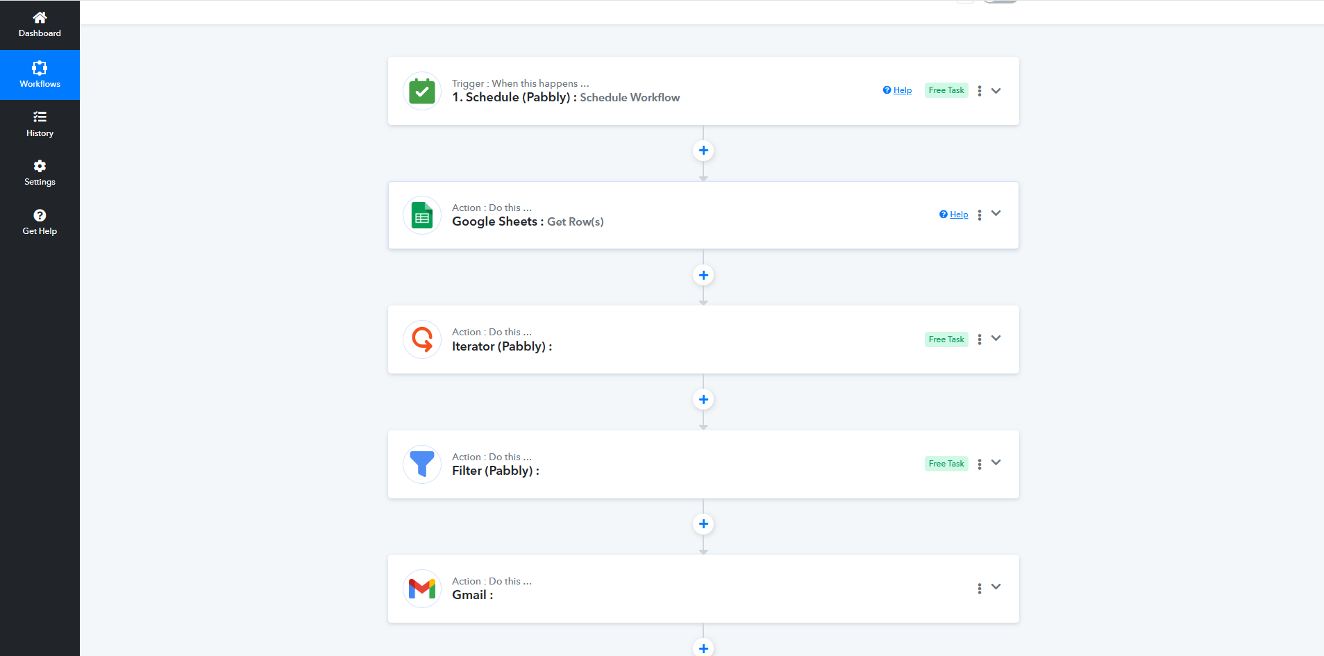

I have reached as far as Schedule (pabbly) to run at 2pm --> Google sheet getRow() which returns all rows.
Anushka Sahu — Reply ·
Based on your scenario, here's how you can set up the workflow in Pabbly Connect to email task owners about overdue tasks daily at 2 PM:
  1. Trigger: Use the Scheduler module to run the workflow daily at 2 PM.
  2. Get Data: Use Google Sheets → Get Rows to fetch all tasks.
  3. Iterate Rows: Use the Iterator/Loop module to go through each task.
  4. Filter: Use a Filter module to check if the Task Delivery Date > Today. You can use the Date/Time Formatter to ensure consistent formatting.
  5. Send Email: If the task is overdue, use the Gmail/SMTP module to send an email to the assigned task owner.
Ensure dates are formatted as yyyy-mm-dd in both the sheet and filter, and optionally, maintain a status column to avoid duplicate emails.

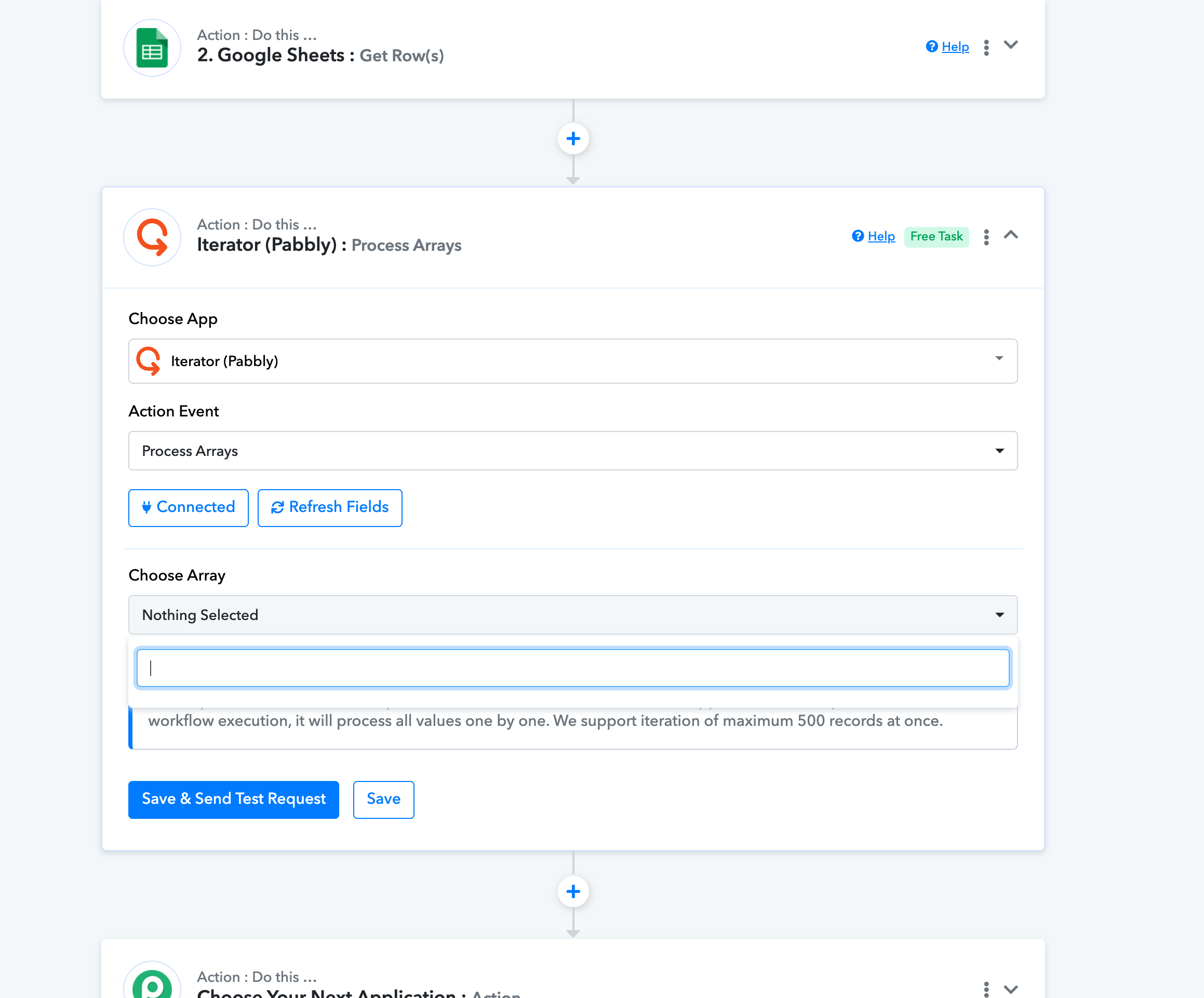

My problem remains the same as before, that the iterator module does not show the values from the previous GetRow(s) step. Please see screenshot.

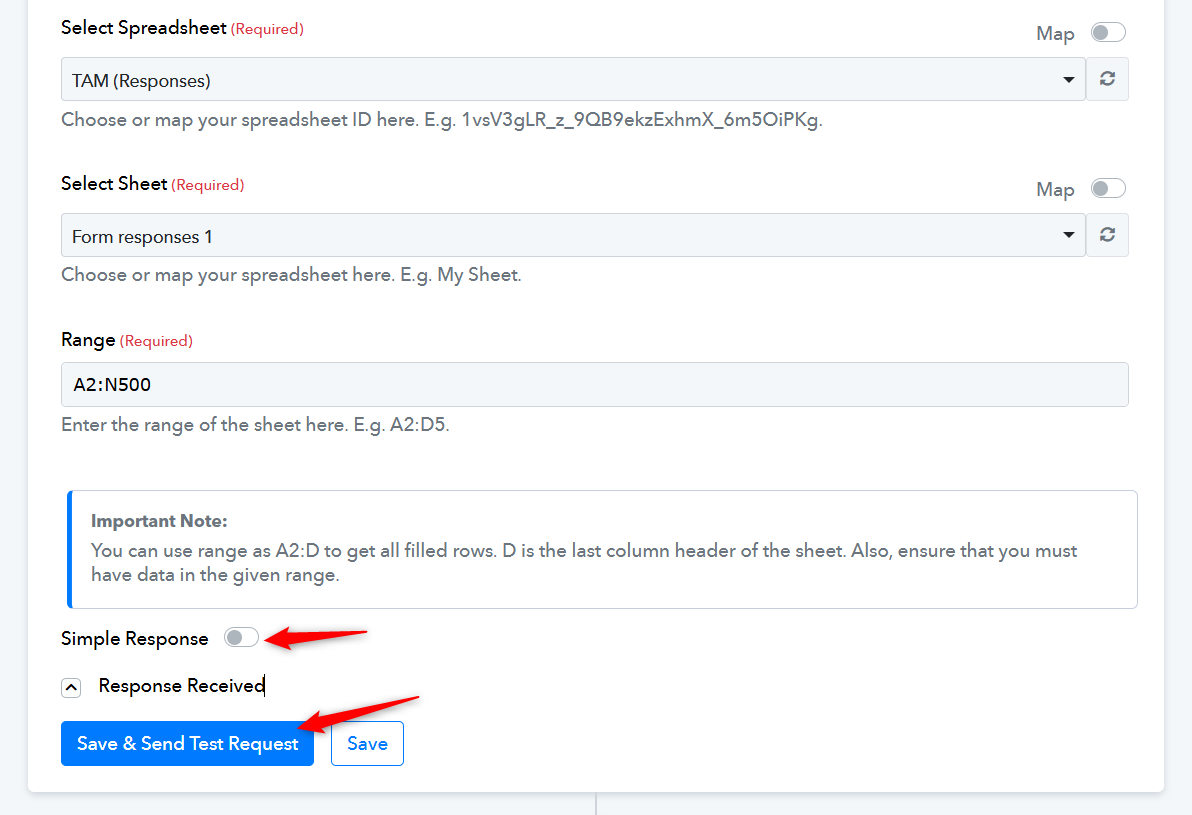

You need to disable 'Simple Response' and then click the 'Save & Send Test Request' button. The data will start appearing in the Iterator module.
youtube.com/watch?v=STZX_BVtpy8:886
DevangTL — Reply ·
this worked. Thank you very much.
