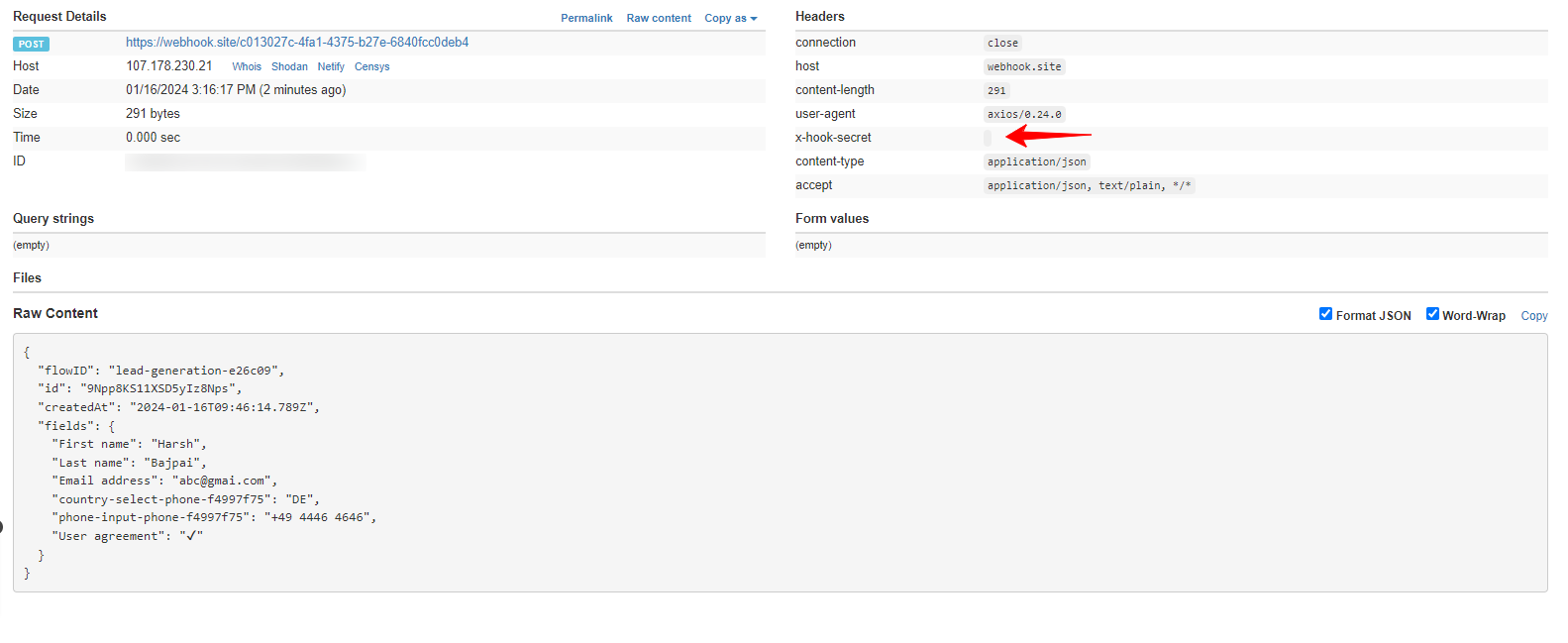

Thank you for the efforts you are putting on. We have noticed that you are sending "x-hook-secret" in the header of the webhook.site.
We have attached a screenshot for your reference. Is there any specific reason for sending "x-hook-secret"? Can you guide us on this.

Hi @Harsh Bajpai, in some scenarios our hooks will have a x-hook-secret. It likely shouldn't be there when it's undefined though. This shouldn't affect your implementation though no? I look into only adding the head conditionally and not just empty

Even though we are sending it without the "x-hook-secret key," it still appears in the header. Could you please remove it by sending in the headers if it's feasible for you? In this way, Pabbly Connect can capture the live response. Your efforts are greatly appreciated.

If we receive the 'x-hook-secret' header in any response, we consider it as confirmation that this response is for webhook validation. We return the same 'x-hook-secret' header along with the 'HTTP/1.1 200 OK' header.
This ensures that the webhook URL is validated and ready to receive webhook responses, assuring the third party that they are sending the response to the correct URL.
But the x-hook-secret is coming blank without any value from HeyFlow. Do you send x-hook-secret just for webhook validation?
