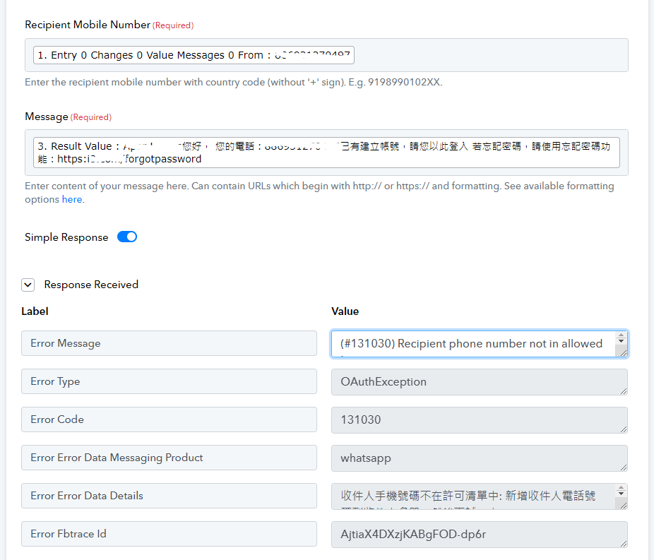

I am using the WhatsApp Cloud API: Send Text Message function to send messages to customers.
However, I encountered an error (#131030) which states "Recipient phone number not in allowed list."
My WhatsApp Cloud API is already set up and online, but I'm still encountering this error.
I prefer not to use template messages. Could you please provide guidance on how to resolve this issue?

Thank you for your response.
However, as shown in my workflow, my process involves responding with messages to customers based on the content of the WhatsApp messages they send.
Doesn't this meet the requirement of "initiated by the end-user on WhatsApp"?
BTW, I try to use 'Send Template Message' also show the same issue (#131030)
In fact, I did initiate the conversation from the customer's end, but the same error still appears.
(Furthermore, even when I switched to using template messages, the error remains the same, which seems illogical.)
Is there any specific configuration required on the WhatsApp Cloud API side to address this issue?
It appears you might not have configured your Phone number with your WhatsApp Cloud API incorrectly or might have done some changes to your WhatsApp Cloud API account and because of that, it might not be sending messages.
So, please reconfigure your WhatsApp Cloud API with your main phone number and avoid using the test phone number.
