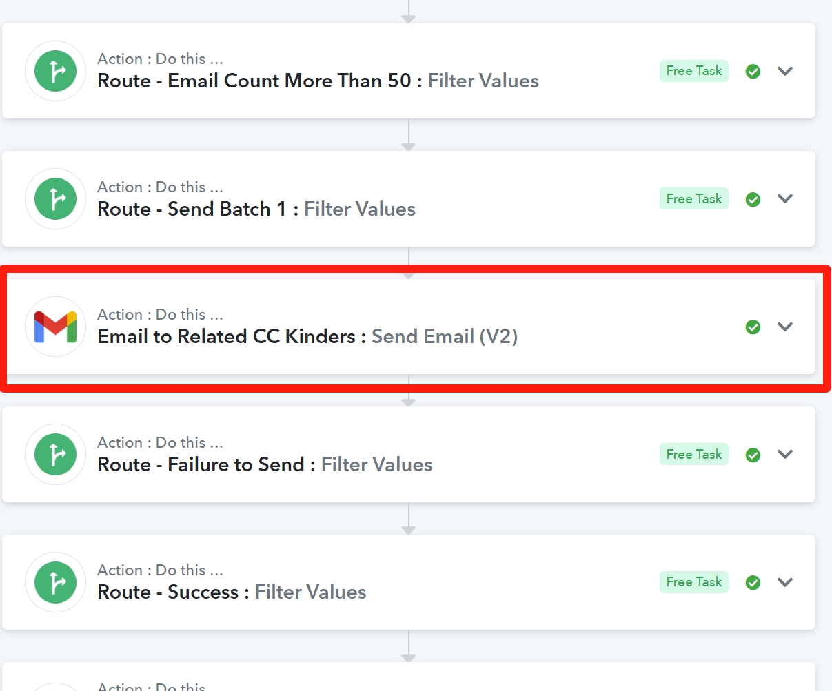

We have restricted to 50 emails address per email. What could still be the cause?
2 days we have refined from sending using Pabbly work task, but sending directly from Gmail. AFter 2 days on the first attempt, there's only 600 email address, split 50 email address each.
If you check this Task ID: IjU3NjUwNTZmMDYzZjA0M2Q1MjZjNTUzNjUxMzc1MTZiNTQzNjBmMzIi_pc, clearly there's only 356 email, and we have split the task into 20 sets.

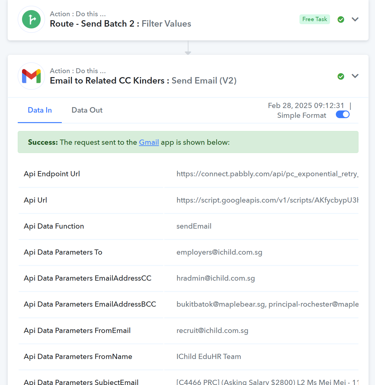

Further to the above, we have tried this morning at 920am Singapore time.
Refer to Task History ID - IjU3NjUwNTZlMDYzNjA0MzI1MjZhNTUzNzUxMzQ1MTYyNTQzNzBmMzEi_pc
The first 50 emails was sent out. Subsequently error.

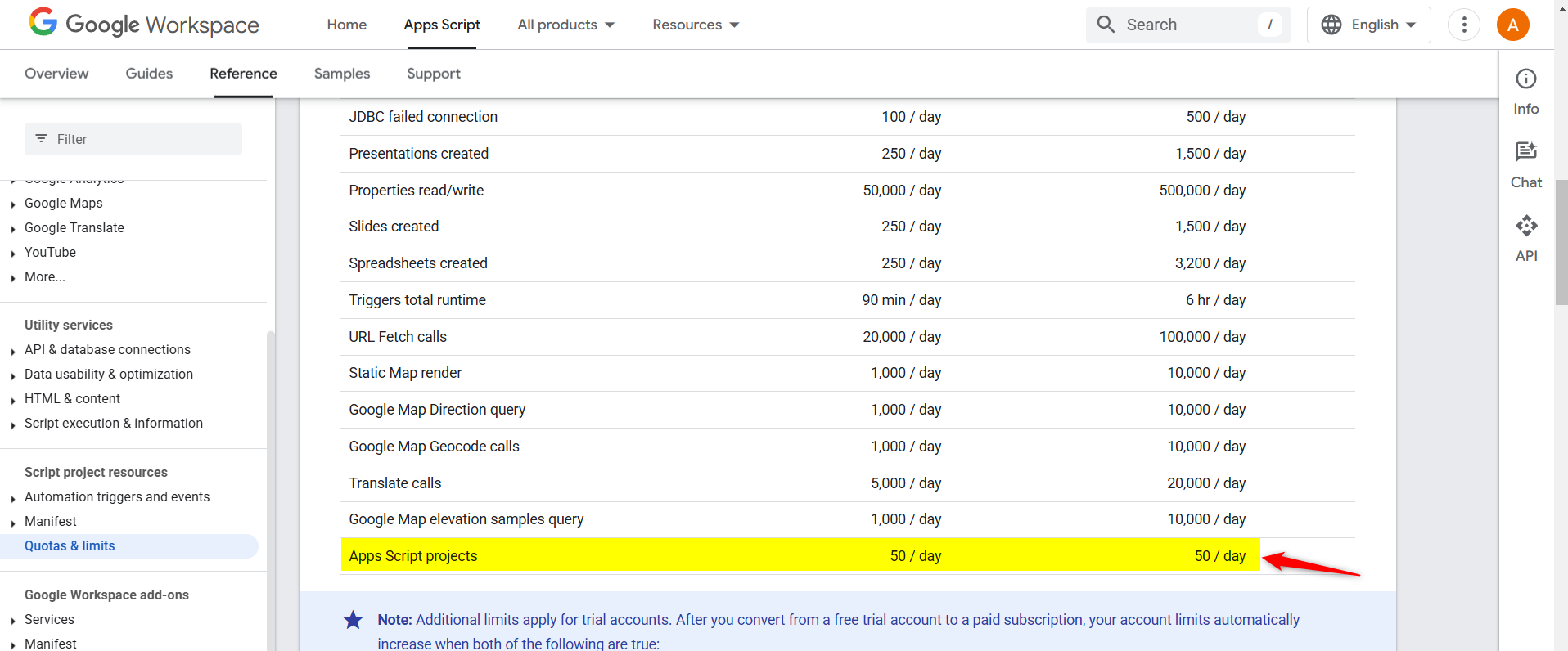

Hello @ichilddev,

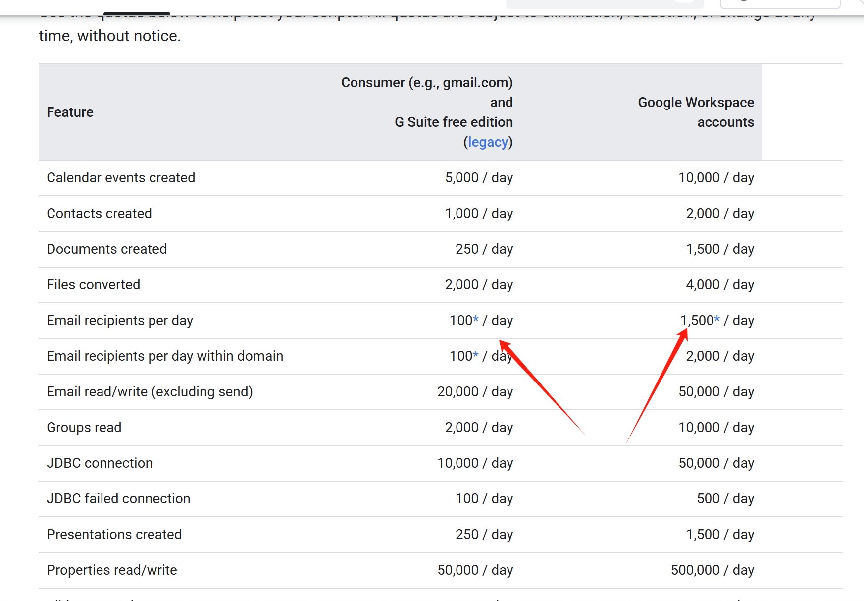

It appears that Gmail has recently updated its quota and sending limits. As per the latest changes, the sending limit for App Script-based projects has been reduced to 50 emails per day. Due to this restriction, you may only be able to send the first few emails successfully before reaching the limit.
IChild Company — Reply ·

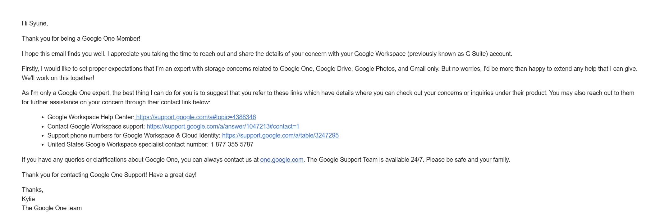

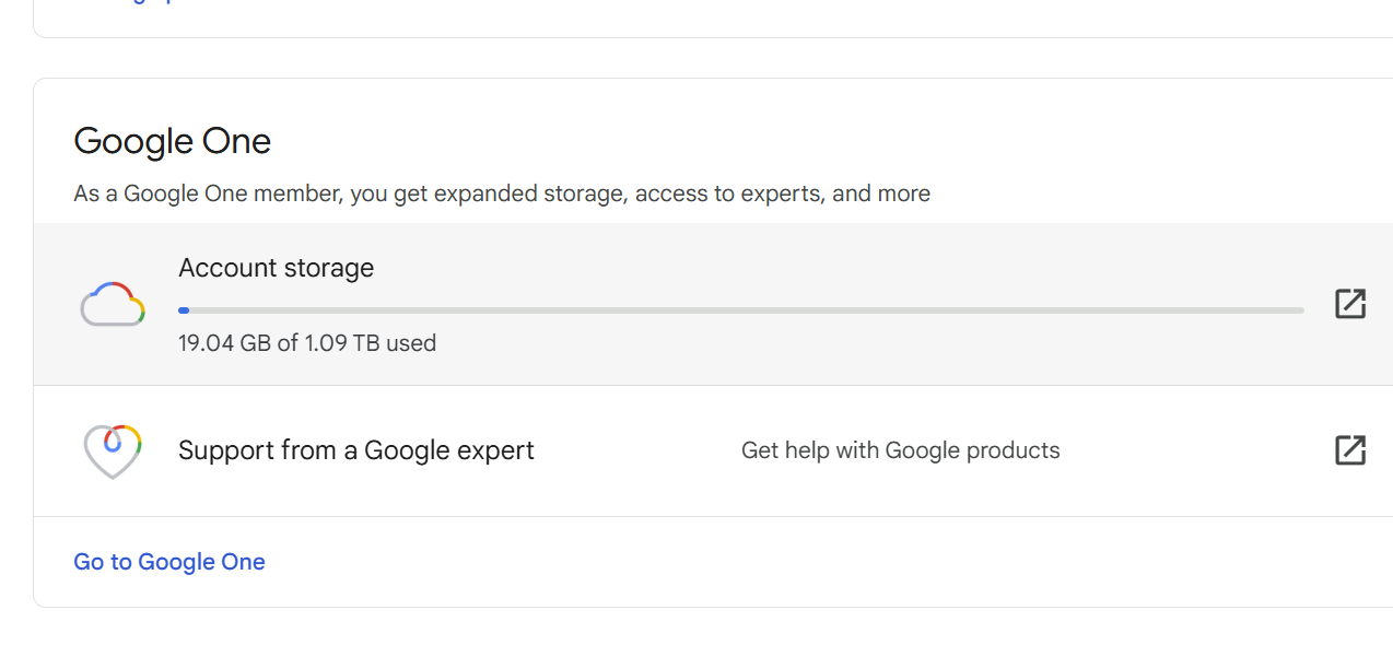

Hi. How do i increase this allowance?
I have checked with google one customer service, Not sure what to ask them.

Hello @ichilddev,

You will need to contact Google's support team regarding this concern.
2. This Sending Limit is based on my google account that connect to the google api in the Pabbly API task?
Yes, the sending limit is specific to each Google account.
Are you able to direct me to the page you saw this update so that i can check with google support.
Appreciate.
You can find the quota limit here on this page.
https://developers.google.com/apps-script/guides/services/quotas

Hello @ichilddev,
50 scripts a day = 50 emails a day?

Please take a SERIOUS look at the task error ID. The task ONLY send 1 email with 50 email recipients (which is allowed in the quota limit) using 1 script call (1 task per call right? )
Hello @ichilddev,
As per the quota limit, you can only send emails to 50 recipients per day. Even if you are sending one email with multiple recipients, the total recipient count still applies to the daily limit.

Hello @ichilddev,
Let us know if you need further clarification.
On the same page : https://developers.google.com/apps-script/guides/services/quotas
The recipients per day with Google WorkSpace is 1500 recipients per day.
Aside to your explanation, do you mean whenever we use Pabbly Google Send Email V2, each recipients will invoke 1 SCript Call? It does not make sense!
One task equivalent to 50 scripts call???
