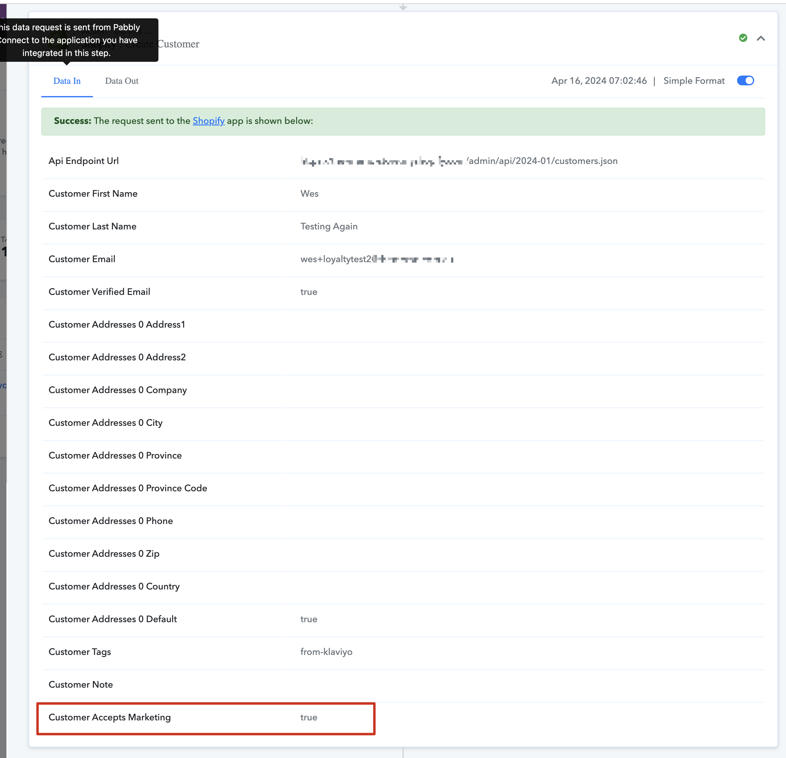

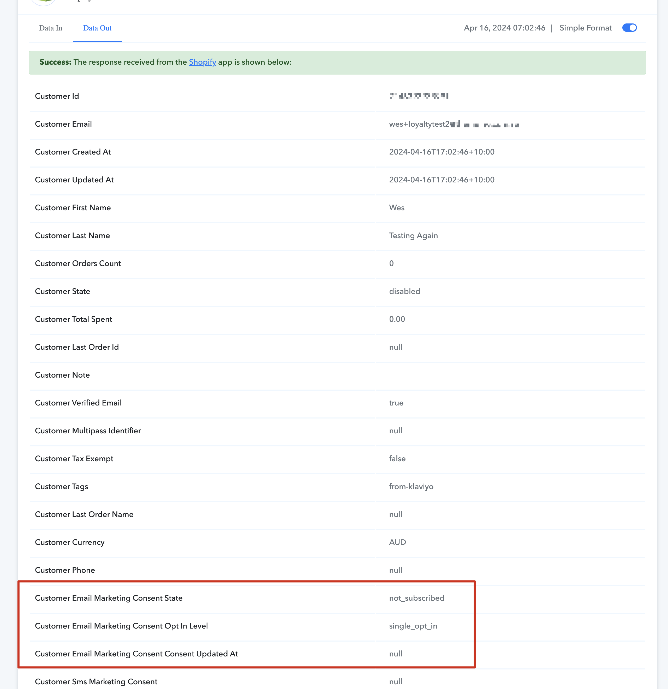

I have a workflow set up that attempts to create a customer in Shopify with the 'Accepts Marketing' set to true. The customer creation is fine. However, the accepts marketing flag is not being set. I think it's partially to do with the fact that Shopify has marketing consent split into email & sms now, and the Pabbly Connect setup only sending a 'generic' flag.
See difference below in the Data In vs the Data Out. You'll see that the response data has separate fields for capturing email & sms consent, with the email consent fields being different to the Data In. Can we please update the Shopify Create Customer event to facilitate this?

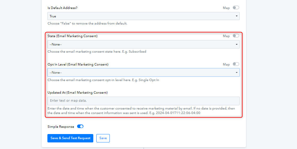

Hey @wesleyr
We have successfully updated the Email Consent field and the added customer metafields as per your requirement. Kindly test the same and let us know in case you face any issues.

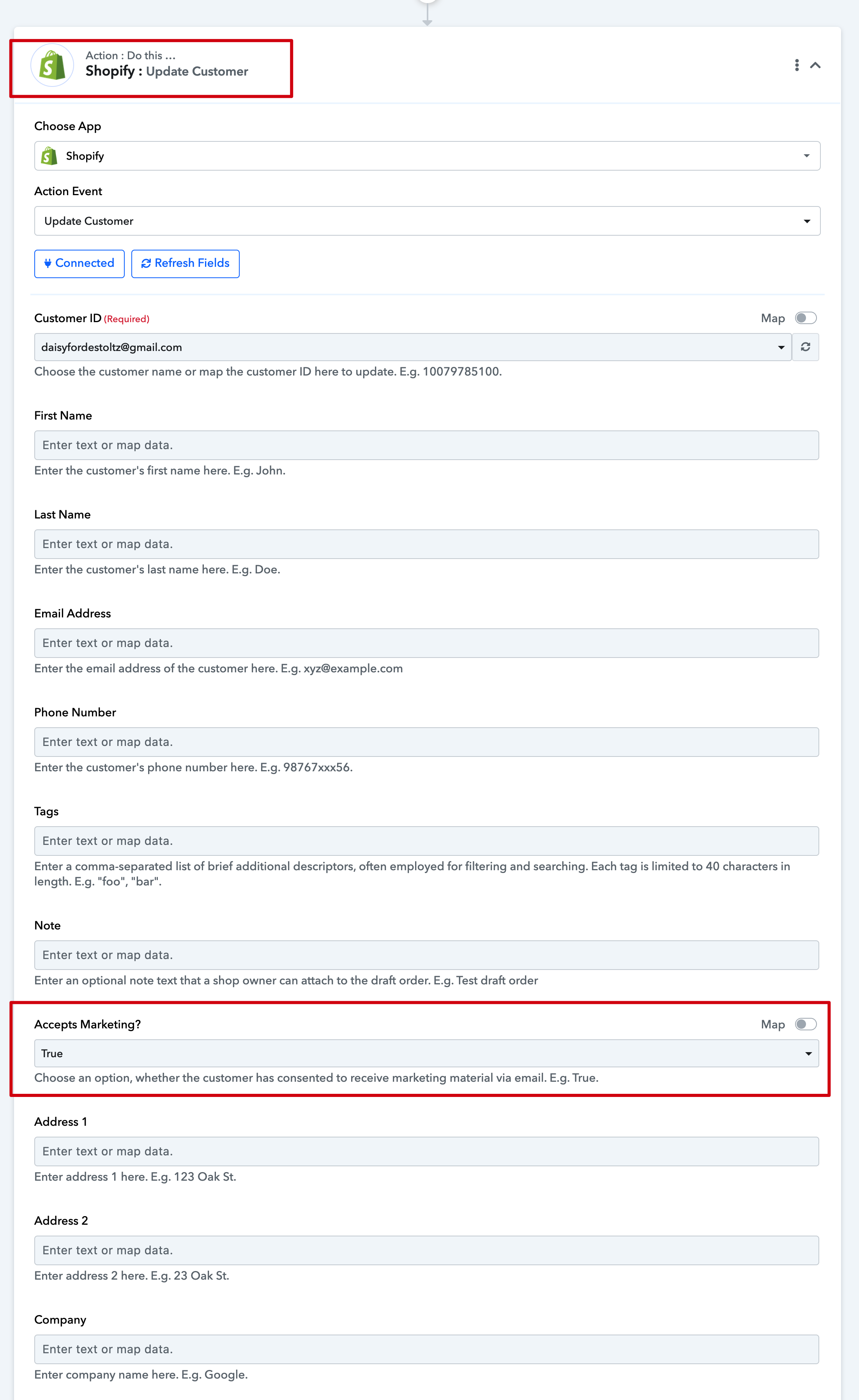

Hi @Luv - is it possible to also update the Update Customer action to also support the new Email Consent fields? Currently we only see the Accepts Marketing boolean field.

Hey @wesleyr
We have successfully updated the action step "Update Customer" action step for Shopify. Please refer to the image below,

Hey @wesleyr
Excellent, thank you @Luv . I will test today and come back to you if there are any issues.
