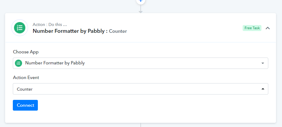

@Neeraj Getting stuck trying to implement your suggestion.
Can't find a "counter" app/action in the list, is this part of the iteration app? Still confused after watching the youtube tutorial. Is there a tutorial similar to my use case i can follow?

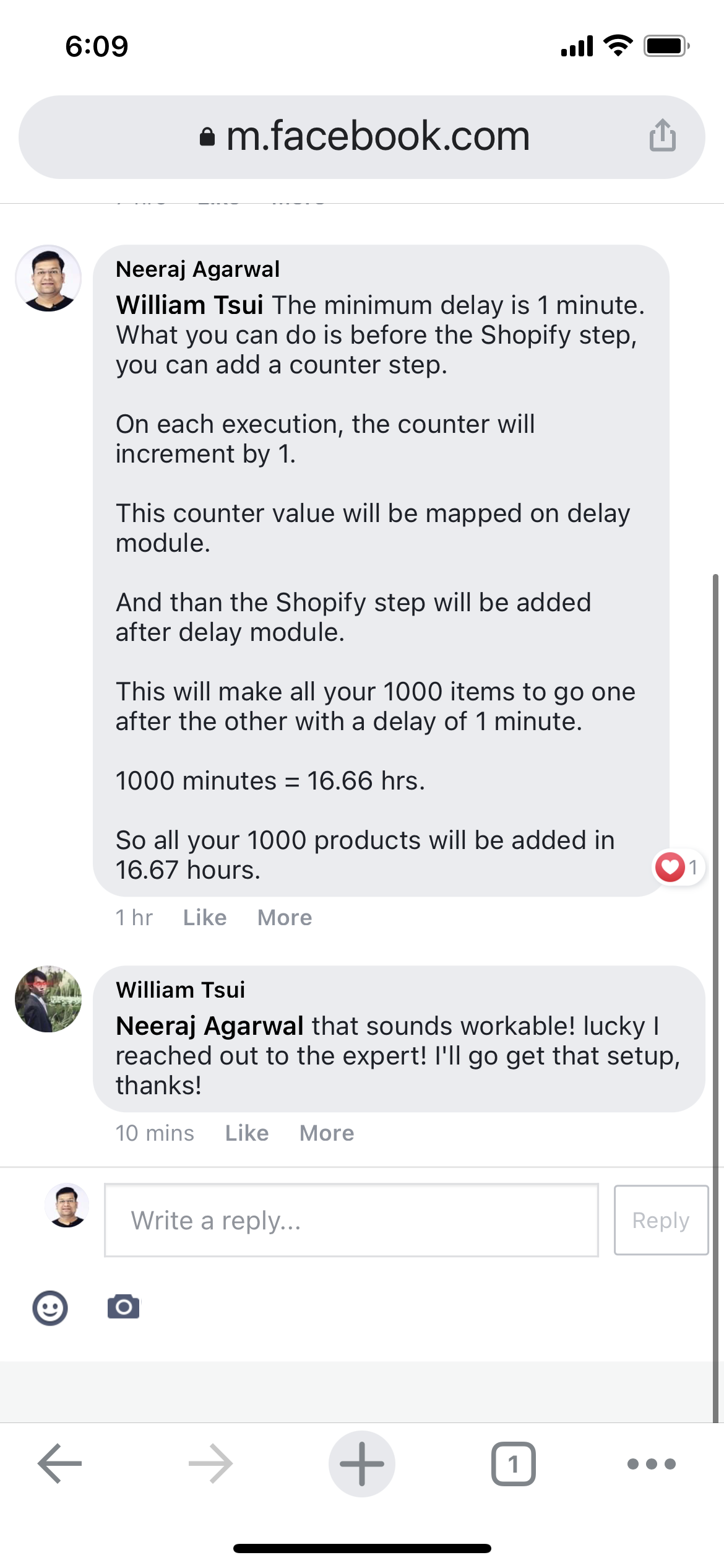

Neeraj Agarwal — Reply ·
Check this video I did for you. This should give you an idea of what I was talking about.
youtube.com/watch?v=_P7jNKZ34YI
The video will render in few minutes and then you can watch it.
