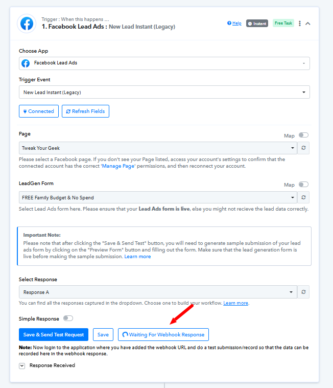

Hello. My FB Leads to Mailerlite connection was working quite nicely until it wasn't. Not sure what has changed. Re-authentication did not work. I only have the single workflow in my account. FB portion is working but sending data to ML is where things have gone south.
Halp! Thanks so much.
Here is the latest failure:

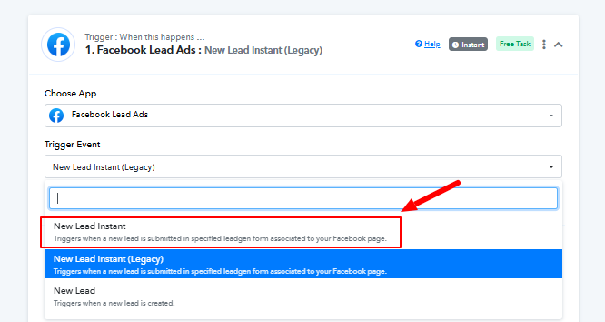

Upon checking, we noticed that the trigger has been waiting for a response for some time which may be causing the issue. However, the trigger you were using has been shifted to legacy.
We recommend switching to the New Lead Instant trigger instead. Please set up a new workflow using Facebook Lead Ads: New Lead Instant as your trigger and let us know if it works fine for you.
