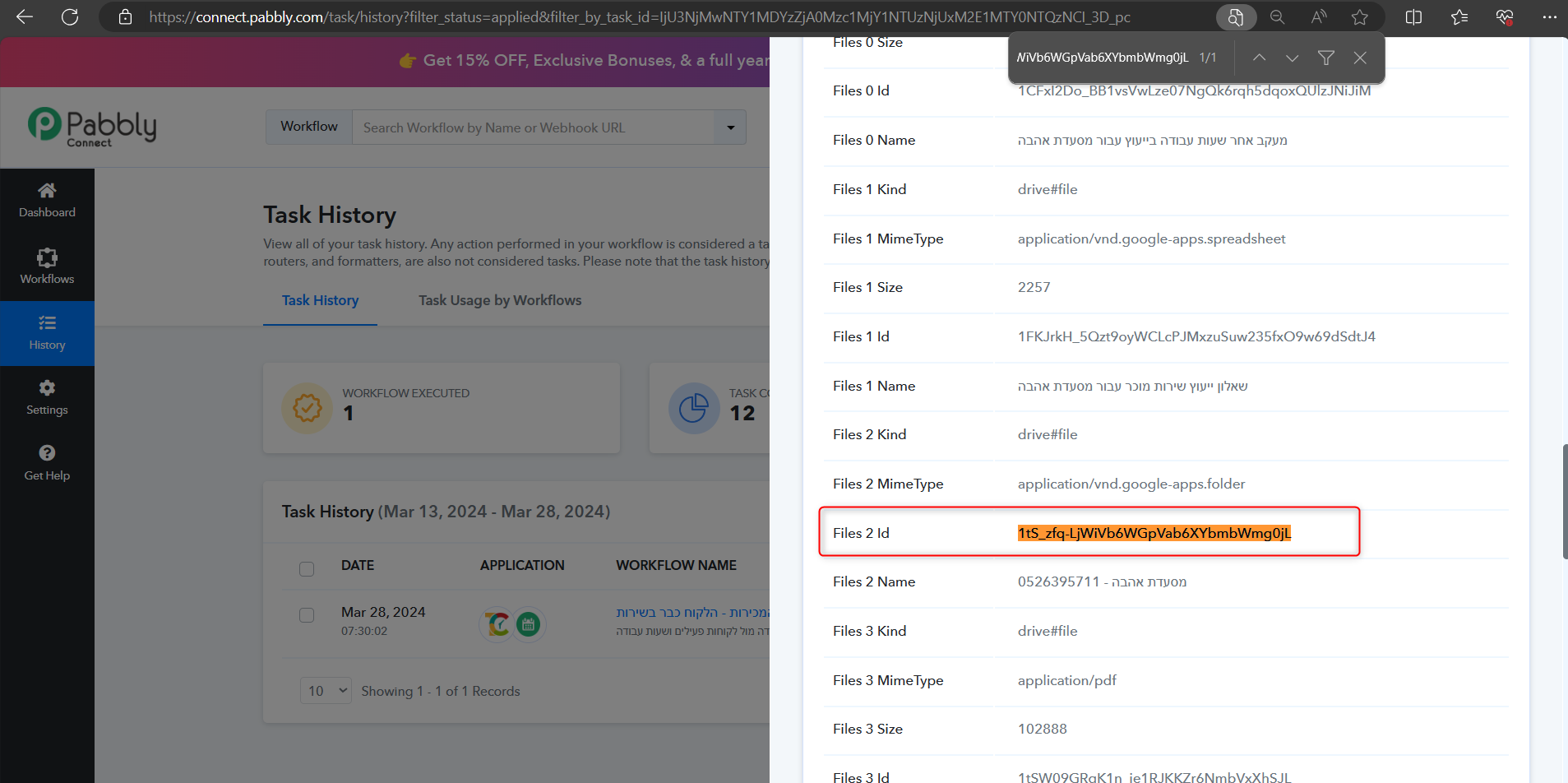

By the way, in order to find the ID of the Spreadsheet I tried to run two different action steps like: Global search and Search a spreadsheet. In both cases, it found the Spreadsheet ID. But when I tried to add a row by using the same ID I found in both action steps, it didn't work. In the history of this workflow I got an error: 400.

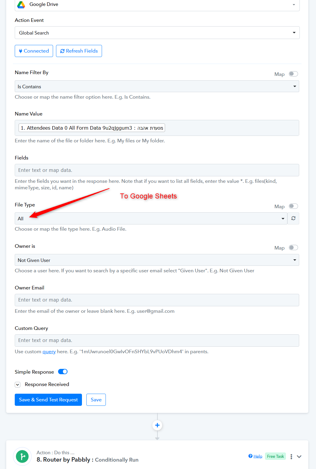

Hey @Ori D
It seems that the spreadsheet ID you've mapped from the specific key is receiving the folder ID instead of the spreadsheet ID. As a result, the "Add multiple Row Values" operation is affected.
Our recommended solution is to select the file type as Google Sheets only. This option will limit the associated values with the name from your Google Drive to only Google Sheets.
