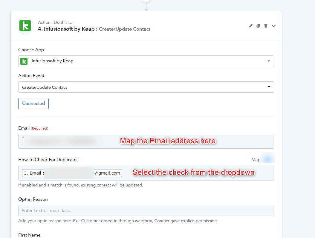

Looks like someone from the support team has updated the workflow but the email is showing up as invalid when I test it.
Hey @annaosherov
1. Create/Update a contact who has registered for an event in Eventbrite in Keap
As we can see from your workflow, you have passed the email address in the wrong field, kindly select the "How To Check For Duplicates" field from the dropdown.

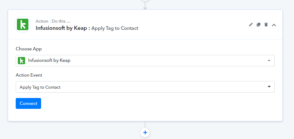

2. Add a new tag to that contact
To add tags to the contact you can use "Infusionsoft by Keap: Apply Tag to Contact" after the Infusionsoft by Keap : Create/Update Contact action step.
