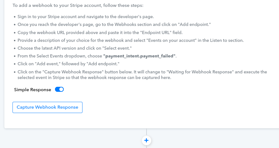

Thanks, but after doing these steps, the webhook is stored on stripe, but no response is grabbed. How do I get sample data in order to be able to use the response of the events (payment succeed and payment failed) in next step? Which trigger events of pabbly monitors checkout.session.expired and invoice.finalization_failed stripe events?

I have created the payment button (after adding the webhook on stripe), but pabbly never recives the stripe respnse. I tied in both workflows, the one with payment failed and the one with payment succeeed. Is there any way to debug the webhook?

The video on how to troubleshoot only says that a webhook.site endpoint. I added the webhook in Stripe following exactly the instructions shown in the automation
And stripe does not send any data. I showed the configuration in the video. You don't need the audio, since the video is showing how the webhook is configured in stripe. What's wrong and what should be changed?
