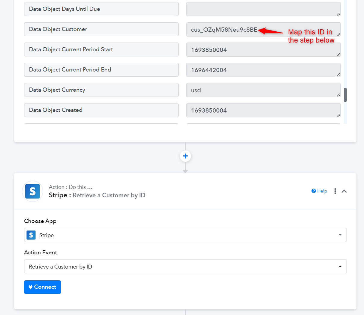

i'm not seeing a client name or an email when I try to copy the Trello board in the stripe info
Please try using Stripe: Retrieve a Customer by ID action event by mapping the customer ID from the trigger step.
Watch this video to understand how you can setup Stripe: Retrieve a Customer by ID action event. Ignore the trigger application and use case.

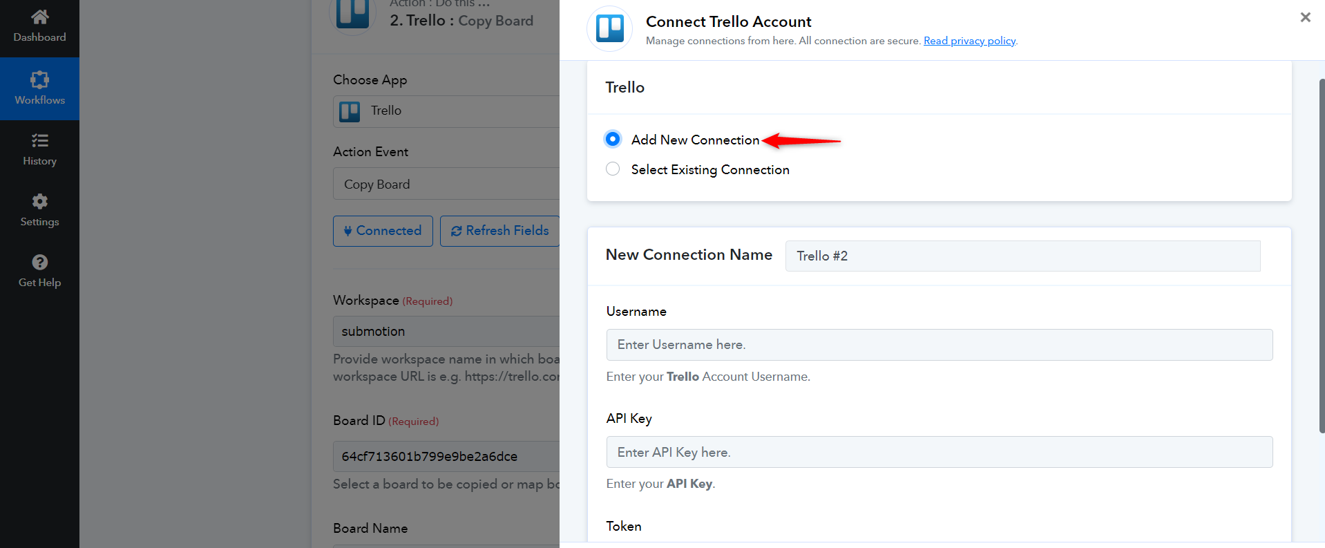

And when I do try to just write something there so I can start Troubleshoot im getting an "unauthorized org access" not sure what that means
For this, please establish a new connection with your Trello account.
Watch the video shared below to understand how you can make a new connection with your Trello account.
youtube.com/watch?v=FYXIpg6ZZVw:328

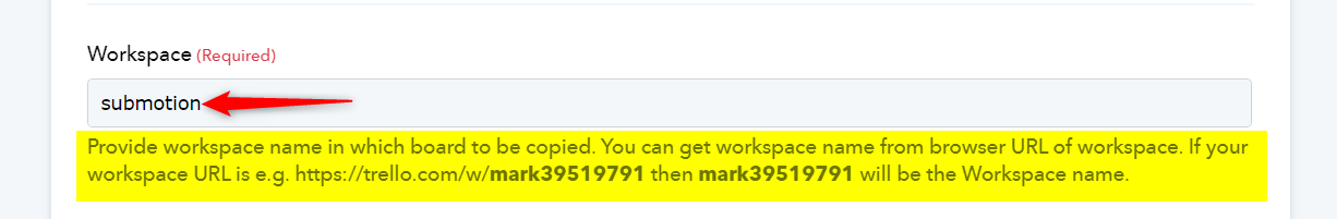

Also, confirm whether your Workspace is correct or not.
