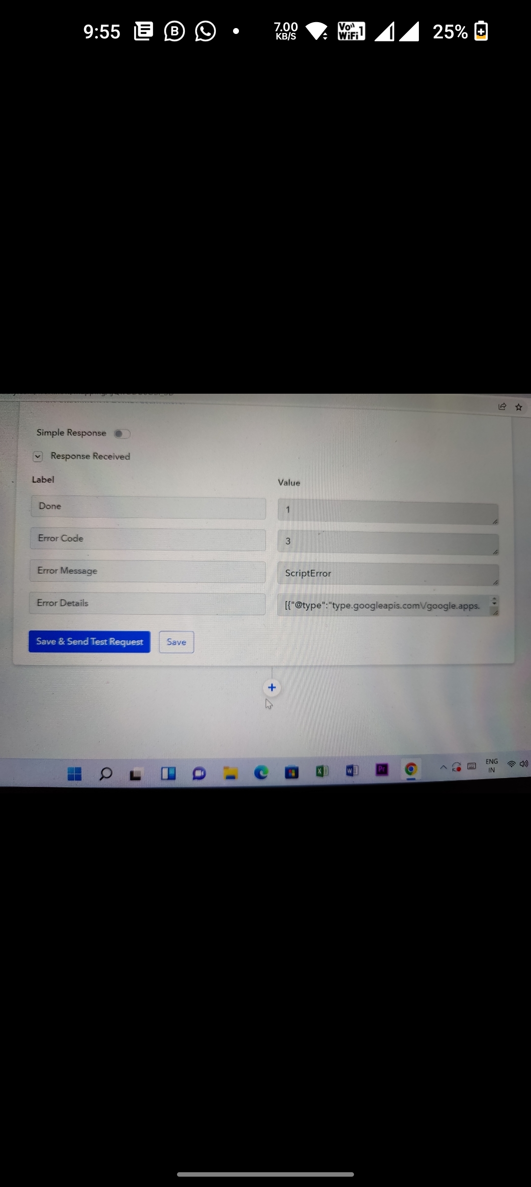

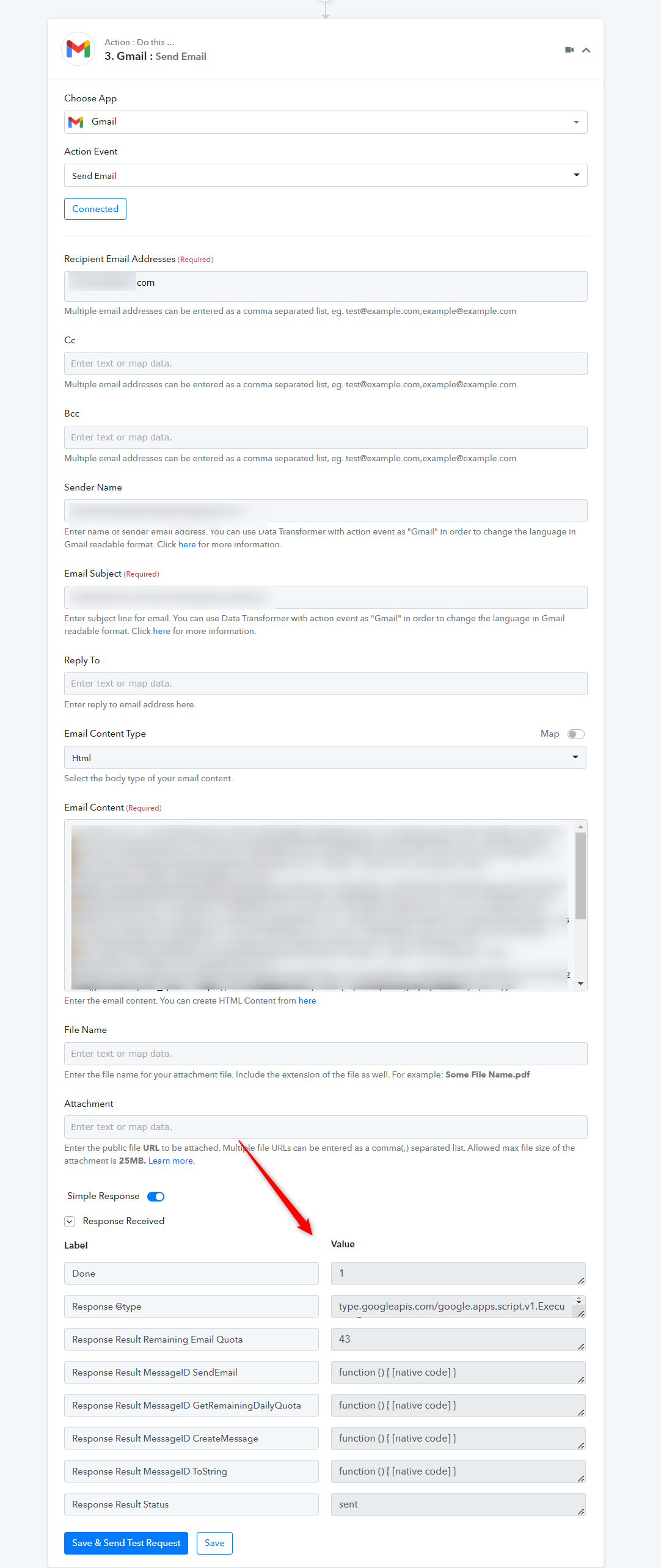

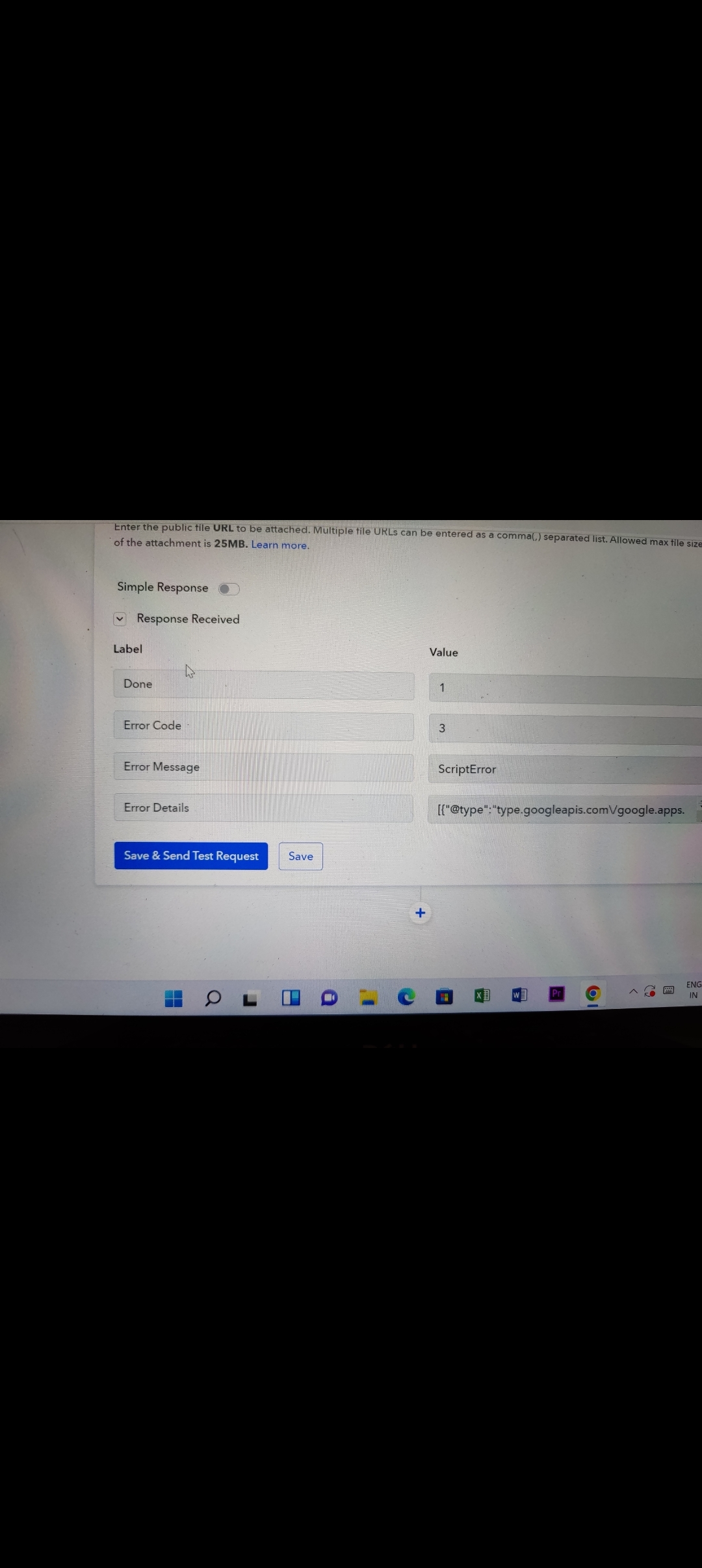

hii team , all my work flow have a finally action to send automated gmail email which have suddenly stopped working and i am not able to slove the same . please help me slove this. it is showing a similar kind of error which i am attaching on this thread.

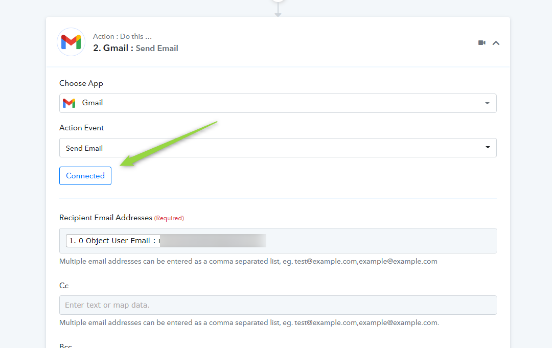

Hey @karan bafna
Seems like your Gmail accounts' authentication is failed, kindly try re-connecting the action step once and then attempt again.

Hey @karan Bafana
We have checked the same in your workflow and the Gmail action step is working fine.
Kindly re-authorize the Gmail action step once and try again.

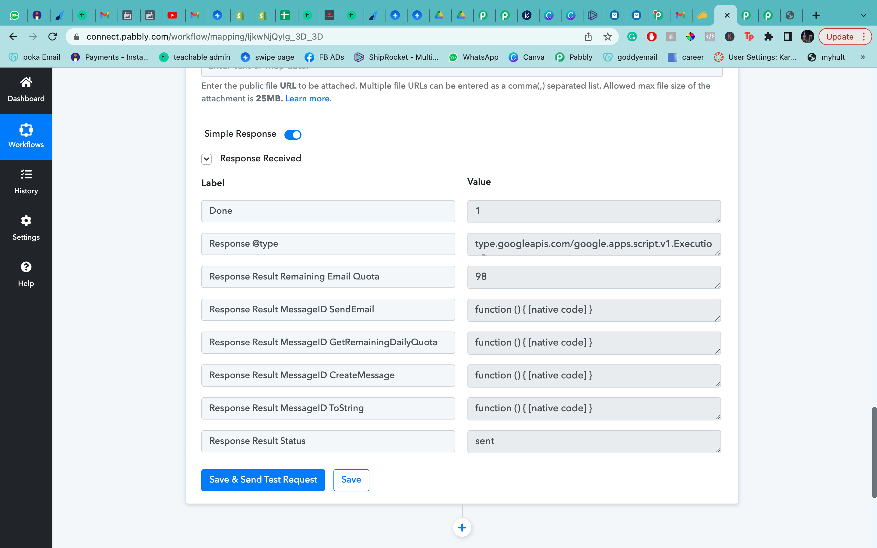

hey ,, i have removed and attached it again
but it works for sometime and then again it disconnects now it is showing eorror again .
karan bafna — Reply ·
again it worked for an hour last night and not again t has stopped !!!!! please fix this issue, hve been using pabby connect for over an year now , hadnt faced an issue like this before

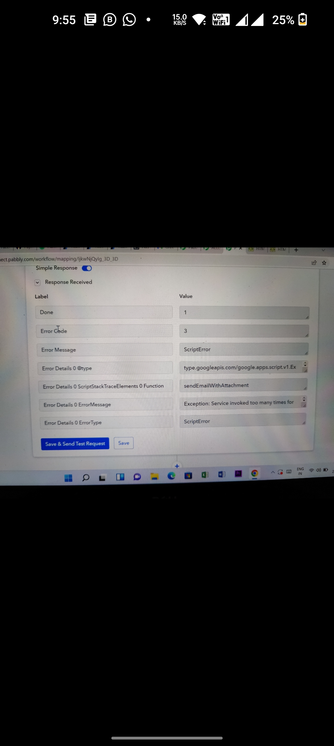

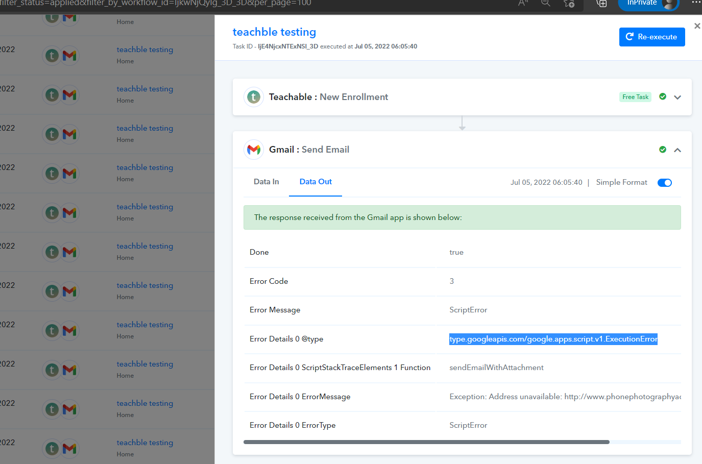

Hey @karan bafna
If you see the Data Out of Gmail.
You will see the error like this: Rate Limit Exceeded.
This error appears when you are sending messages beyond a certain limit.
You can check the same into the API documentation of Gmail for the same.

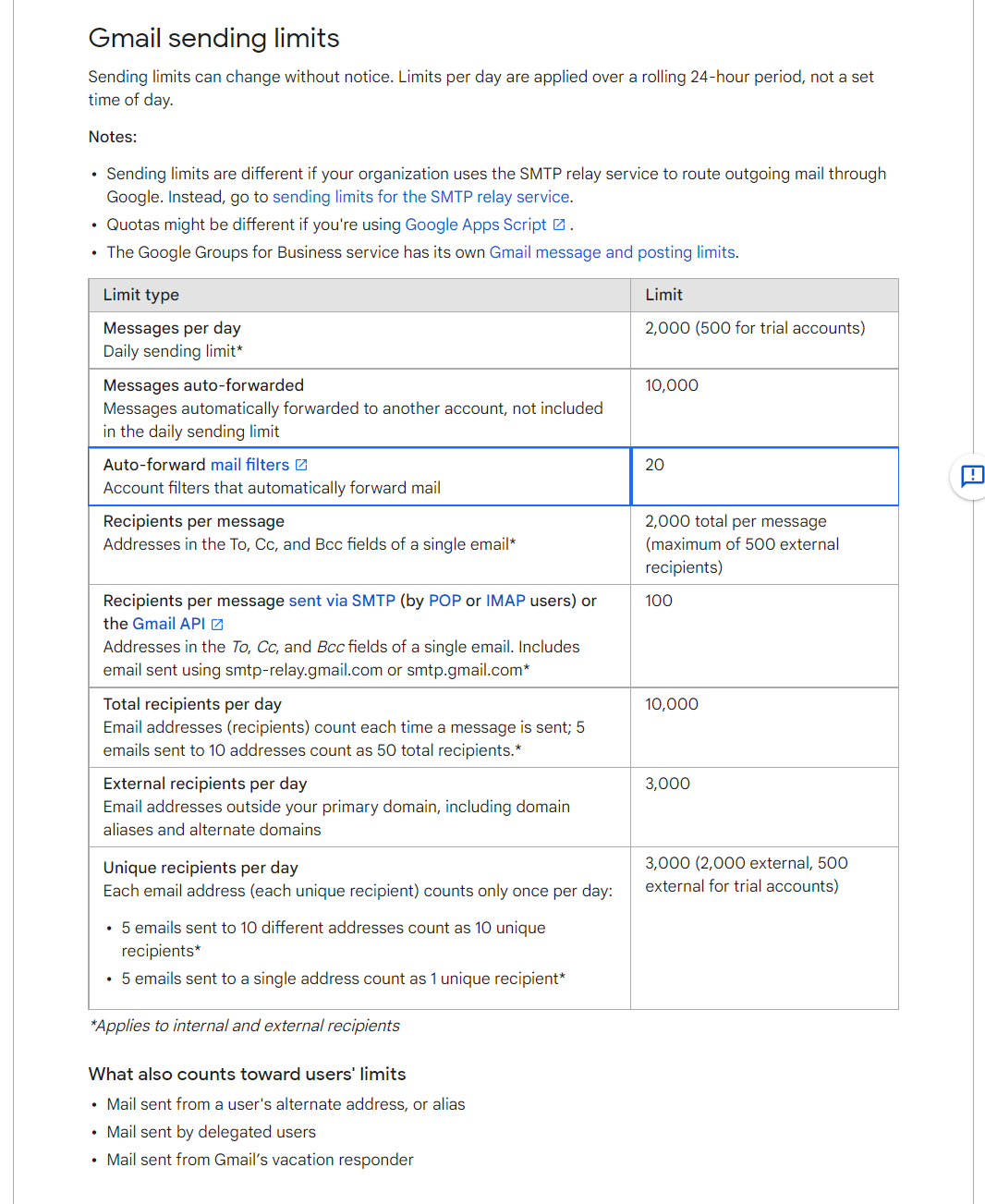

https://support.google.com/a/answer/166852?hl=en
We highly recommend users to use a professional SMTP service like SendGrid, MailGun, or Amazon SES that allows you to send emails in bulk without limits.
If you purchase an SMTP and use that instead of Gmail step. Your issue with Gmail limits will be resolved.
Further, you can also purchase a professional GSuite account where the limits are comparatively higher for sending emails.
