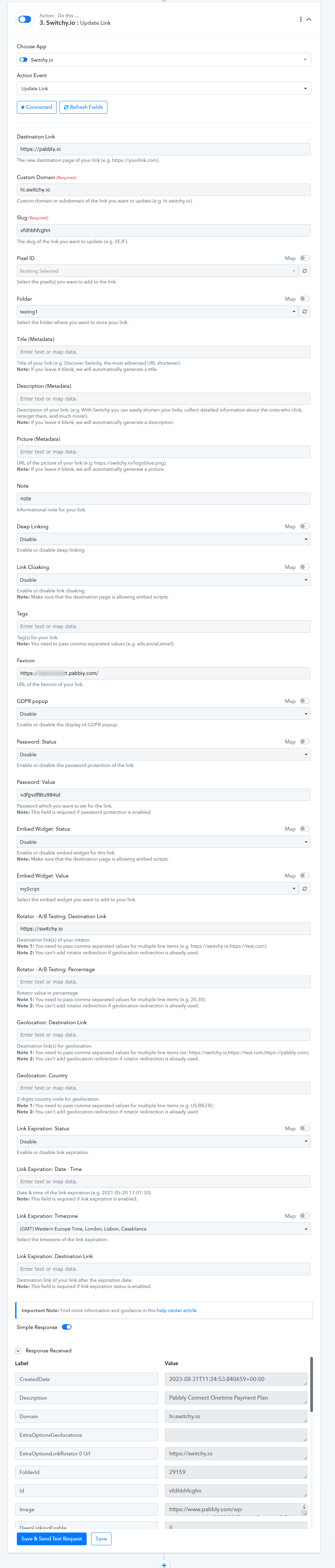

Hi, need help with update link in switchy (A/B percentage field)
Regardless of any figure I add it still returned this error "extraOptionsLinkRotator options sum can`t be more then 100"
Please advise.

So basically I want to change the weight distribution for the URLs that were already set in an existing slug.

Hi @ArshilAhmad & @Supreme here's the workflow as requested.
As I mentioned, I would like to update the weight distribution of the links set for the rotation, however this error occured
Please keep us posted on why this is not working. Thank you.

Hey @Nidzam,
We have diligently conducted testing on our end, and we are pleased to report the successful reception of the response, confirming the seamless functionality of the integration.
We kindly advise you to review the values you are inputting to ensure clarity and accuracy. To assist you further, we have thoughtfully included a screenshot for your reference.

Thank you for your reply @Nivesh but the screenshot of the test that you conducted did not include the problem that needs to be addressed to.
- Firstly, your AB Testing Link should contain more than 1 link for it to be AB Tested (yours only showed one).
- Secondly, your AB Percentage field was empty, therefore it is not really addressing to the problem in the first place.
I have checked again with the workflow that I provided, unfortunately it still fails.
I hope to hear an update from the team again with regards to this fix.
Thank you.

Hey @Nidzam,
We would like to bring a few points to your attention for your consideration:
We have tested with multiple links and got a satisfactory response. You can test it from your end as well.
-Secondly, your AB Percentage field was empty, therefore it is not really addressing the problem in the first place.
For the AB percentage field, you are required to put one decimal number between 1-9 e.g. 3,5 if you put 2 decimal numbers it will show the error. We have raised the concern to the team.
The integration itself is functioning correctly, and the issue appears to be stemming from the Switchy side. It would be greatly appreciated if you could also report this matter to the switchy team for their attention. To assist you further, we have provided a demonstration video for your reference.

Thank you @Nivesh for the update. Will proceed to report this matter to the switchy team for their attention.
Will update here again once I receive a reply from Switchy.
