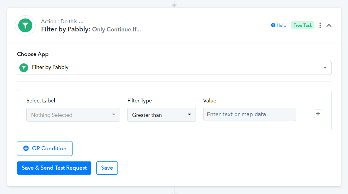

I would appreciate it if you could elaborate a bit more on this use case. As far as I understand, if you want to add contacts to Sendinblue based on their score, you can incorporate a Filter into your workflow. This will ensure that only profiles with a score above a certain threshold are added to your Sendinblue contact list.

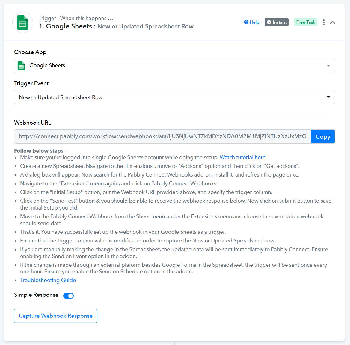

I also thought of going through notion or google sheet to make the filter but it doesn't seem to have instant triggering. Is it ?

The tricky part lies in determining the highest score. You will need to somehow update the trigger column in your Google Sheets with the highest score, and when the data in that column gets updated, we can then capture it using the Google Sheets: New or Updated Spreadsheet Row trigger event. But I am assuming even this won't work for you, as you will be using Tally as your trigger application.
Celine
yes the data is uploaded via Tally and then I added 2 columns that calculate the right profile, wich is done kind of mannualy (since it is a formula). Would that work ?
Doing the test it doesn't seem like it
ArshilAhmad
Moderator
Updating the trigger column using a formula will not trigger your workflow. You either have to manually enter data or use a 3rd party application.
