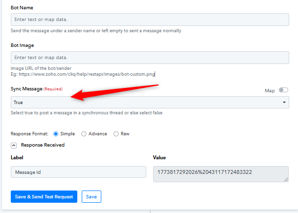

Hrishabh Tiwari — Reply ·
Hello @convogh ,
Thank you for your patience while we looked into this
The issue was occurring because the Zoho Cliq API was being called in async mode, due to which it returned a 204 (No Content) response. In this mode, the API does not send back the message ID, which is required to create or track threads.
What we changed:
We updated the sync_message field to: True
Result:
  • The API now runs in synchronous mode
  • It returns the message_id in the response
  • This message ID can now be used to:
    • Create a thread
    • Capture the thread reference for your CRM
You can now proceed with using the message_id for your thread-related use case.

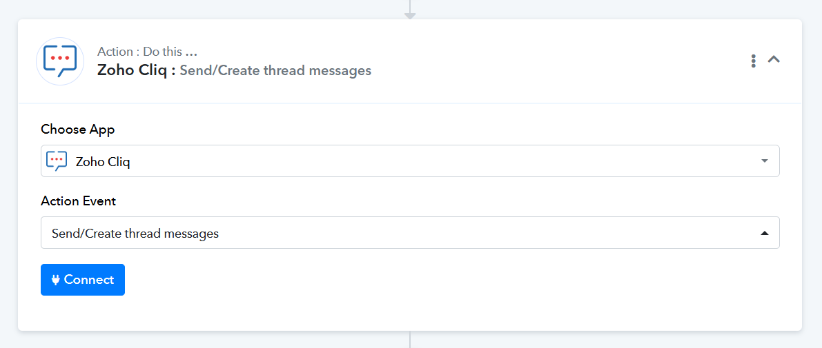

thanks. so what would be the following action to target the message? there's to action that allows me to to target the specific message using the message ID.
convogh — Reply ·
yes please add it. we are currently creating threads manually and this would be very helpful.
We have forwarded your request to add the "Create/Send Thread Messages" endpoint to the Zoho Cliq application in Pabbly Connect. Please allow us some time to look into this concern. We will get back to you with an update soon.
Arshil Ahmad
?Rate your support
Our team has added the "Zoho Cliq: Send/Create Thread Messages" action step to Pabbly Connect. You can test it at your end.
Arshil Ahmad
?Rate your support
