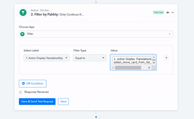

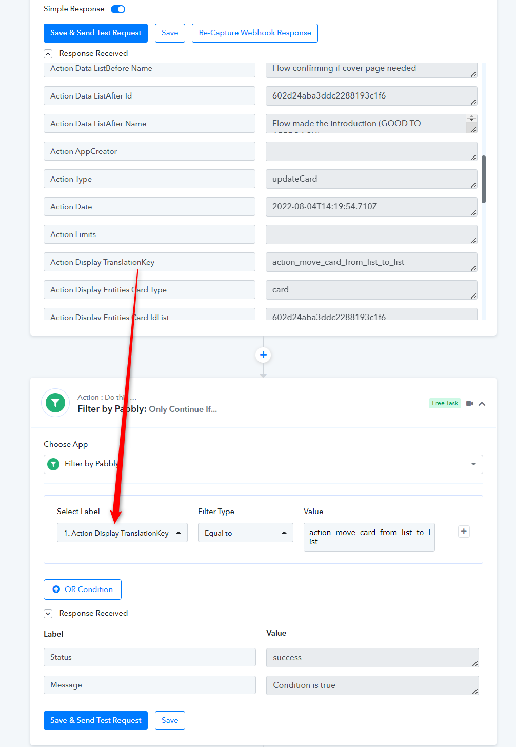

Hey @THATBranding
In the filter action step, you were supposed to manually type the transitional key instead of mapping it.
Kindly try again!!

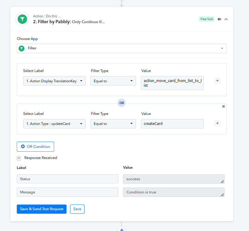

@Supreme Does it not make sense that "action_move_card_from_list_to_list" would encompass moving a card OFF a list as well as ON to a list? It is literally moving from one list to another, just as the filter says. So how do you add a rule that says "only when the destination list is X", where X is a list I specify?

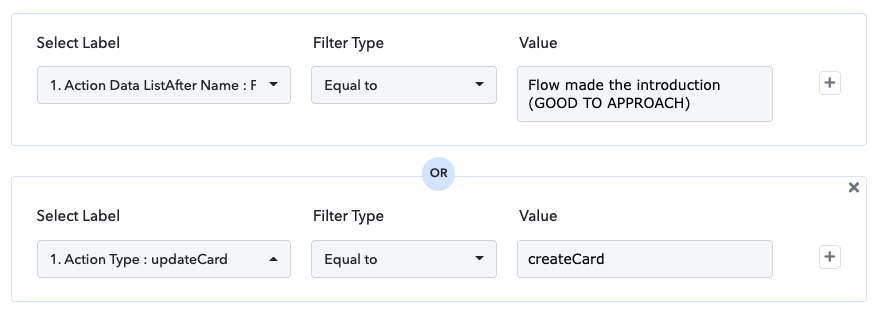

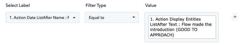

Would it work if I did this:
Because that should exclude where the card was moved to a list that wasn't "GOOD TO APPROACH"?
I am going to test it...
THATBranding — Reply ·
I think I just solved it @Supreme .
In this scenario, it will only create tasks in ClickUp if the trigger was to move a card specifically to the "GOOD TO APPROACH" pile (not just moved between any lists) OR if the card was created on the list. It ignores card updates because they are neither moving cards nor creating cards.
Does this logic seem sound to you? I haven't realised this was how it worked.
