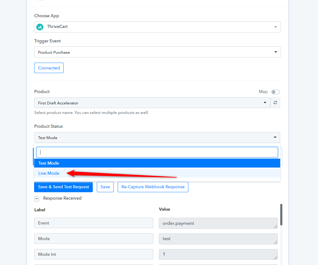

You can first refer to our tutorial video for a better understanding. Further please capture the Thrivecart's response in Live Mode.

We looked into your workflow and it seems like you haven't captured the Thrivecarts' webhook response properly. Kindly try capturing the data in Live mode and by paying the amount on the payment gateway.

Kindly try re-capturing the webhook response in Live mode by making a real payment.
