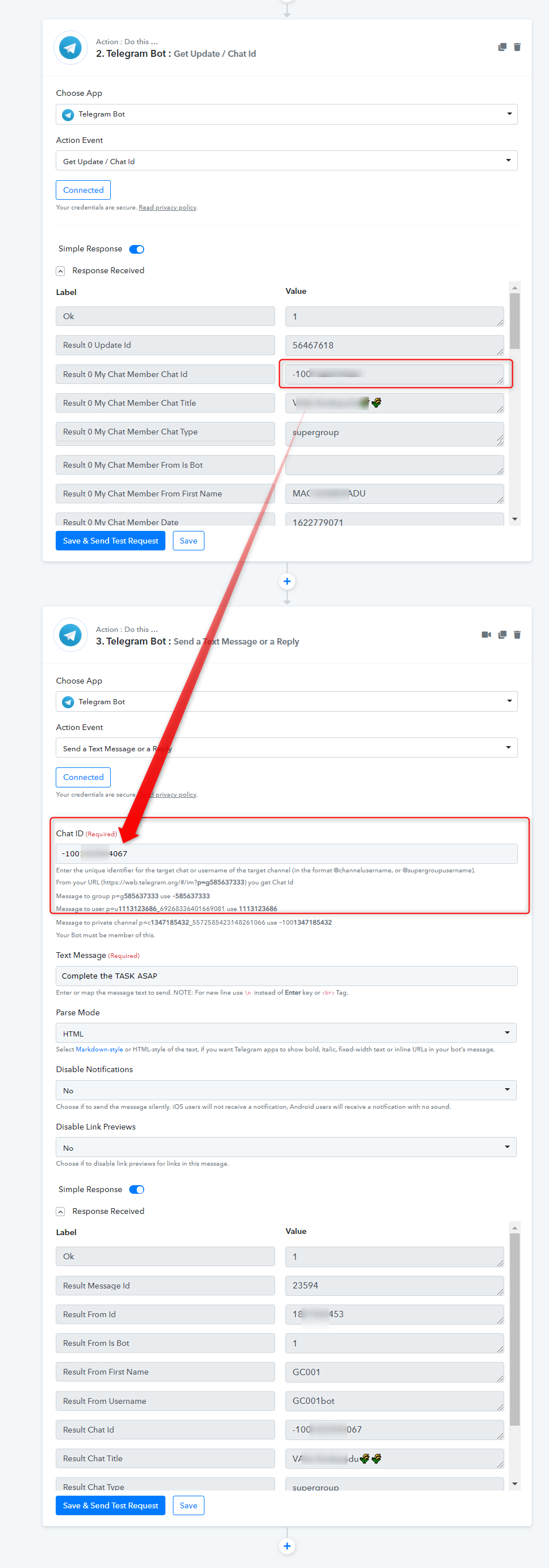

Hey @TelegramConnect
We checked your workflow, in Telegram's "Send Text Message or Reply" Action you need to fill in the Chat ID of your group/a person.
Which you can retrieve with the help of Telegram's "Get Update/Chat ID" Action Event. Please check this in your workflow.

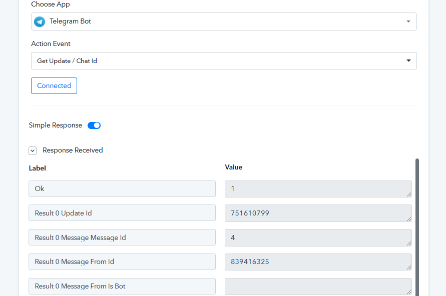

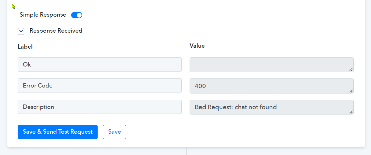

@Supreme I followed the steps but still I'm getting Error code 400 - Bad Request: chat not found.
When I use 'Get Update/Chat Id', I simply see response as OK however I found my user chat ID by another way but somehow it does not work.

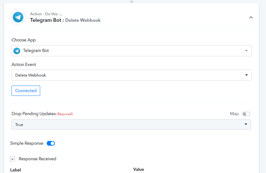

We've checked the above action and it's working fine with our Chat Bot.
May be you missed something, Have you configured Triggers of telegram bot if so then, the Get Update/Chat Id may not work, you need to delete the webhook using the below action:
then send some message to the bot and test the Get Update/Chat Id action. It should work.
