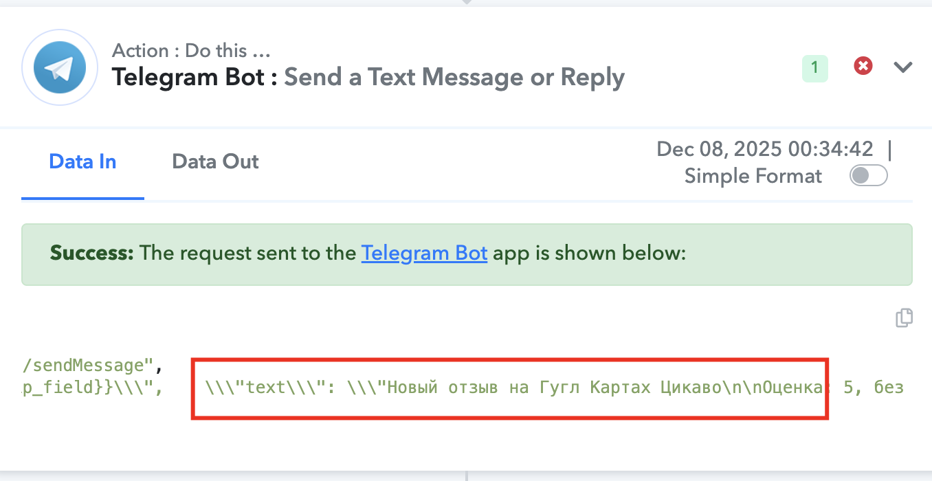

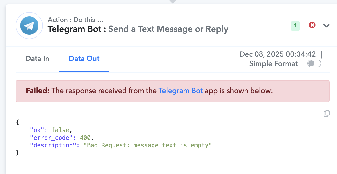

I have an error in the "Semd message to Telegram" node:
"ok": false,
"error_code": 400,
"description": "Bad Request: message text is empty"
But Data In isn't empty:
Is it a Pabbly bug?
Or I did something wrong?
This node worked earlier, I didn't make any changes.

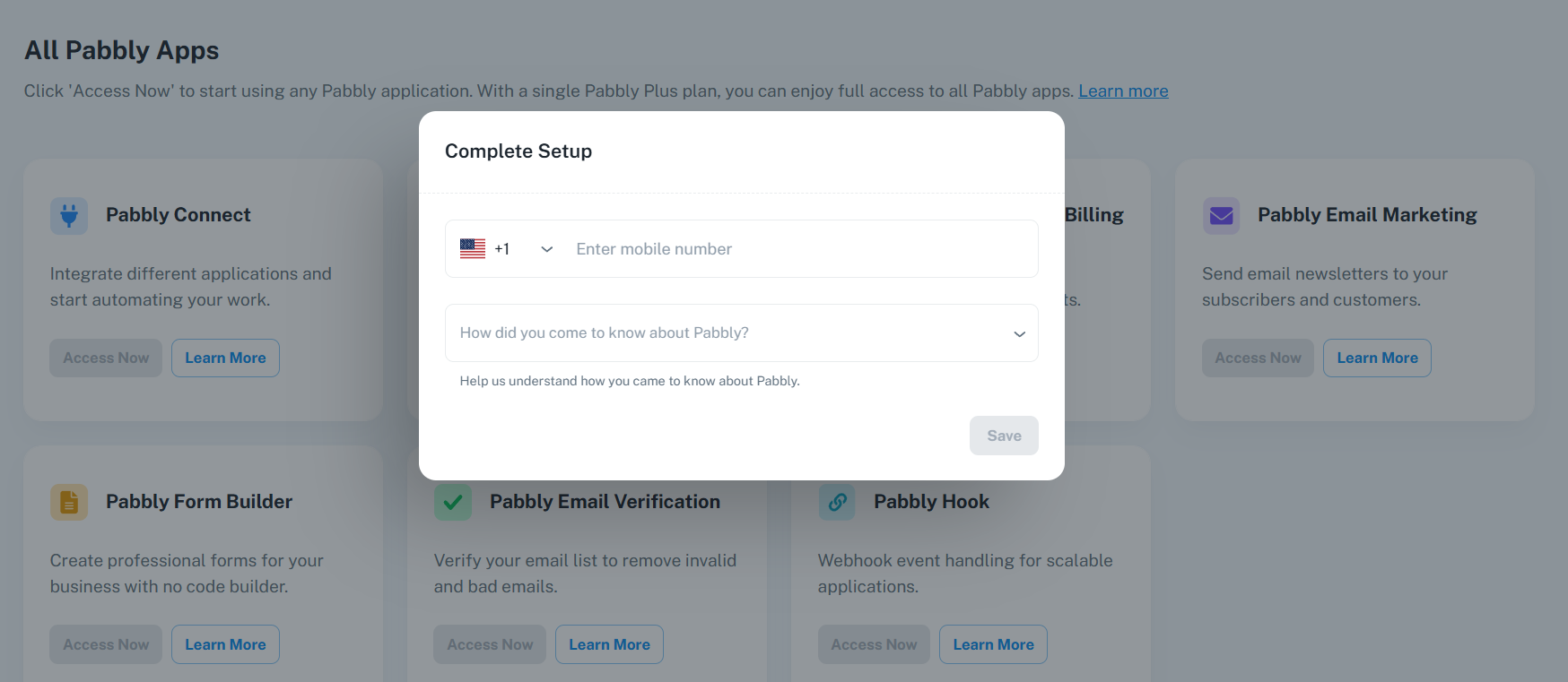

Hello @Igurok,
After checking your account, we found that you have not completed the setup of your Pabbly account yet.
Please complete the setup and then let us know, so we can check your workflow accordingly.

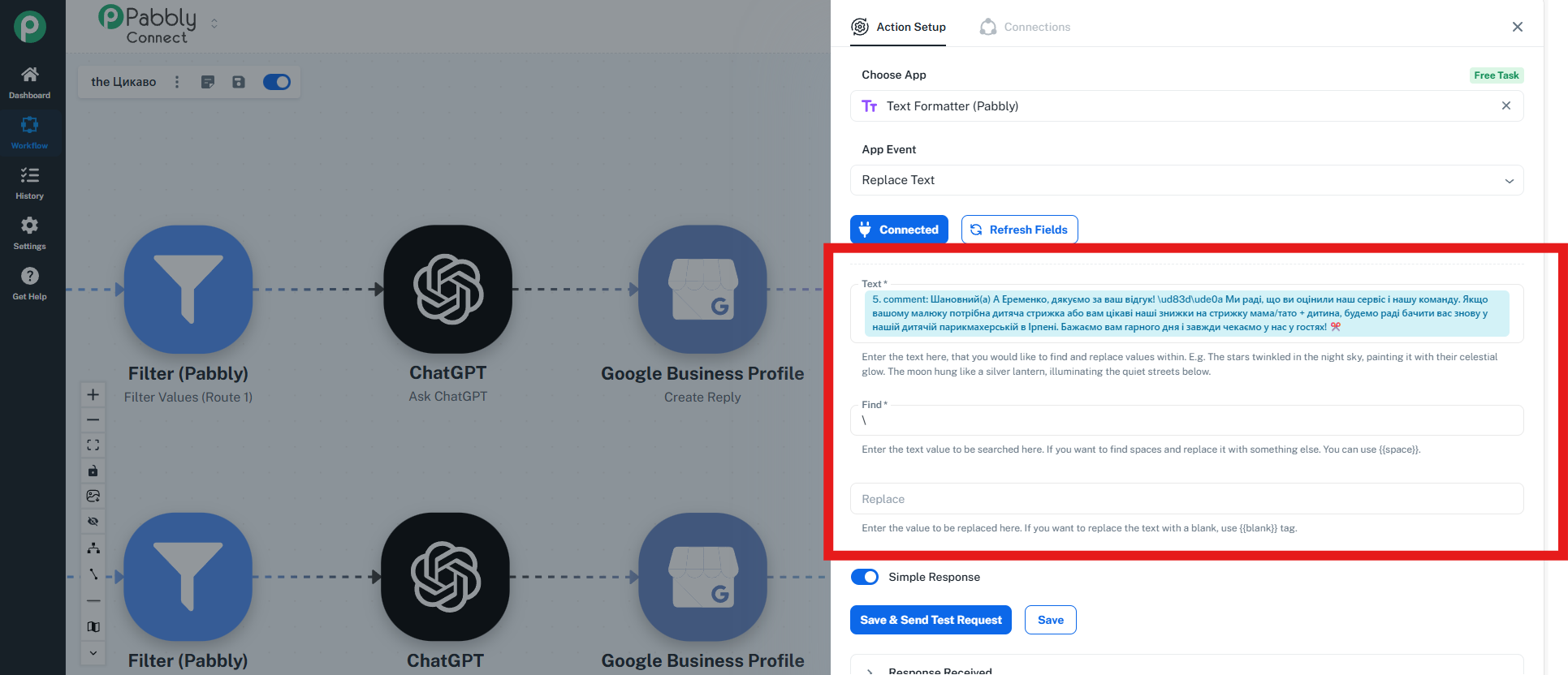

Hello @Igurok,
After reviewing your workflow, we found that the message content you are passing in the Telegram action step has an issue with the ''\" character. Please modify your Google Business Profile response by adding a Text Formatter step where you replace all the "\" characters with a blank space " ".
Then, map this formatted response in the Telegram step. This should resolve the issue.
Kindly apply these changes in your workflow and let us know if you need any further assistance.
