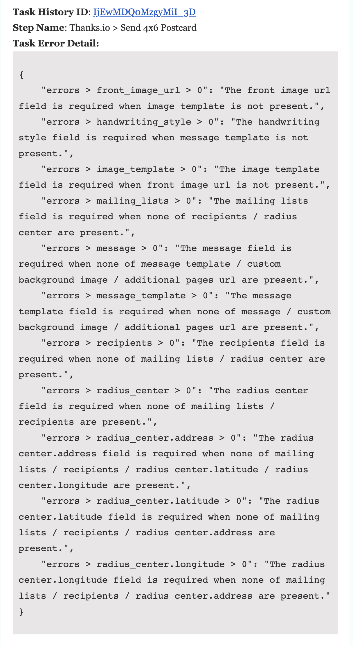

I went to send a postcard from a template in Thanks.io.
Then I got this message from Pabbly that it didn't execute due to an error (see attached files).
The problem is that I used a template in Thanks.io and it's telling me that I need to upload a front image if a template isn't present.
... The template is present so I don't know why I am getting an error to upload a front image.
Please advise.

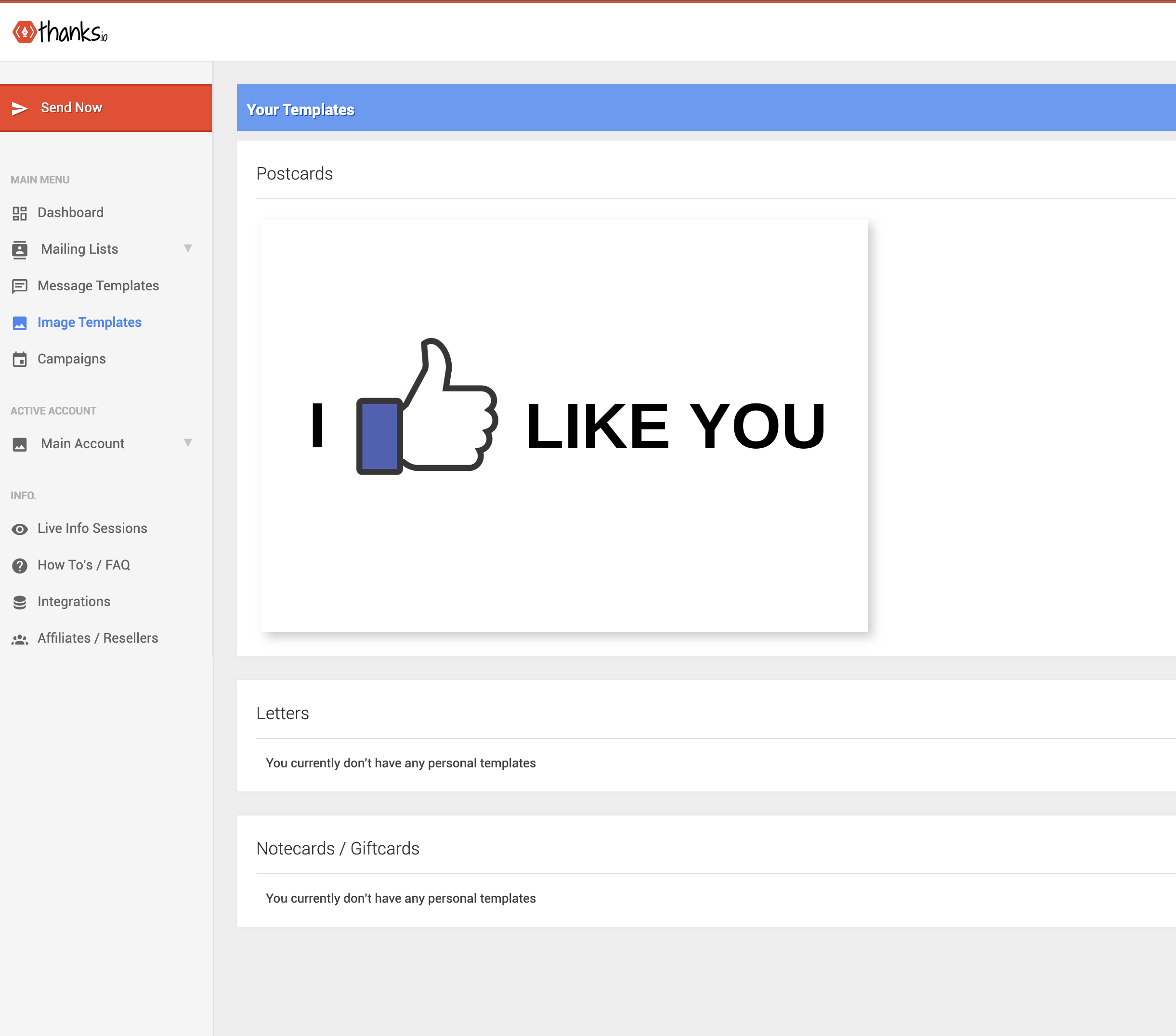

System 810 — Reply ·
Thanks. Yes there is a picture present in my template (see image attached).

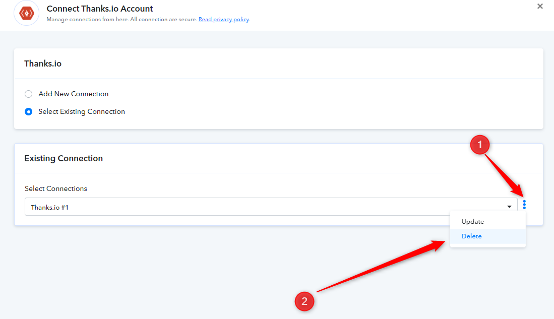

Also, how do I delete my old Thanks.io integration from Pabbly?
Hey @System 810
You can delete the old/unused API credentials in your "Existing Connection" section of your action step.
